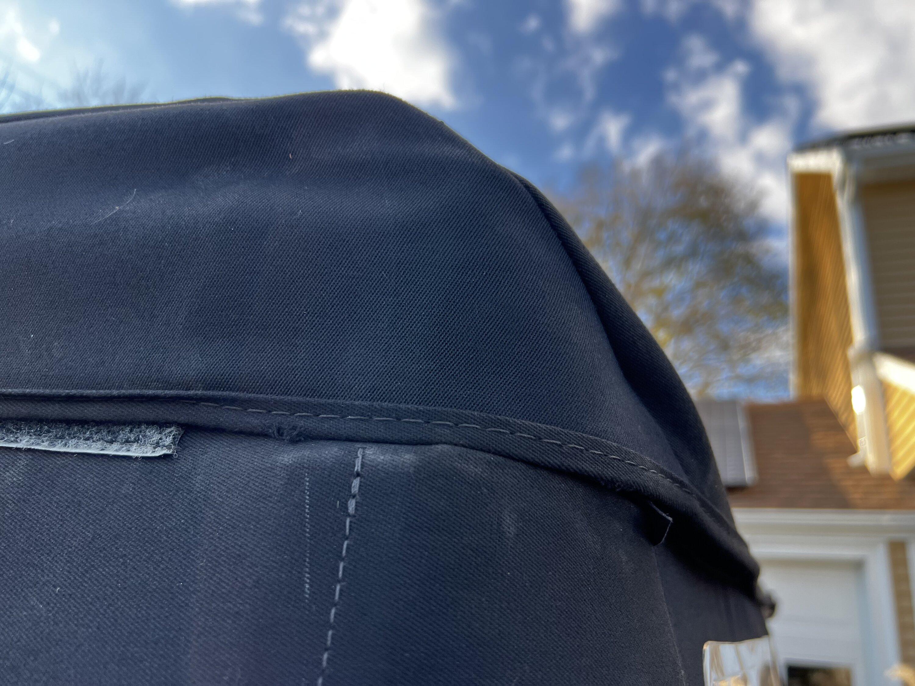

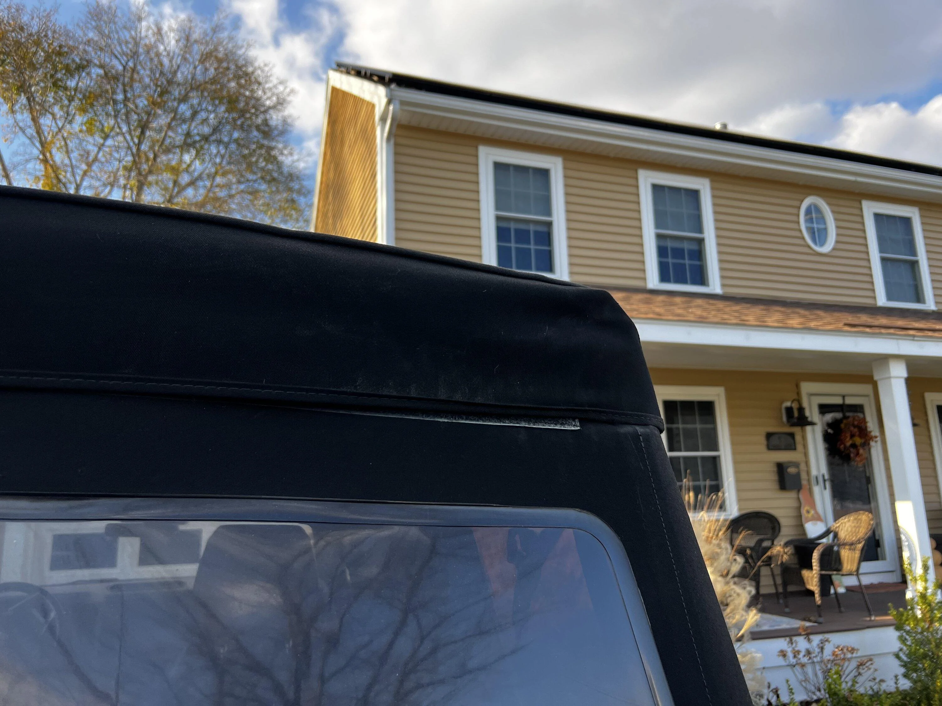

I have the same issue where the top seems loose and the velcro is showing on the back window. There is definitely more wind noise coming from above the rear door windows.
I finally had dealer put effort into talking to Ford about it. The shop I originally had the Bronco serviced at gave me the "yeah, seeing a lot of that..."
The new dealer had an external soft top guy take a look at it to see if it can be adjusted, or if it is a frame issue.
The dealer is now waiting to hear back from Ford to see if they can recommend adjustments or a replacement of the top.

My local dealer sent my Bronco to a Top and Upholstery shop.
They had to make tweaks to the frame, which made a small difference. The dealer then ordered a new top canvas which the Upholstery shops put on and made addition adjustments to finally get it right.

I just had the fabric of mine replaced. One of the issues was the Velcro being exposed on both sides and was getting brittle from the sun. I was really hoping they would have replaced it all, frame included. The Velcro was barely covered when I picked it up and it's starting to stick out a bit regardless how much I pull it in place.
I also had issues with the cable tension after picking up. The cable ends don't seem to stay in place securely and one popped out.
