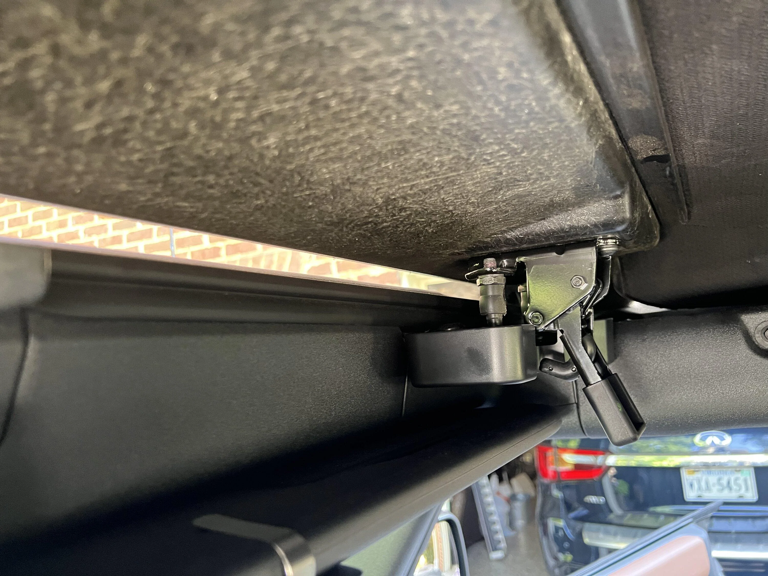

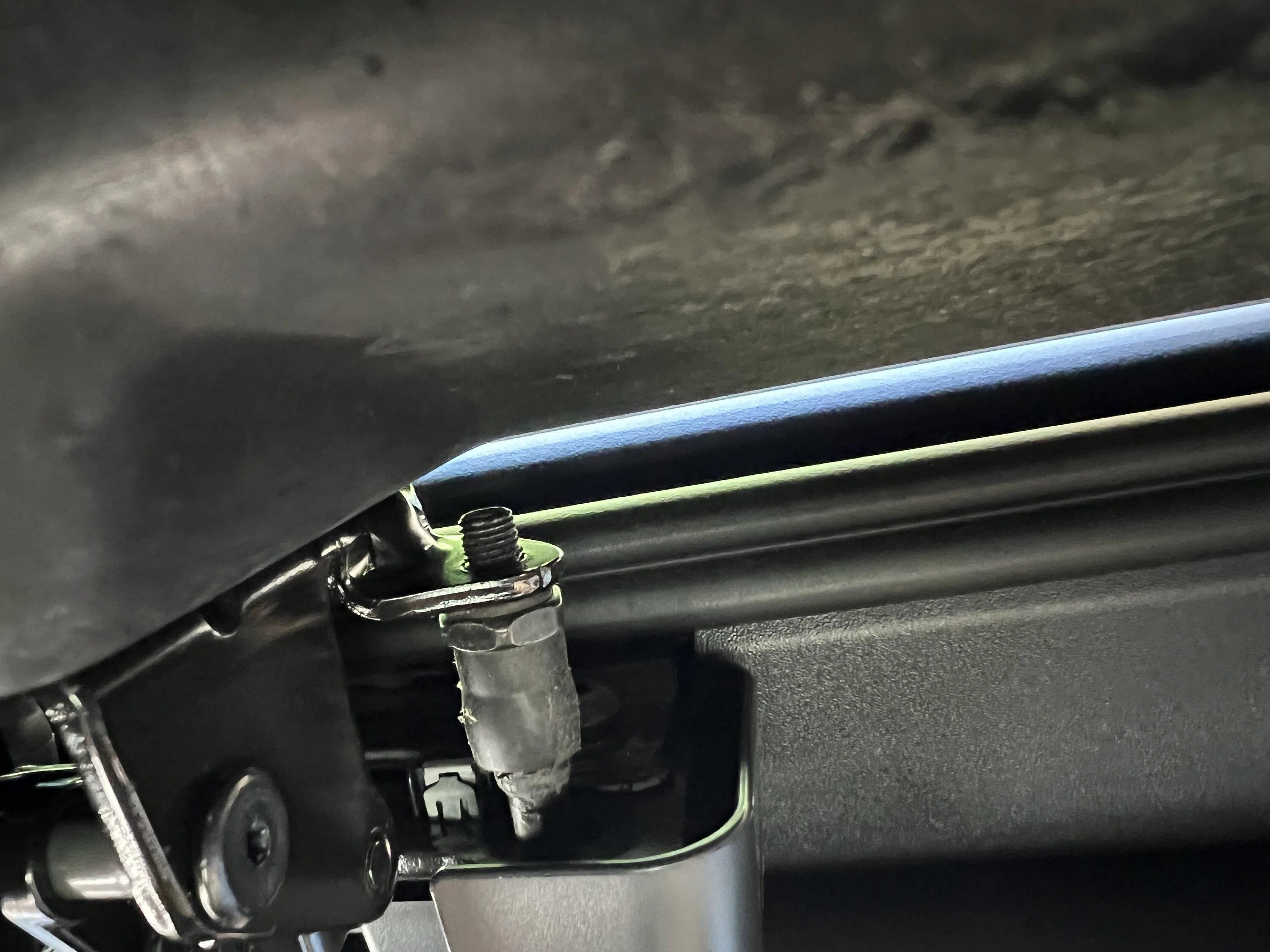

Iā€™m having the same problem. First the middle latch wouldnā€™t catch and now I canā€™t latch the front at all. Is there any adjustments I can do or is this a dealer fix? I am NOT handy.
are they trying to say you cant move the soft top back one position alone??? That would be moronic.

That middle latch (over the B-pillar area) can be a PITA. I find I need to "drop" the soft top frame from a couple inches up, and this force alone will ensure it catches properly.

When I first got mine it would do like your picture but only when. The mid latches above the rear doors werenā€™t latched. So now I double check and try to lift back up to make sure they are latched.

Took mine into the dealer this morning. They said the soft top frame is bent and they're ordered a replacement. Supposedly frames will be off backorder next week and shipped to the dealer. I told him about the forum posts and that others are having the problem and resolving by adjusting the latch plates - but he stuck with the bent frame as the problem.
yeah so mine did not adjust the latch plates. He just, well, bent them back and stated to switch off the side I use when opening with one person.
