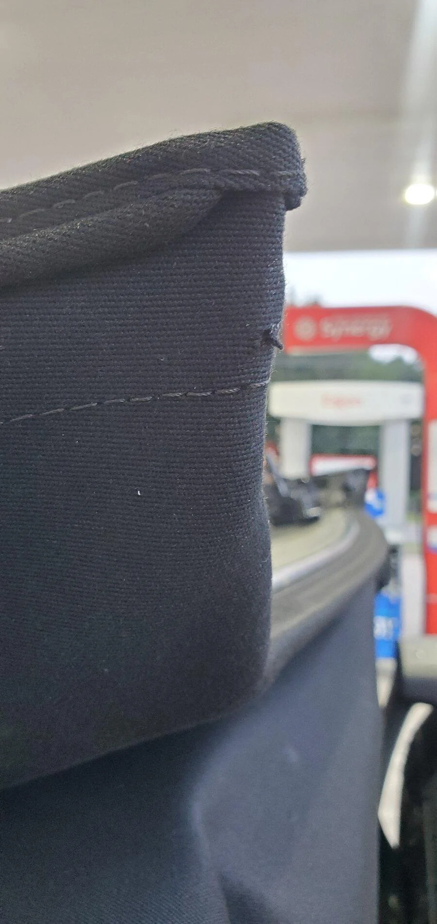

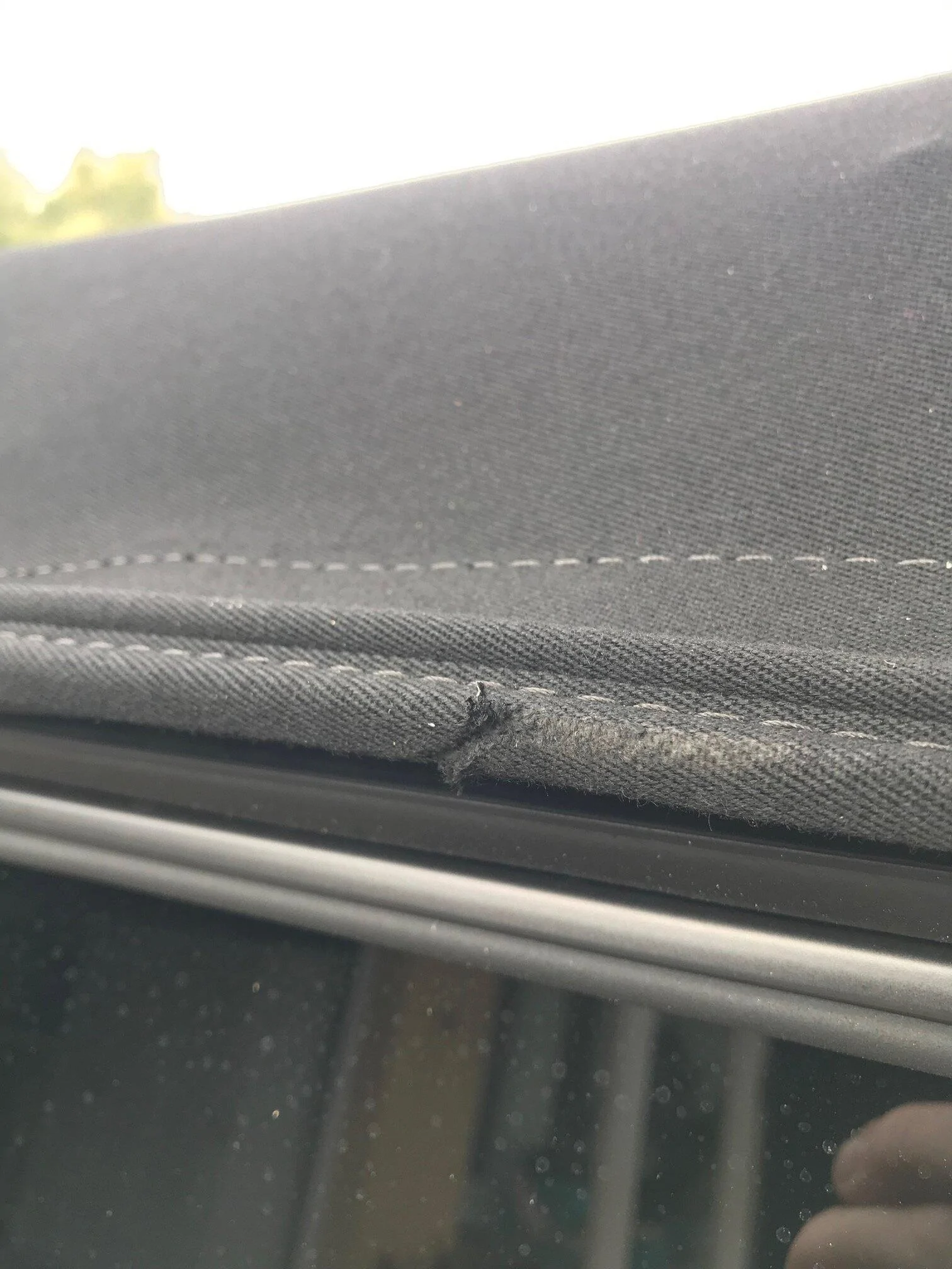

I wouldn't call that a fray, it's definitely a snag of some sort. Whether or not op caused it, I dunno, it could have happened at the factory. Check your shit extremely thoroughly at delivery, people!

I don't think so, only road driving so far. Definitely a possibility though. Tops been rolled back unless it rains.
May want to investigate where the top lays when rolled back and the range of movement when driving. It may be bouncing down and hitting something?

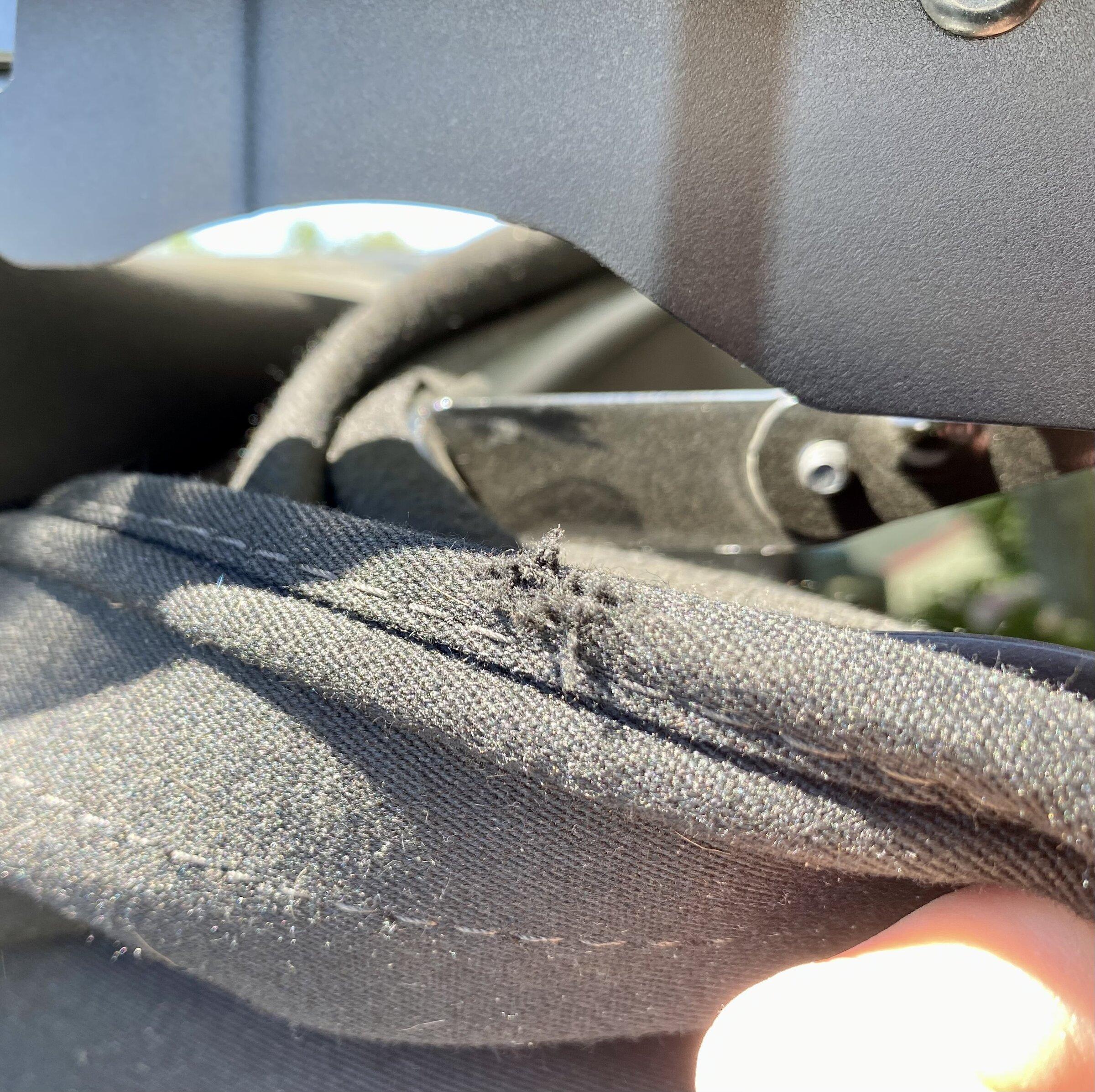

Wanted to share something I noticed yesterday too see if others are seeing it and if there are any causes or solutions. The front driver side of the soft top has a small fray starting. It started 5 days after getting the bronco. The fray is at the terminal end of the support frame. The support frame does not feel or appear sharp. Thoughts?

I’d hit that with a lighter first to melt down that material sticking out. That should keep it from getting worse. A dab of gorilla glue on top of that should protect it. It is still be pissed off.

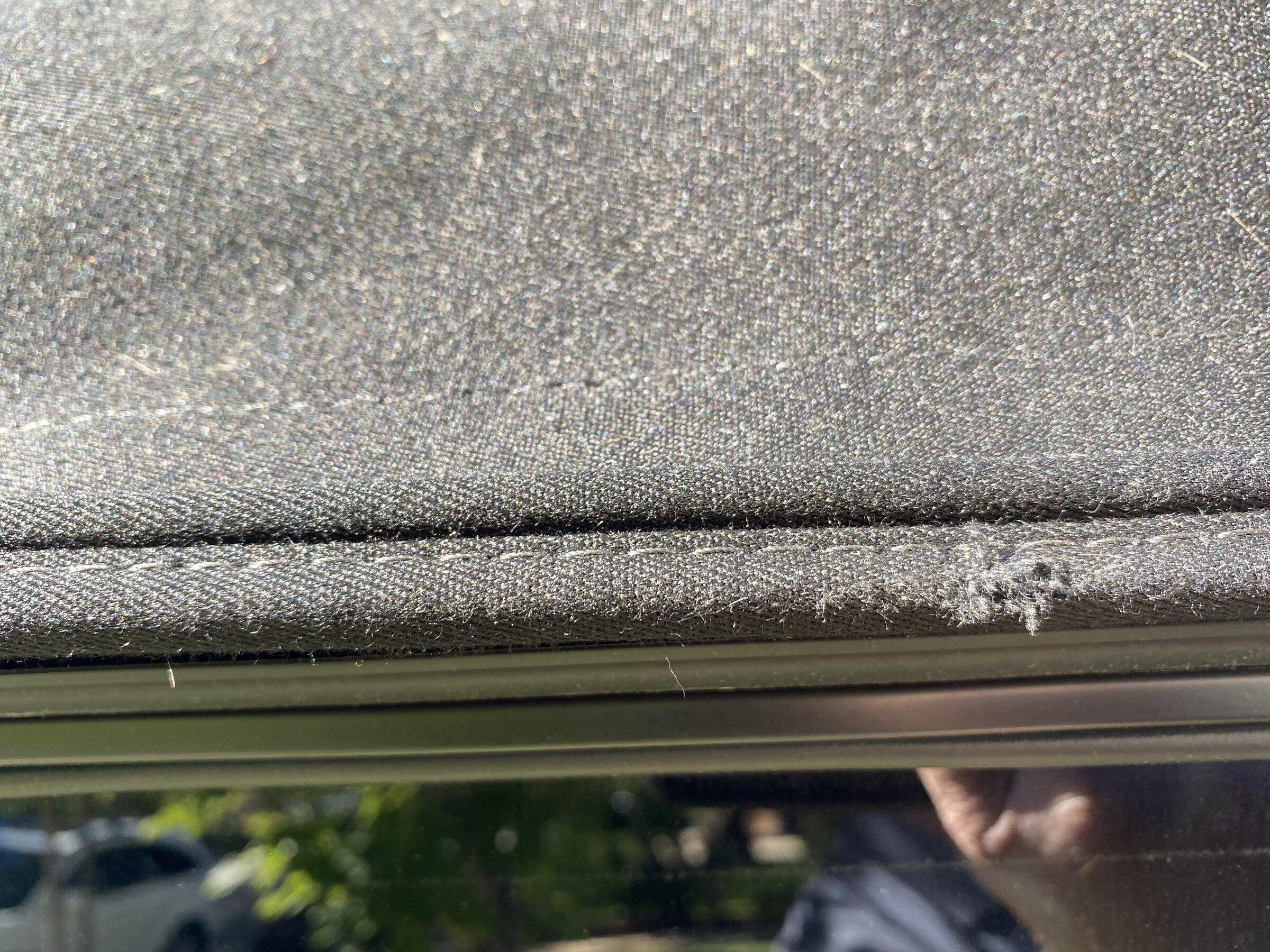

It is on the driver side where the top gets operated from. It seems to be from taking the soft top from 'rolled back' to fully down, and vice versa. Could be avoided by lowering the top cautiously or with two people. I saw another post saying to lay felt tape on the area.

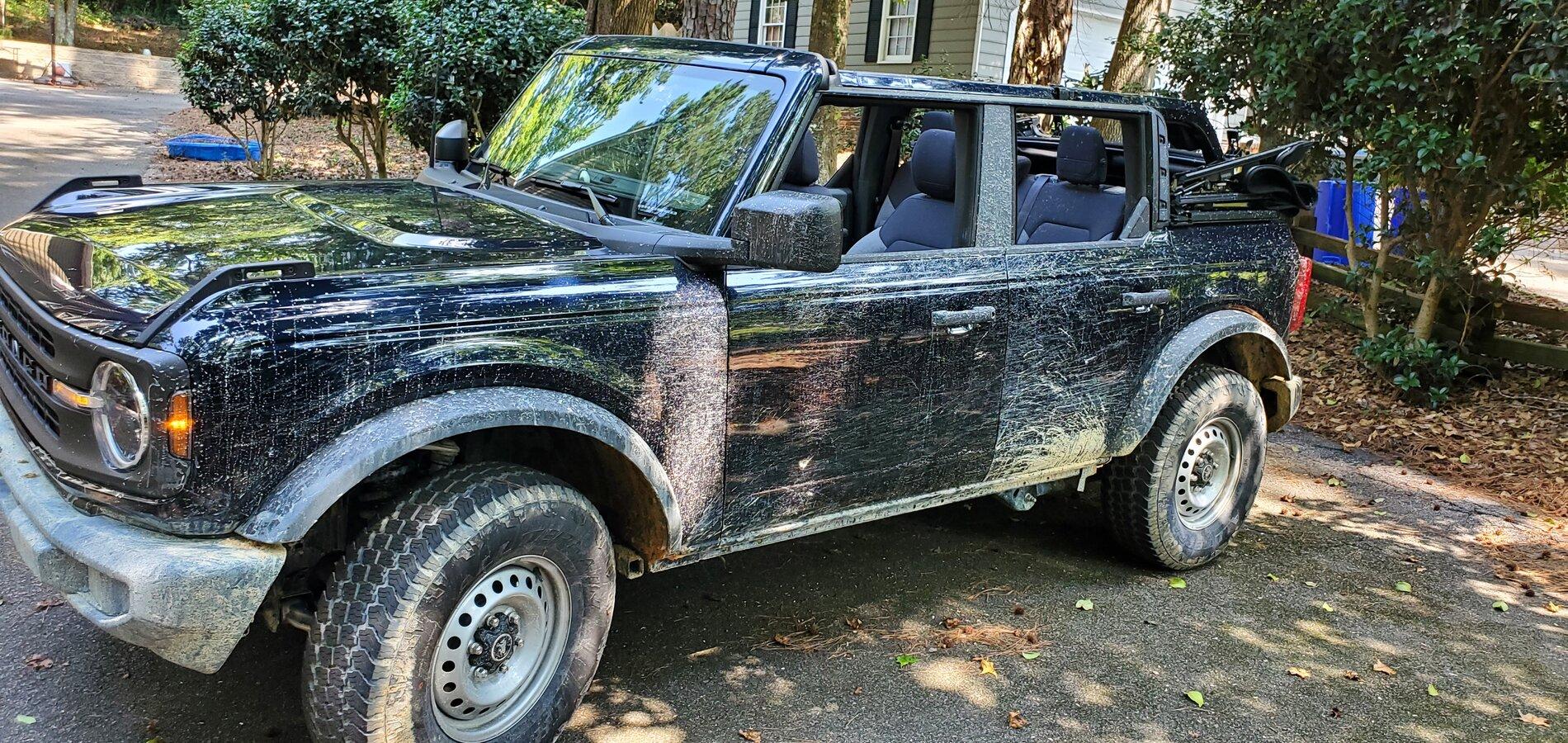

The fray could be from a 'snag' but didn't take her off road until today. The place that it is occurring makes me think it is a fray from the inside out due to the frame. I did get a contact for Ford and I will be sending in more pictures and description so that they are aware and can track the issue. Maybe they'll see a trend, maybe it is just a snag.

It almost looks like a cat got to it. I could be wrong. If that's the case then it's going to happen again

My immediate concern was that the support frame was rubbing through the fabric. Doesn't appear to be the case but hard to tell. I'll keep my eye on it and update. Wanted to inform other soft toppers and develop a quick solution for people to use. Getting a bottle of gorilla glue tonight.

The top corner? Looks normal to me.
When opening/closing the top look at anything that could be hitting that section at an point of the movement.

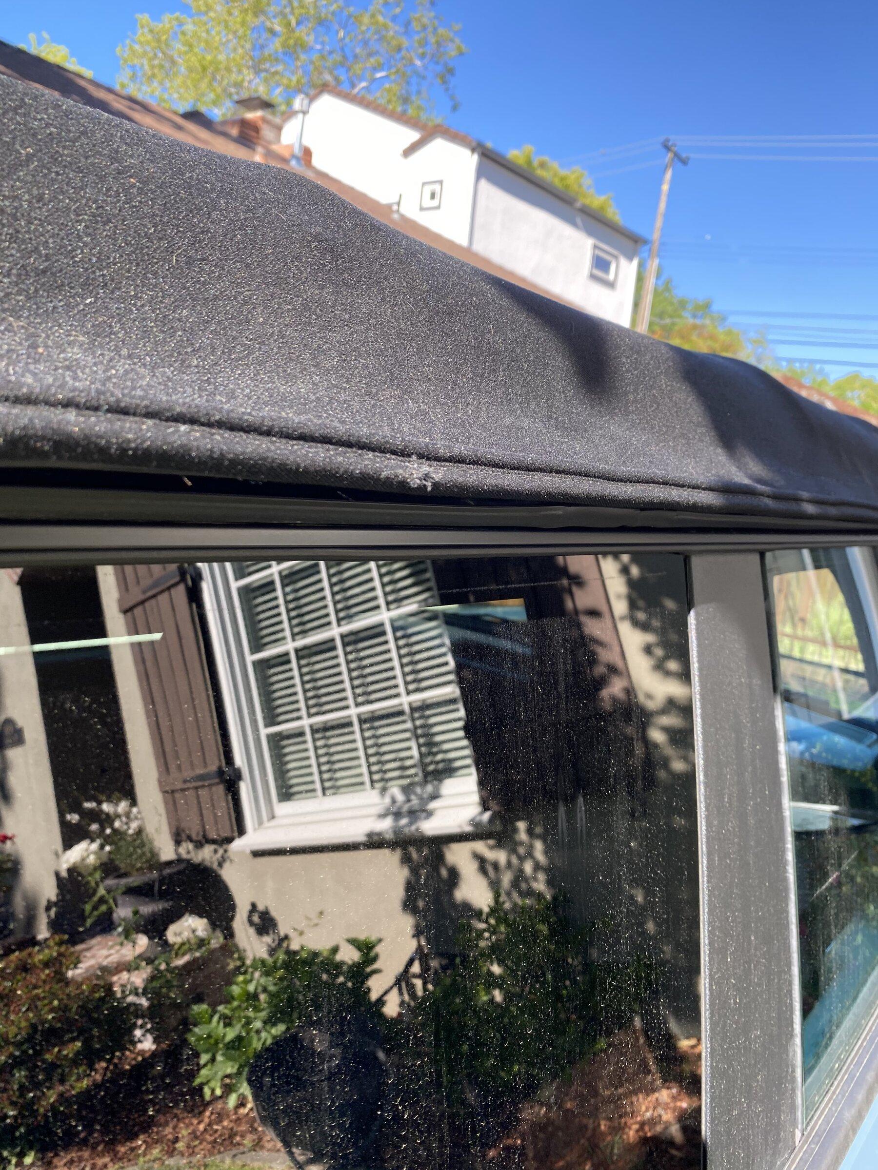

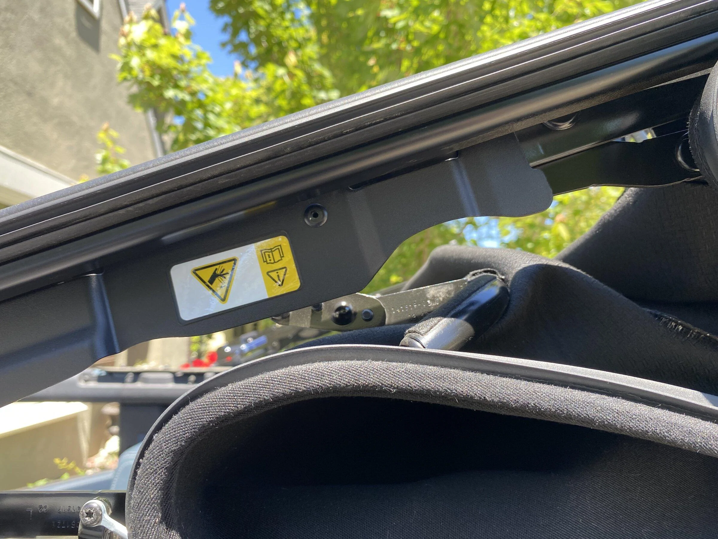

I have a similar fraying spot about halfway down the-passenger’s side of the top.
Ford Bronco Soft top fraying 1652300567958
Ford Bronco Soft top fraying 1652300591869

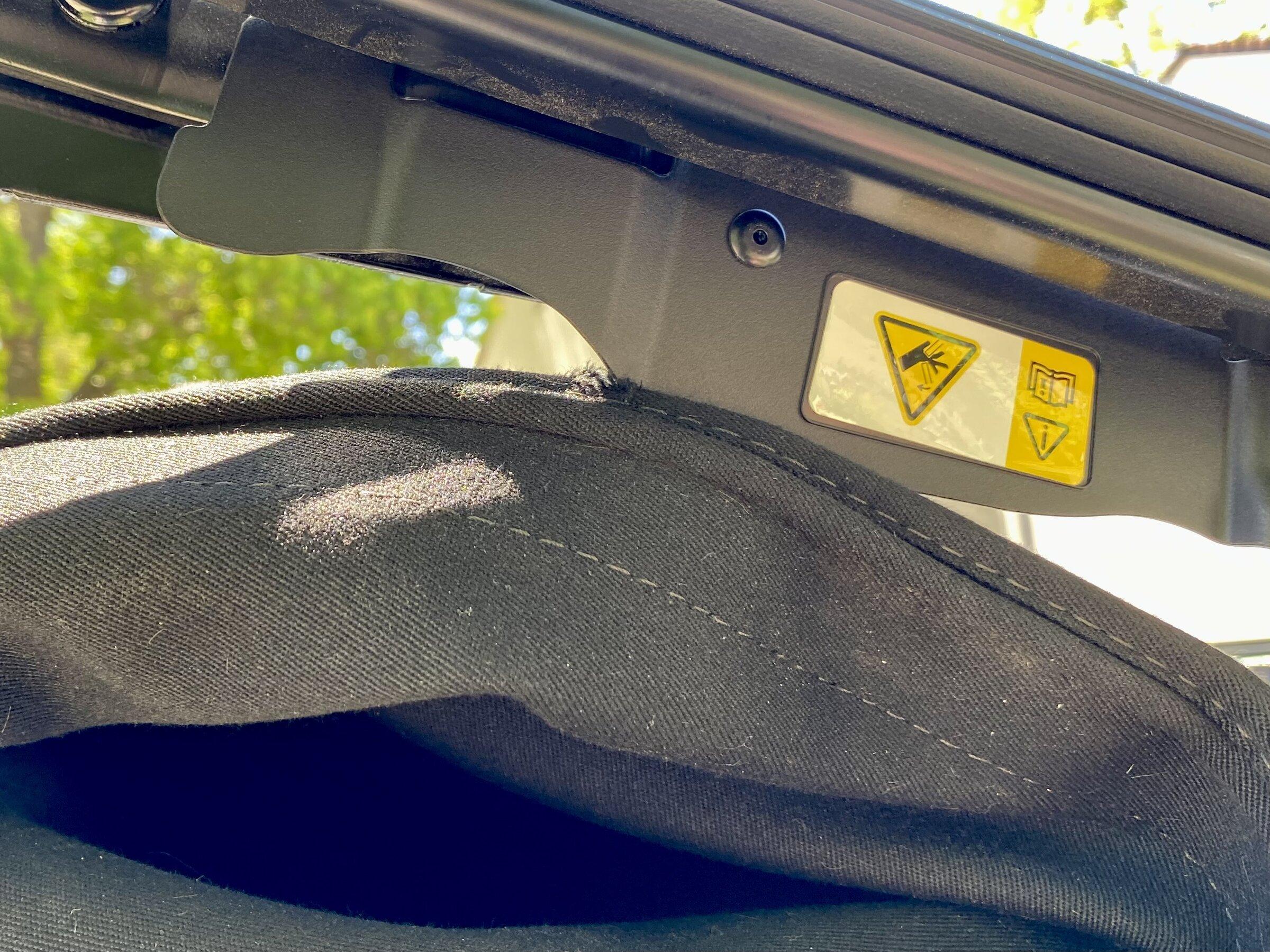

After some thinking about what I may have hit to gray the top, I took it through the process of putting the top down. When I had it flipped back I noticed something different between how/where the top folded on the passenger’s side versus the drivers side:
Passenger:
Ford Bronco Soft top fraying 1652300716072
Driver:
Ford Bronco Soft top fraying 1652300759519
On the r passenger side the top is rubbing on the plastic piece that warns you not to pitch your finger and has, clearly started tearing the top. It looks like you might be able to remove the plastic piece, but I want to leave it as is until I talk with Ford and show them the issue.
Ford Bronco Soft top fraying 1652300882299
I’m guessing your top might be rubbing some other random part of the rig and creating a similar issue.
