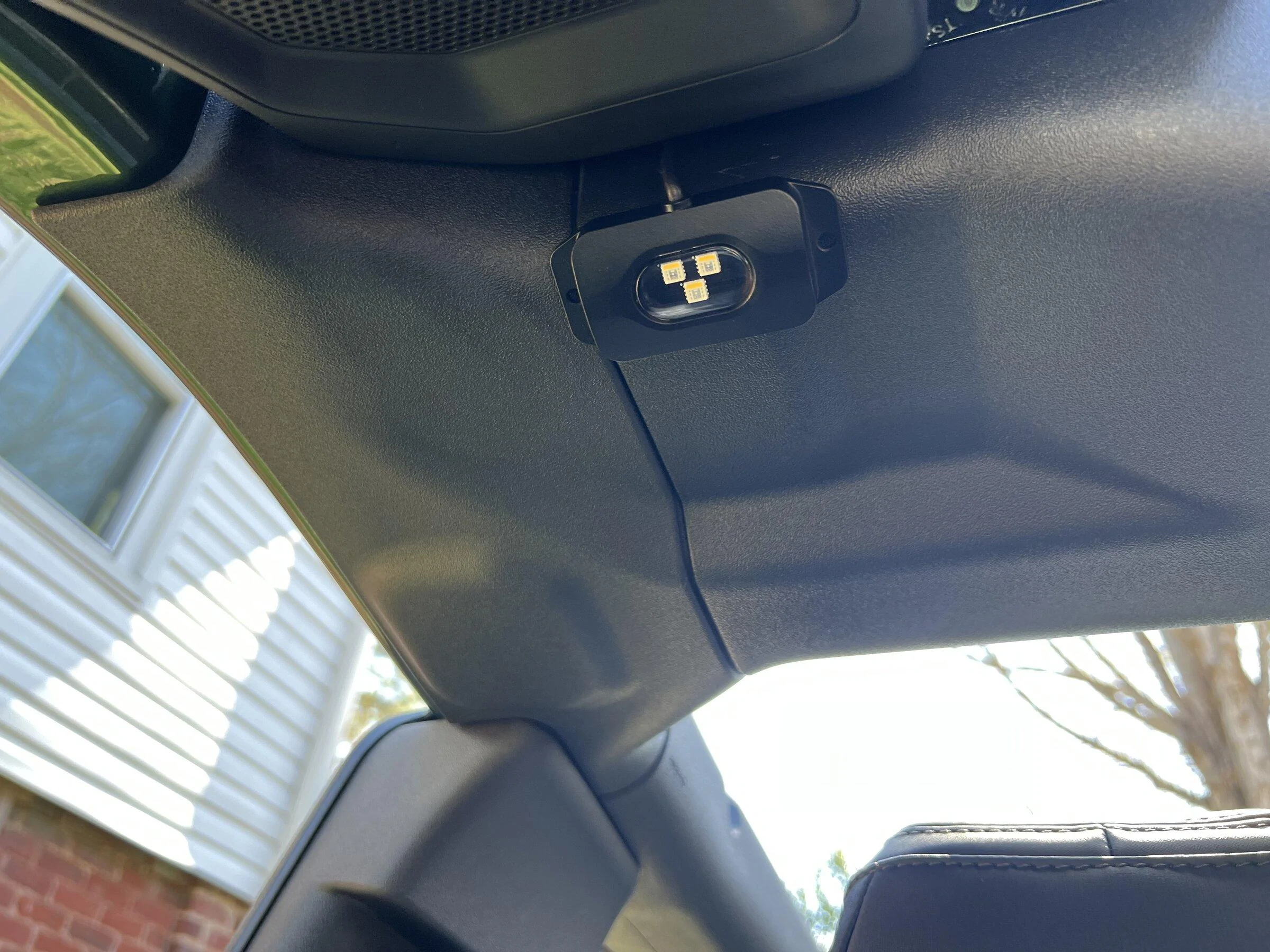

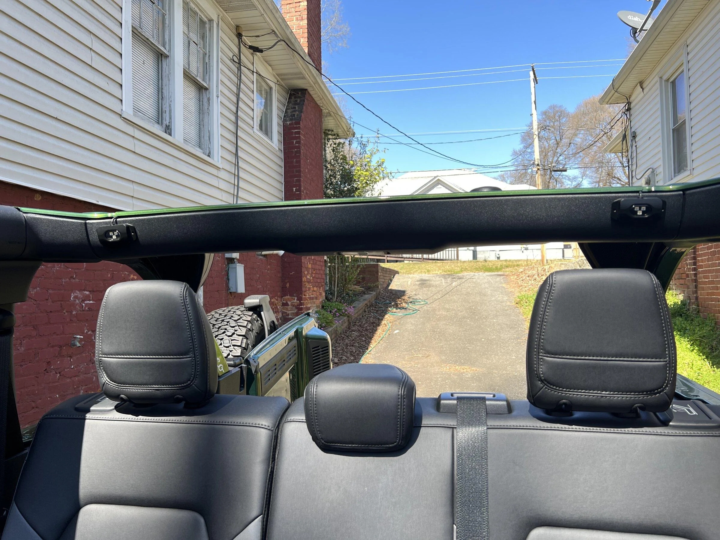

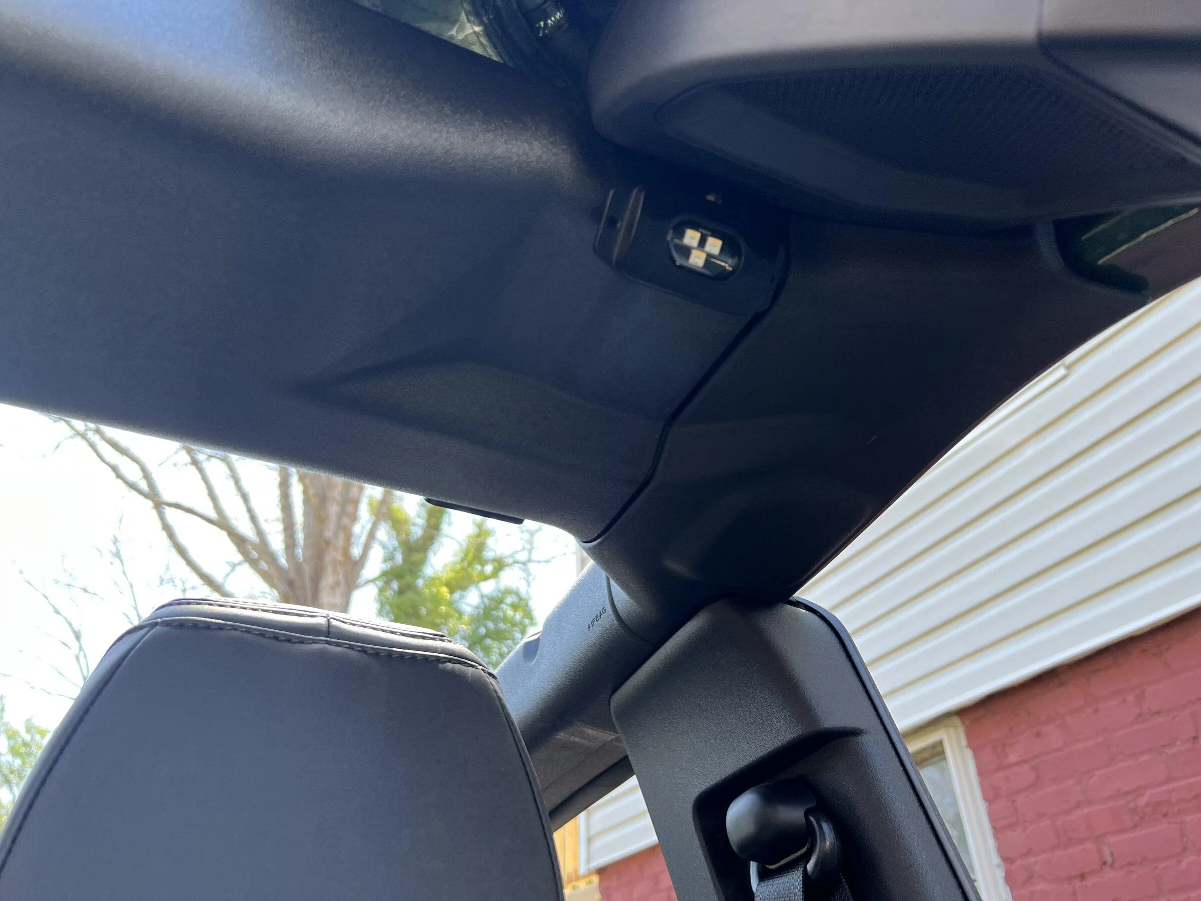

Having been unhappy with the interior lighting of the Bronco, I upgrade the interior lighting using Govee LED under lighting kit. https://www.amazon.com/gp/product/B0969PDDP5/ref=ppx_yo_dt_b_asin_title_o04_s00?ie=UTF8&psc=1 and wired it to Aux 6 Switch. The default setting is white but it can also be set to any color or sync with music( I will never use that feature, but is there for those who want a disco Bronco). I couldn't be happier with the results, its like daytime in the car when I turn them on. I can also dim the lights using the Govee app but for the most part I never have the need to open the app. The default white full on works for my purposes. Hard to beat for $50 in parts and a little sweat equity.
The whole process took be about an hour an half to wire. I used the Aux 6 switch and wired it to the rear white/orange aux wire in the passenger side rear. I had to remove both covers of the air roof air bags to fish the wire along the roll cage (yes, made sure to secure the wire to not interfere with the opening of the air bags) to the rear cover of the roll cage. The covers are the only trim pieces secured with bolts. The rest of the top trim and side trims are all held in place with body clips. I pulled down the rear roll bar trim piece to store the LED driver/Control and fished a wire down the passenger side pillar to tie into the Orange/white aux wire. I stuck the lights on above the airbags on the soft top front brackets using 60lb double sided tape and the rear lights on the rear roll bar just behind the passenger seats. The install is clean and you hardly notice the lights until they are on.

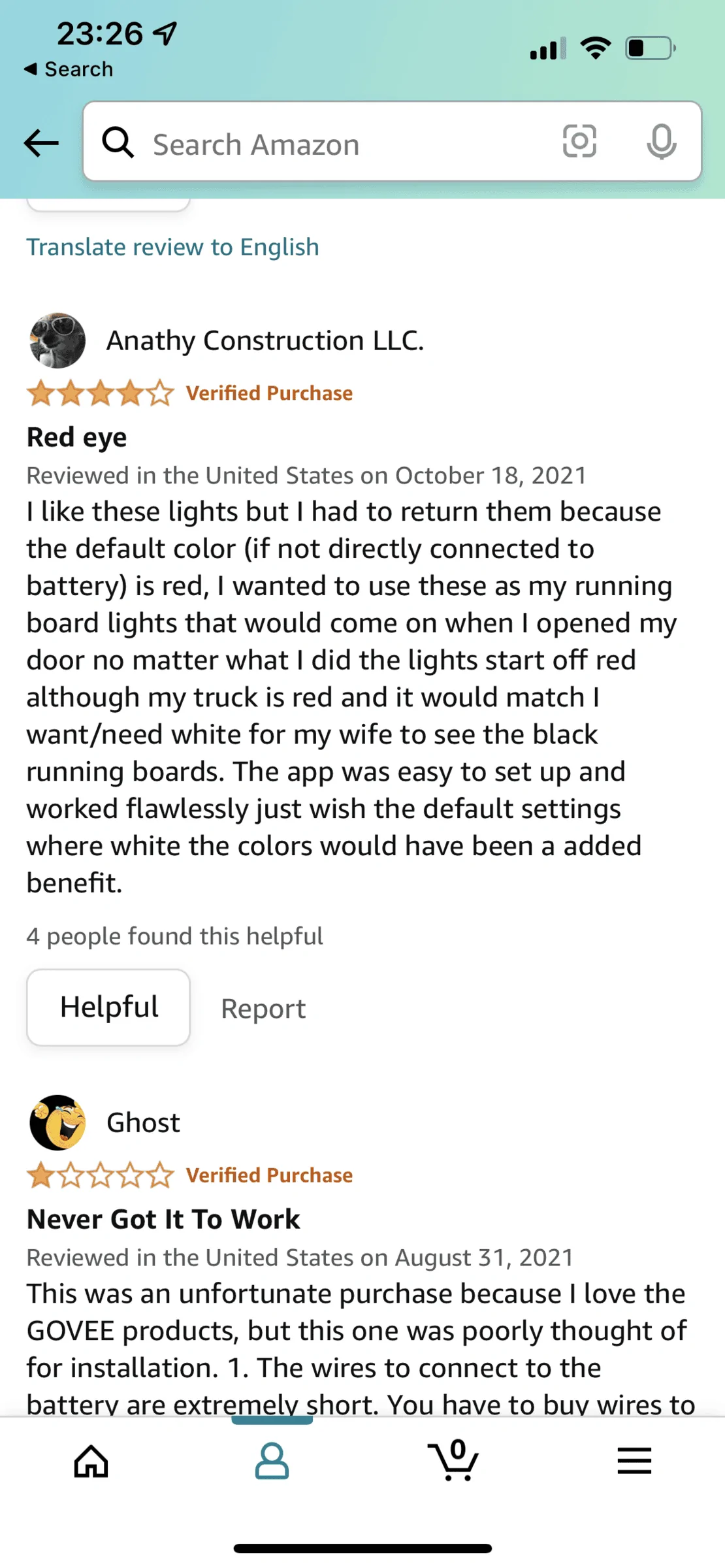

Hey OP I just had a question on these:
Your post says the default color is white…i put these in my black diamond over the weekend, but it seems to me the default color on mine is red.
did you select your default color?
Also saw this review on Amazon, so just a little confused.
Thanks
Thanks
I put these in today after seeing the OPs post. I have them wired to the aux switch. I think mine was red when I first powered them up. But I changed it to white and it keeps the memory when I turn it on and off. The app is a little confusing at first until you play with it a little. It took me a while to figure out if you scroll down and select all the lights and change them to white and whatever temp/brightness you want it should keep that setting.
Hope that helps. I’d put a screen shot but I’m not in the truck and I can access it without the Bluetooth being connected.
ok that’s simple enough, I figured that was it

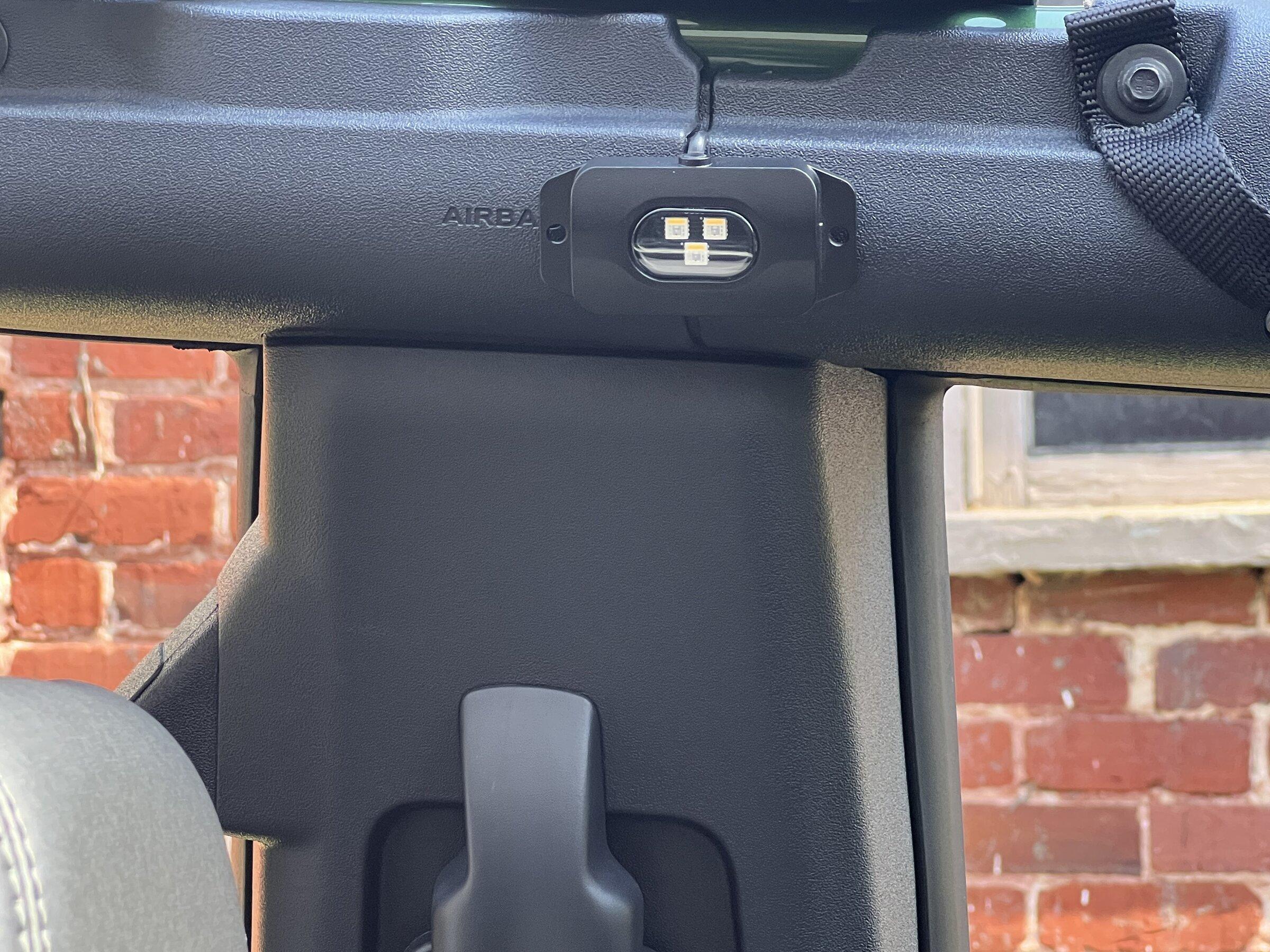

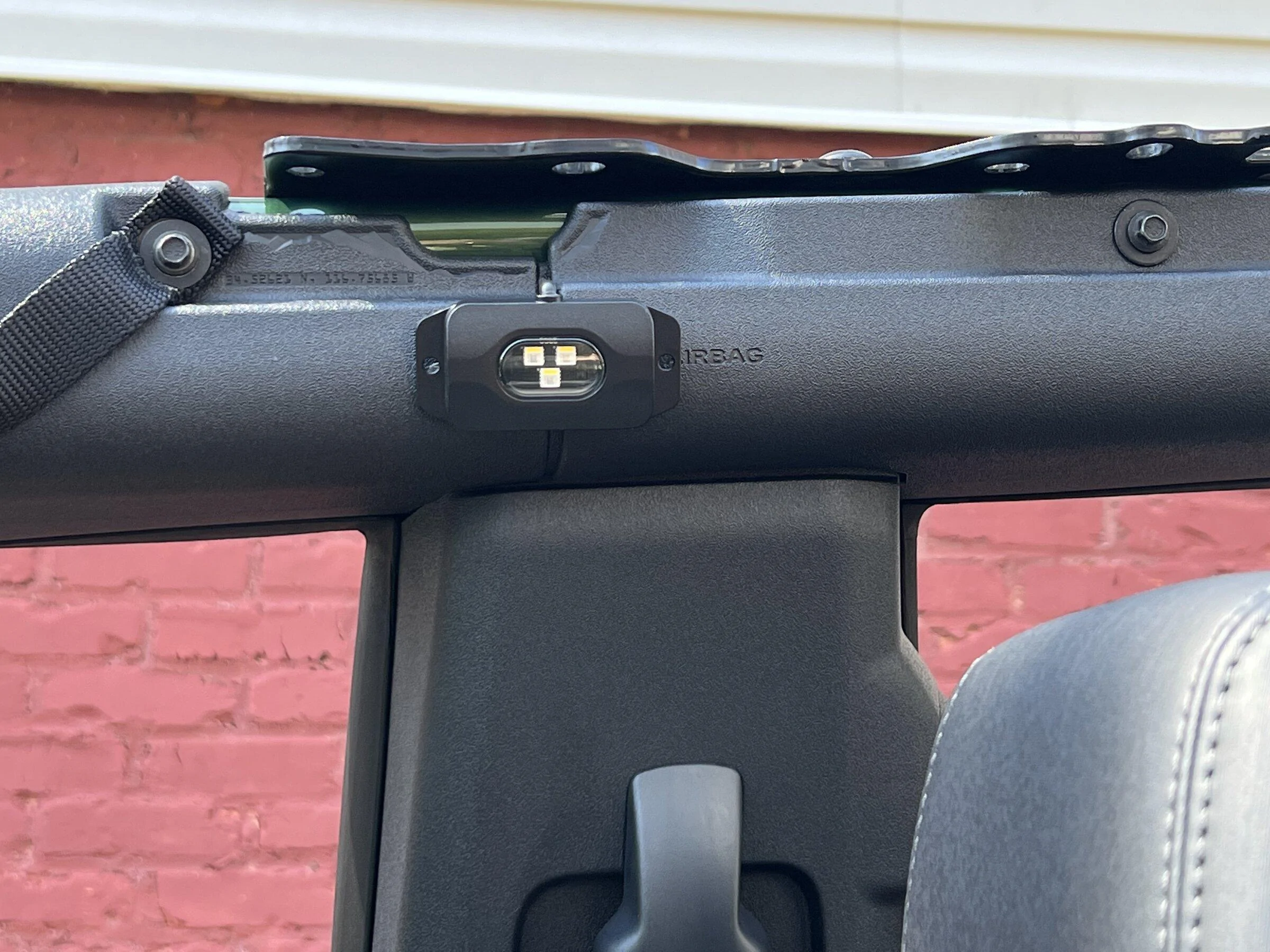

I got mine mounted pretty good with 3m tape
I bought the 6 pack for my 4 door

How hard is it to get those trim pieces down and run the wires? What about the airbags wouldn’t want those pods turning into projectiles if they were to ever go off?
The trim panels for over the doors are held in place with 2 screws, the rear piece is clipped in place.
I was concerned about the possibility of the lights becoming projectiles which is why I mounted them above the airbags. It appears that the bags are designed to roll down so it may not be a factor but I didnt want to take a chance.
yea, the soft top gives a much better option. I’m still looking at a way to get mine totally above the airbag.
but yea, they do fire downward so I’m not terribly concerned.,
looks like you are blocking your airbags. You dont want those lights shooting at you in an accident. looks like you screwed them too. I would check for damage to the airbag.
So, I’m using 3m tape I didn’t want to drill.
from what we all know the airbags fire DOWNWARD
that being said I’m looking for an alternate spot for these front ones just for 100% peace of mind.
