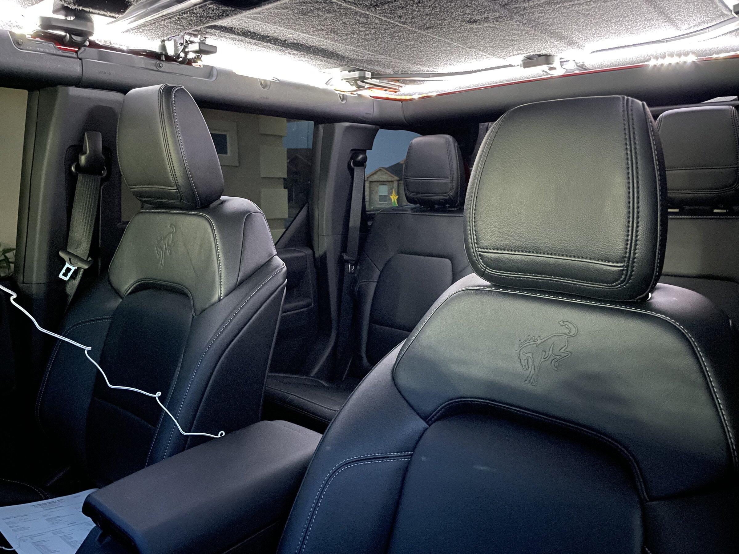

Having been unhappy with the interior lighting of the Bronco, I upgrade the interior lighting using Govee LED under lighting kit. https://www.amazon.com/gp/product/B0969PDDP5/ref=ppx_yo_dt_b_asin_title_o04_s00?ie=UTF8&psc=1 and wired it to Aux 6 Switch. The default setting is white but it can also be set to any color or sync with music( I will never use that feature, but is there for those who want a disco Bronco). I couldn't be happier with the results, its like daytime in the car when I turn them on. I can also dim the lights using the Govee app but for the most part I never have the need to open the app. The default white full on works for my purposes. Hard to beat for $50 in parts and a little sweat equity.
The whole process took be about an hour an half to wire. I used the Aux 6 switch and wired it to the rear white/orange aux wire in the passenger side rear. I had to remove both covers of the air roof air bags to fish the wire along the roll cage (yes, made sure to secure the wire to not interfere with the opening of the air bags) to the rear cover of the roll cage. The covers are the only trim pieces secured with bolts. The rest of the top trim and side trims are all held in place with body clips. I pulled down the rear roll bar trim piece to store the LED driver/Control and fished a wire down the passenger side pillar to tie into the Orange/white aux wire. I stuck the lights on above the airbags on the soft top front brackets using 60lb double sided tape and the rear lights on the rear roll bar just behind the passenger seats. The install is clean and you hardly notice the lights until they are on.

I guess it would be possible, not sure what the the interior lights are rated for amp draw. I would think you could tap into the line at the rear of the roll bar assuming you don't over load the circuit.

These lights are RGBW so you can set the color temp to whatever you want. Additionally they can be dimmed to a lower level if desired.

You use the Govee app to change the color and brightness. They will power back on from the aux switch to the last setting they were on when you powered them off.

They are on the bracket that the top locks into so there is no issue with the top back or removed.
