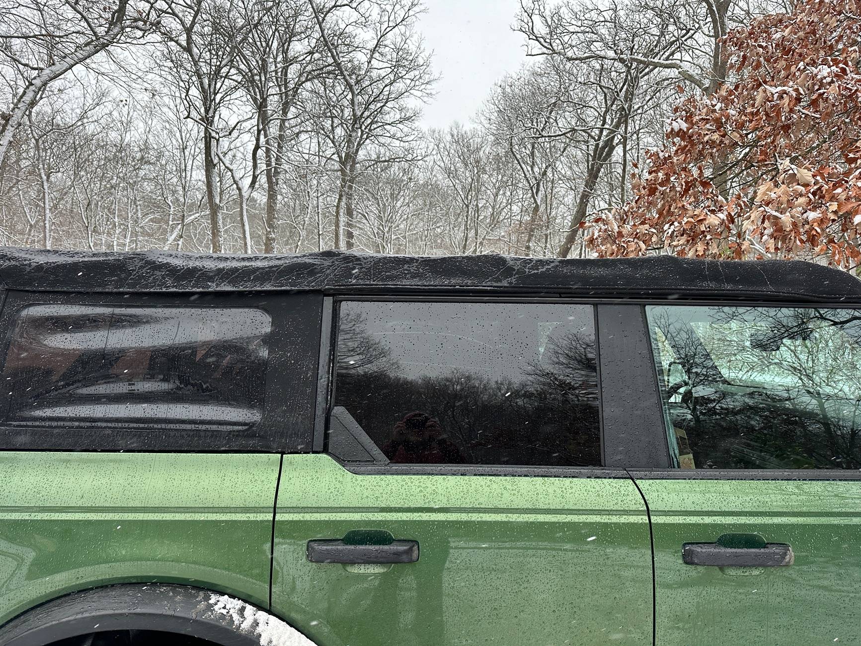

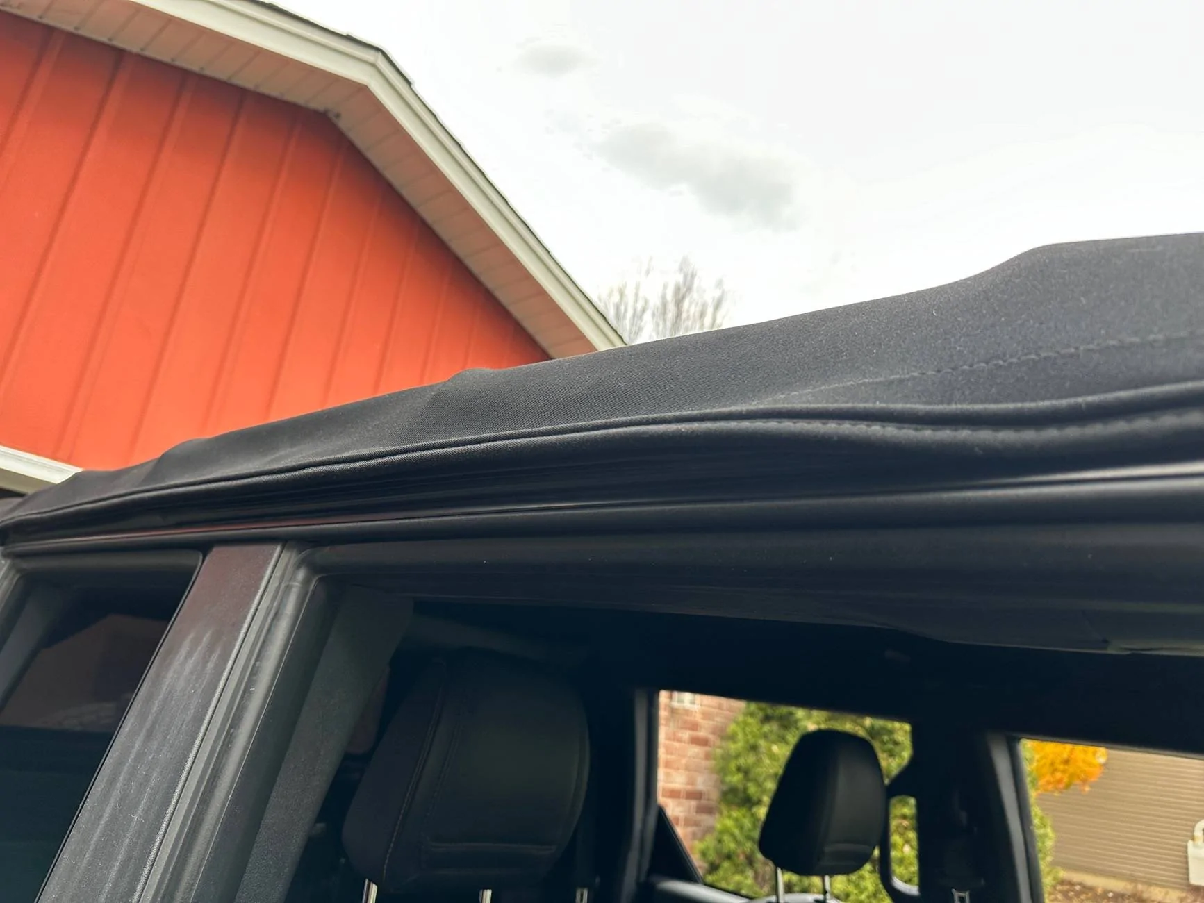

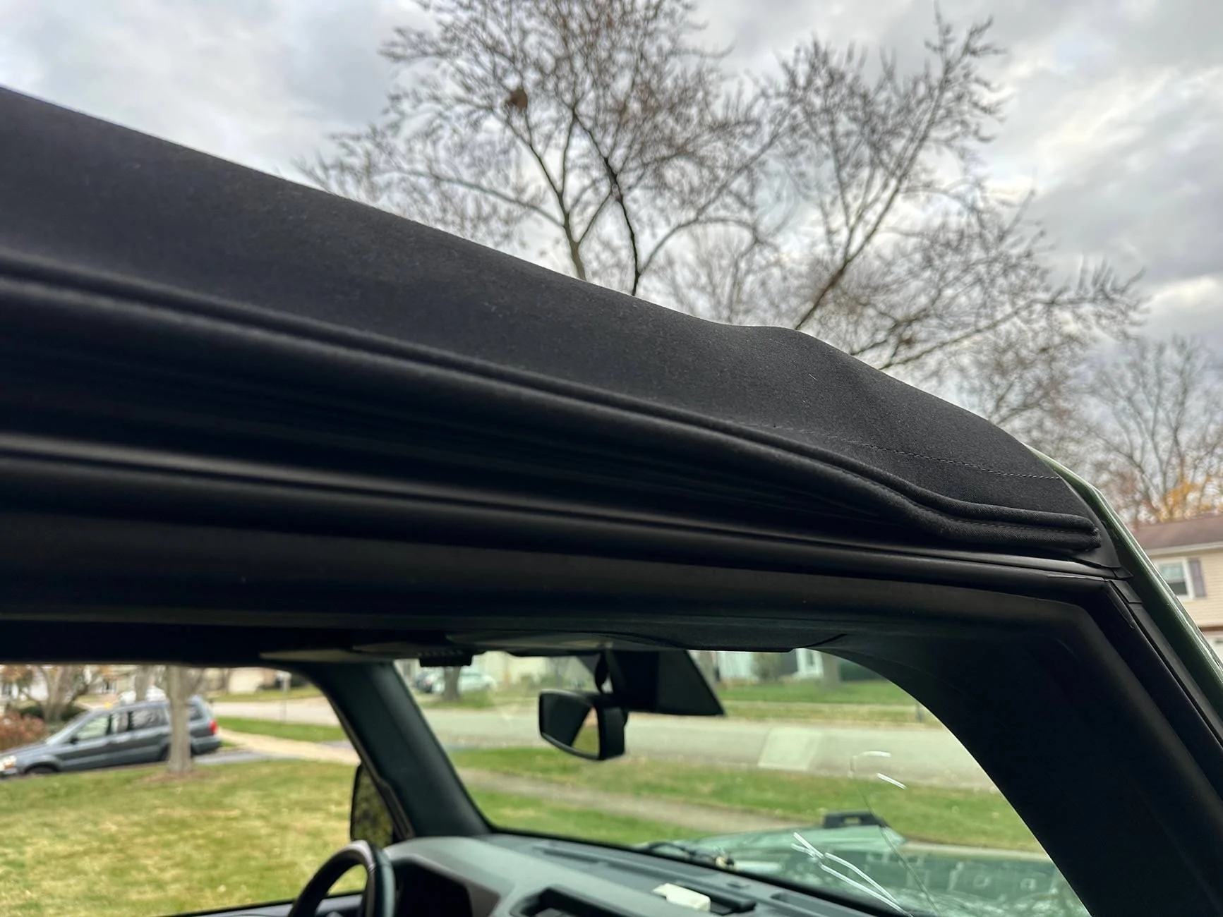

Few hundred miles from the big 36 and the soft top on my 21 month old Badlands has gone completely wonky. I recently moved from SW Florida back to the Windy City and apparently the top is protesting the move.
This top has always been really good, of course not the quietest thing on the block, but I’ve never had issues with water intrusion or wind excessive wind noise, and this thing has spent the vast majority of its life doing highway miles.
Now this. It was snowing here a few days ago and I noticed it getting in the top. I haven’t had the top back for months now. Get out and look and the passenger side has peeled away from the car and the ā€œloaded diaper sagā€ is really bad, way worse than it has ever been.
Still love the soft top, just hope this isn’ta sign to come. Any high mileage guys see this? Any fixes?

From WAY back, I remember being able to reach into the gap shown on the OP's picture and nearly get my whole hand inside - I actually tried that when I test drove a 4-door Badlands before mine showed up. I have a hard top, so not an issue for me, but for those I knew that preferred the Soft top, I wondered if water intrusion or just how 'secure' this was from getting an implement of some type inside to open the door.
I guess what I'm saying is that it's not really a 'new issue'.

The soft top hasn’t been opened since February. And I don’t mind the sagging, call me weird but I like that look. The issue is the passenger side lifted out of the rubber channel and now I have wind and snow coming in. Not a lot by any means, but I don’t want it to get worse.

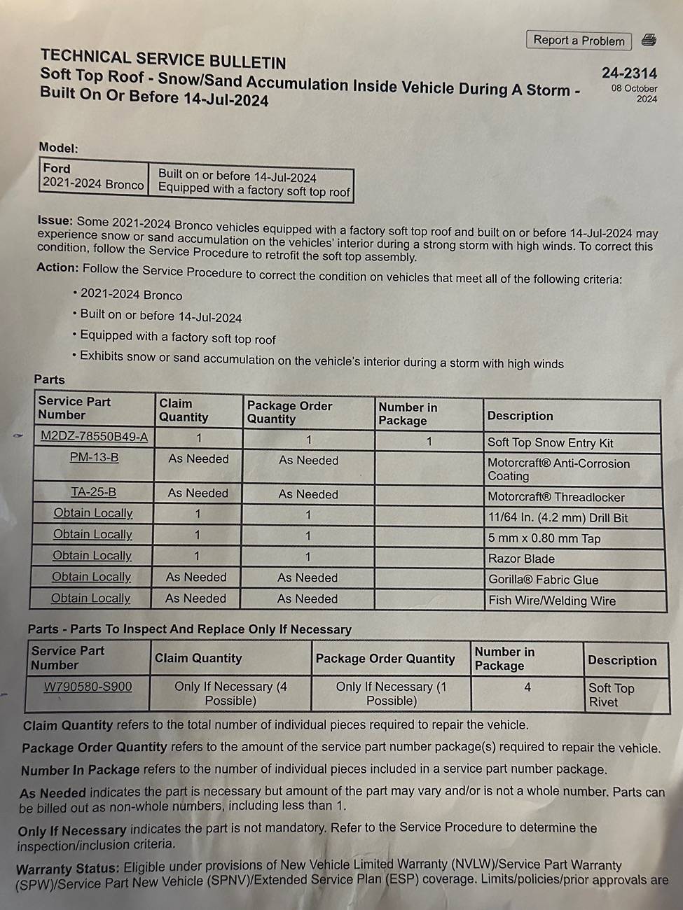

So there is a new TSB on this issue, they found it this morning at the dealership and ordered the parts. This one might help the guys in that thread about the cables, which I’ll look for later.
But, correct me if I’m wrong, but doesn’t this ā€œfixā€ seem like something the drunk neighbor would think up after his 15th breakfast beer?
Seems like quite the process.
https://static.nhtsa.gov/odi/tsbs/2023/MC-10230774-0001.pdf

Just a step above bubble gum and baling wire. šŸ™‚
