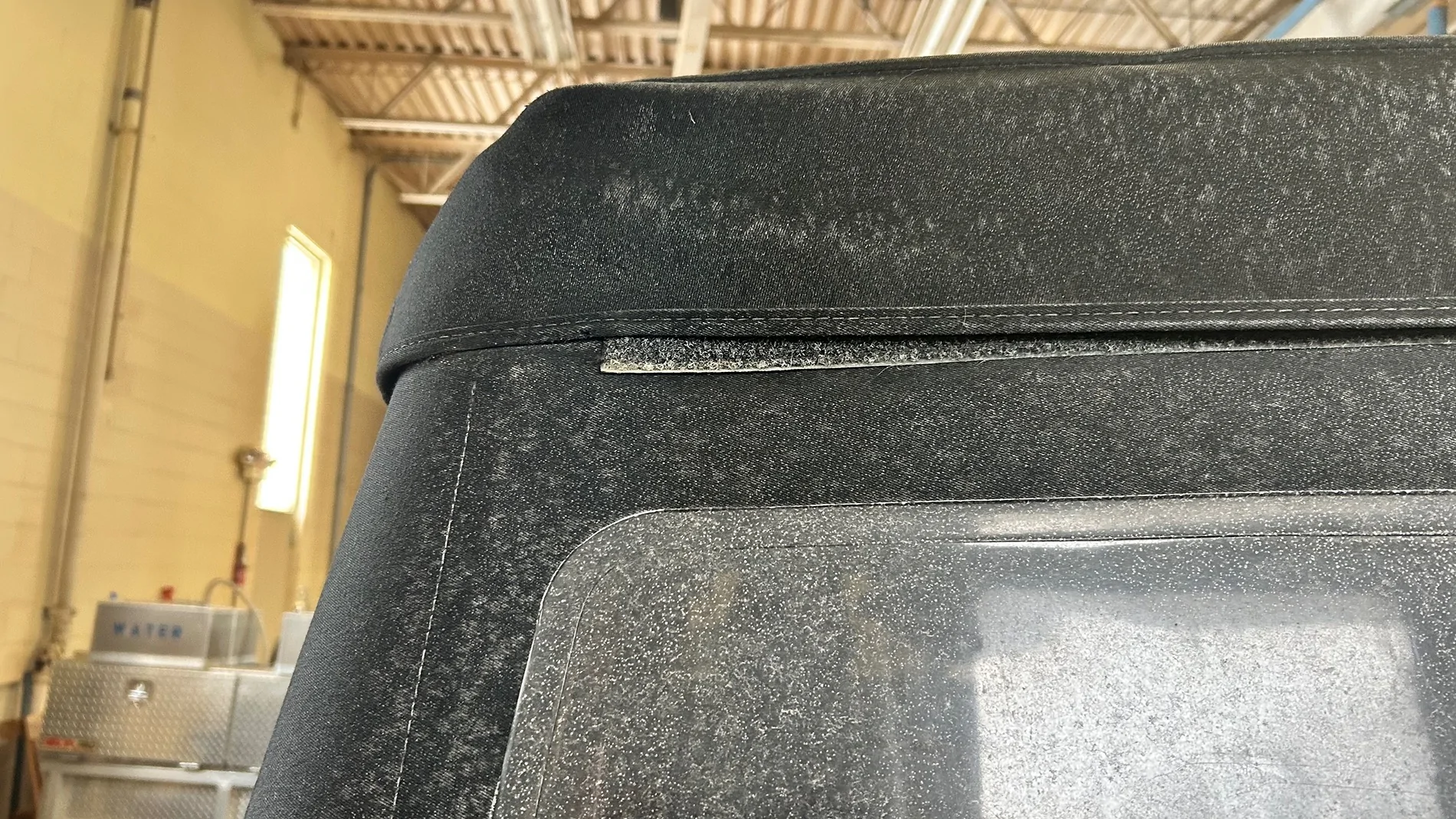

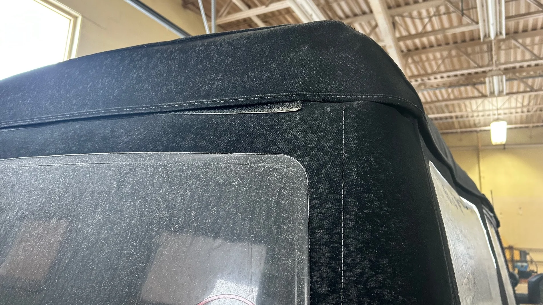

hey all our softop is shrinking to the point it doesn’t really cover the corners. Is there any fix for this? I can pull down and almost hang on it Velcro it and it pulls right back up.

'23 Black Diamond and your pic looks exactly like mine. Garage kept. Have tried every suggestion here and still no improvement. Disappointing.

We can and have done it every way possible I agree front flipped back makes the windows way easier to install. But ours still rides up. This is our second soft top bronco we love the functionality of it. I was hoping to get 5 years out of it before replacing. It is a wear item in a convertible.

There is "fixing" vinyl shrink, and then there is preventing.
Persistent fit issues, even in warm weather, typically points to plasticizer loss, seam stress, or frame misalignment, rather than reversible contraction. Vinyl generally does not shrink, but elongates and becomes brittle. The 'shrink' is generally from temperature cycling, cold storage, or stretching followed by contracted storage - resulting in a material memory.
I would begin with fitting the corner as best you can, then warming it up to 78-82 degrees F (heat gun on LOW 18 inches away +IR thermometer), and slowly stretching the corner. This usually is enough to undo the material memory. Once positioned, follow up with a vinyl protector, like 303 Aerospace Protectant or RaggTop Vinyl Protectant, after the corner has cooled. NEVER apply protectants to a hot top.
Over pulling, just like constant air turbulence, with permanently elongate the vinyl polymer and unbond the plasticizer (chemical that makes it flexible). Don't 'muscle' the stretch - low, constant pressure.
Over time, UV and prolonged heat causes the plasticizer in the vinyl to break down and evaporate or wash away. Washing with soaps or other chemical cleaners also does this. You can't replace the plasticizer; it's chemically bonded to the vinyl polymer. But routinely using vinyl protectants can prolong its life.
Best way to clean your vinyl - JUST WATER. Vinyl is a natural water repellant, meaning most dirt and road grime will wash away. If bird poop or tree sap or other such gunk gets on it, that is spot treatment. Vinyl tops through a car wash is a big no-no.
I hope it gets refitted for you.

It isn’t the look that is the issue. The problem is you can see daylight through it. It’s not even covering what’s needed. For a mid $50k vehicle and only a few years old it’s just disappointing.

Maybe try and adjust the top mounting brackets loosen them up with front top open, so you can get the fit you want them adjust the front strikers to where they need to be to secure......
Maybe aftermarket is the answer....
