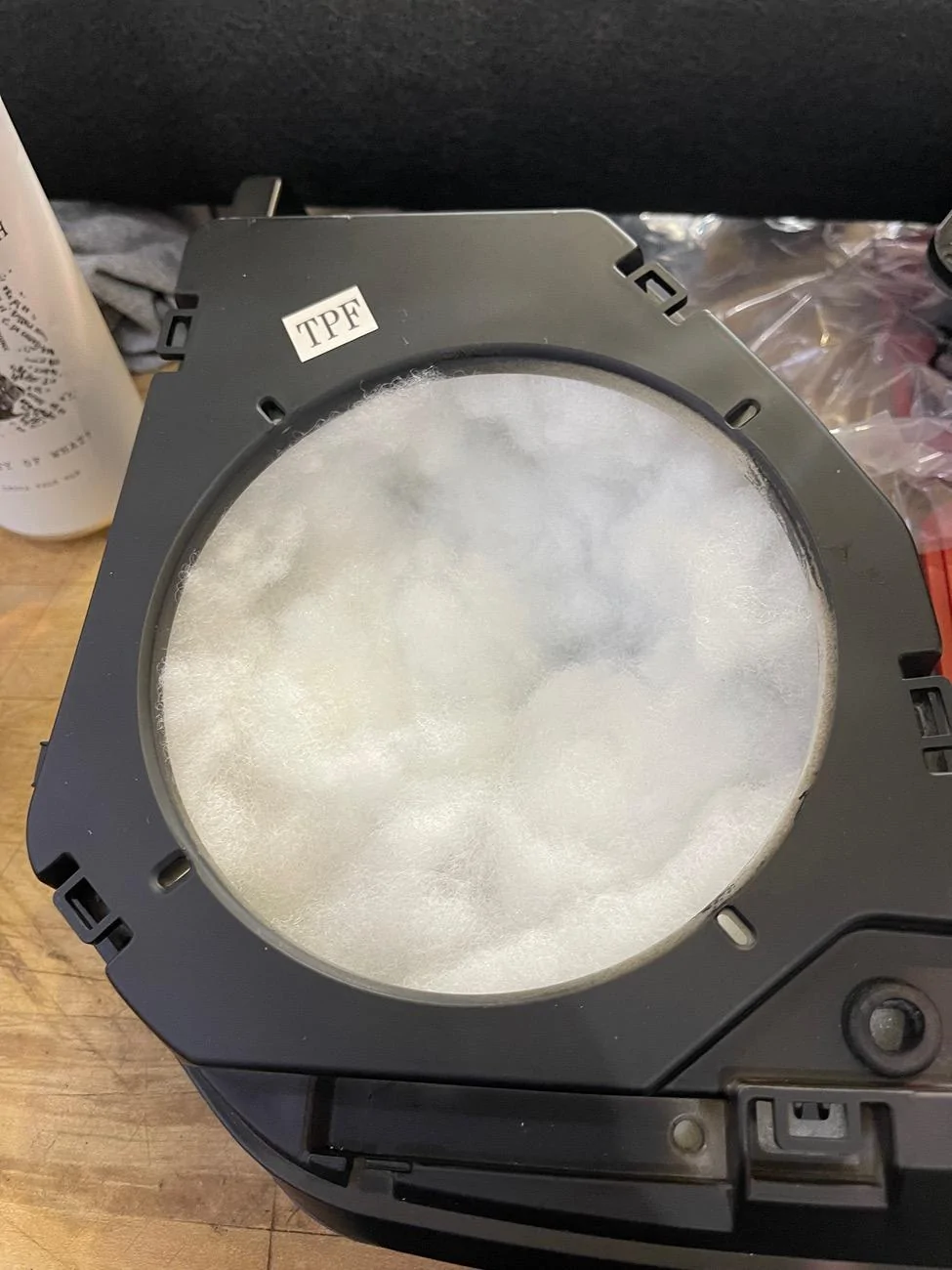

I used cheap polyfill (walmart) in all the speaker locations, seems to deaden the "tinny" sound. I'm happy with it..plus relatively cheap.

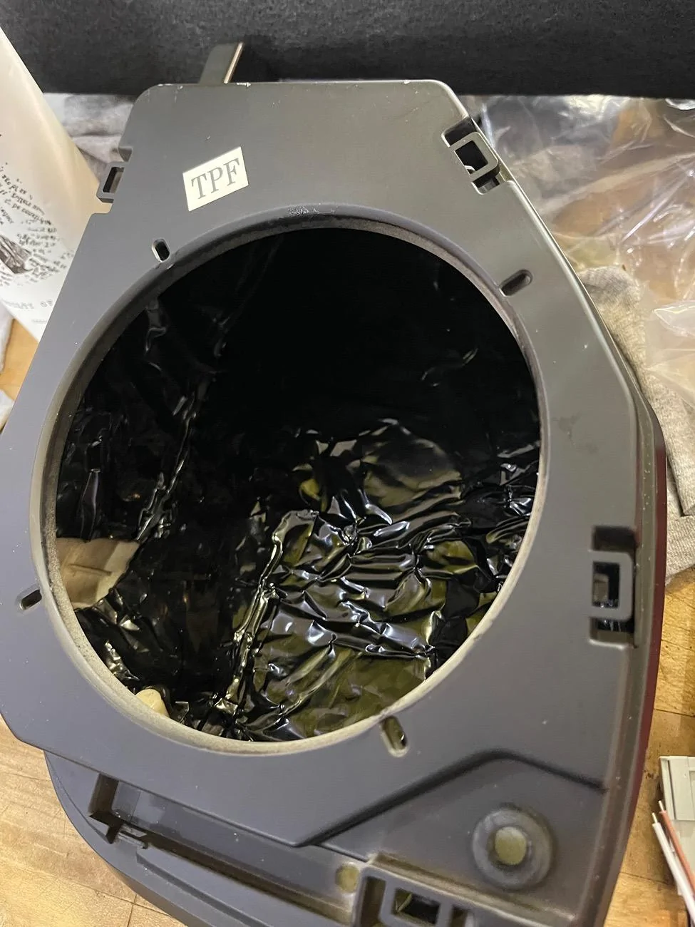

First go-round I left pods as is. Didn’t sound good so I lined every nook and cranny inside pods with killmat and also perforated the top “grill” with more holes(wider across) so sound comes out completely…..made a huge difference. Tried to add some pollyfill but didn’t change a thing so pulled it right back out. NOTE:

I used polyfil in the rear Mabett 6” pods. Sounds great with bathe bigger speakers and fill. I also used polyfil when upgrading the dash speakers. Cheap, easy, and sound great. Like others have said, doesn’t sound tinny at all.

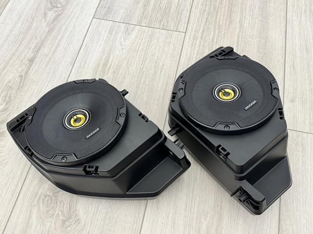

I bought 6.5" SSV pods with kickers and even though it sounds great and was a huge upgrade once warmer weather arrives I might add some sound proofing.
