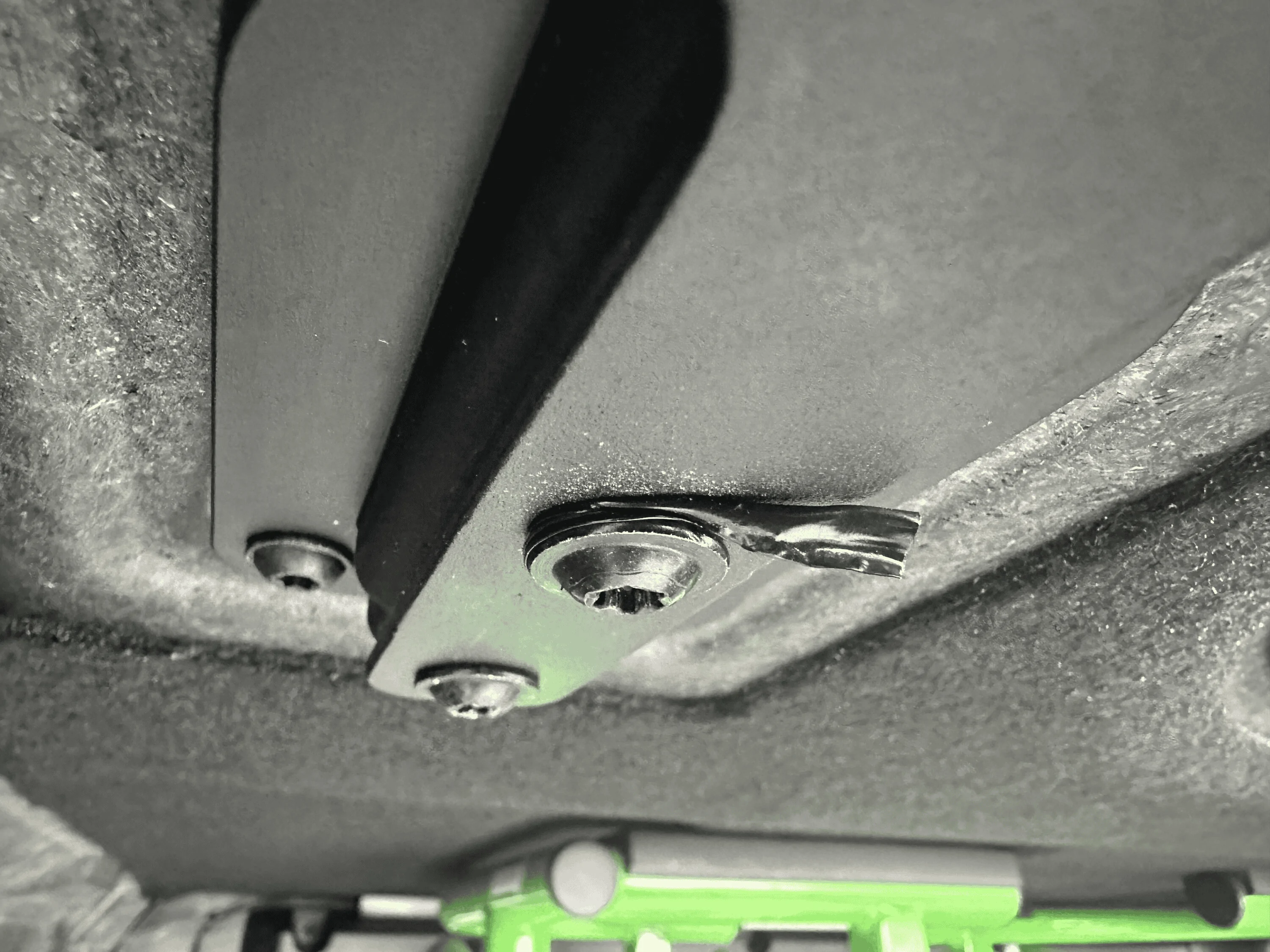

Ok, there are three possible locations this noise is coming from. I have had all three, and they are all documented well in this post I made over a year ago.
Squeak coming from Cargo Area - Fixed ✅ | Bronco6G - 2021+ Ford Bronco & Bronco Raptor Forum, News, Blog & Owners Community
1. Hardtop rubbing on rear fender (or sometimes rear fender rubbing on tail lights) - There is a TSB for this one, and it sounds like your deaer already tried to adjust for this one. Documented on post 1 of the thread above.
2. Hardtop lift glass window, weatherstripping rubbing and squeaking on tailgate. This one sounds more like a case of water bottles squeaking in the back than the chirpy sound you posted. But this one is easy to diagnose, lift the glass window and drive around. If the squeak stopped, you know it was the lift gate. You need to clean this weatherstripping seal, and apply Krytox lube every so often.
3. Mounting bracket on rear hardtop clamshell is loose. Page 5 of the thread I linked above has some great info on this one. There were several of us that found the same exact screw on the hardtop mounting bracket to be loose, and letting the bracket have some flex and squeak against the frame. I think this is likely your problem. Here is a pic of mine, I had to tightly wrap some electric tape around the exposed screw threads, as my screw was stripped and would not fully seat.
Ford Bronco Squeaking Top is driving me nuts, please help! 1690897899803
You mention you dont want to remove rear hardtop clamshell because of warranty concerns? The roof is meant to come off, including the rear clamshell. Its easy, no worries! You will need to remove it to inspect this bracket.
Good Luck! The squeaking is unbearable.
