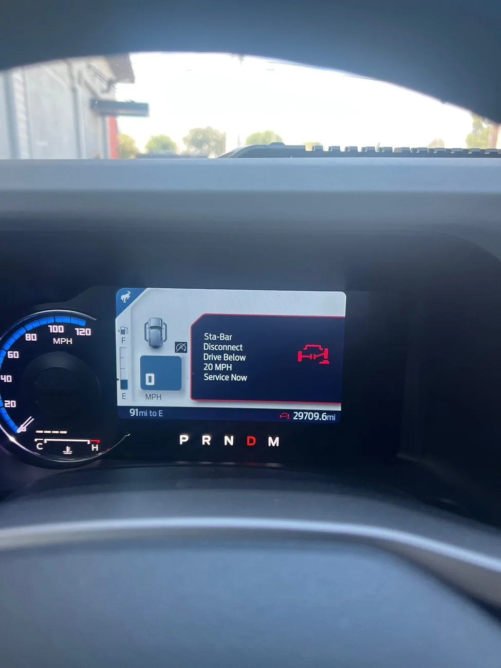

My 2021 Badlands just did this as well. Just came on at start-up, no recent off roading. Won’t go away with restarts.
Just dropped the Bronco off at the dealer for diagnosis. I also have been having issues with the intermittent failure of the front camera like @jxc.
@BroncoBoy22: Did your’s get fixed? Was it software related?

Yup mine got fixed and unfortunately was not software related. Mine was leaking
dealer got me like a 70% discount since my warranty had only been out for a few months. Wound up being like $980 in total to get replaced

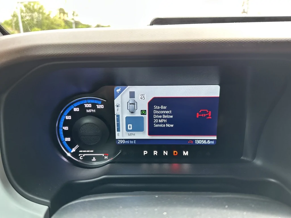

Got the dreaded
Ford Bronco Sta-bar disconnected error twice now.... EE8C2E26-F515-4B8B-B157-589505B4436B_1_105_c
while we were at the Super Cel in TN. We were going to leave on Sunday but cut things short and left on Saturday hoping we would make it back home (350 miles) without issue. Well made it back no problem other than having to look at the message the whole way. Took it to the Ford dealer on the following Monday and at first they thought it might be a sensor or wiring but after inspection found the stabilizer bar was leaking. They ordered a replacement and it arrived on Friday, picked the Bronco up yesterday. All still under warranty so didn't cost anything. Happy to the it back!
