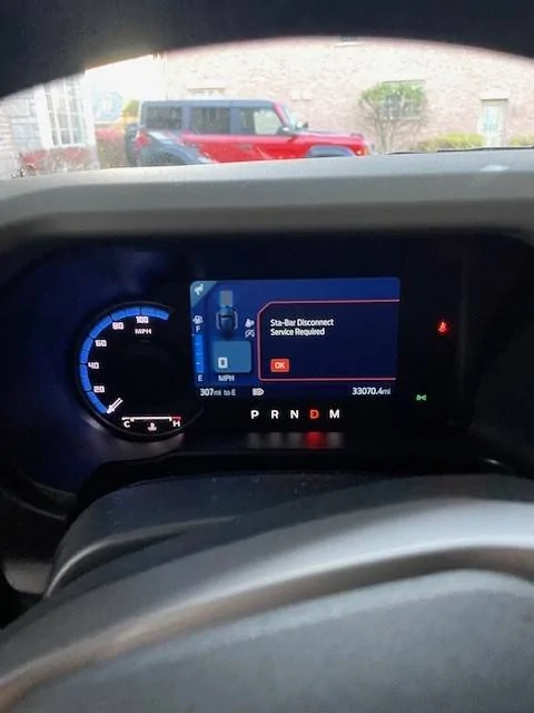

So the good news is I made it to 32,000 miles before getting the dreaded Sta-Bar error. It’s now at the dealership for the 2nd time in 3 weeks. Anyone have an update to what the dealer should be doing to fix it correctly?? THX

Add me to the list. Just got the Badlands back after the Bilstein Shock failure, that took 2 weeks to get a part in and fixed. Now the sta-bar disconnect fault pops on. Bronco is also hard to shift from park to drive, like super clunky and requires some good effort. 33K miles, and getting pretty worried about gremlins and what is gonna break down after factory warranty is up. Is the Sta-Bar part of the 5yr drivetrain warranty? I don't think it is, but since its connected to the drivetrain, I figured I would ask. I do have an extended warranty, it is just a pain to keep taking this thing back and forth to the dealership due to reliability issues. Stinks.
