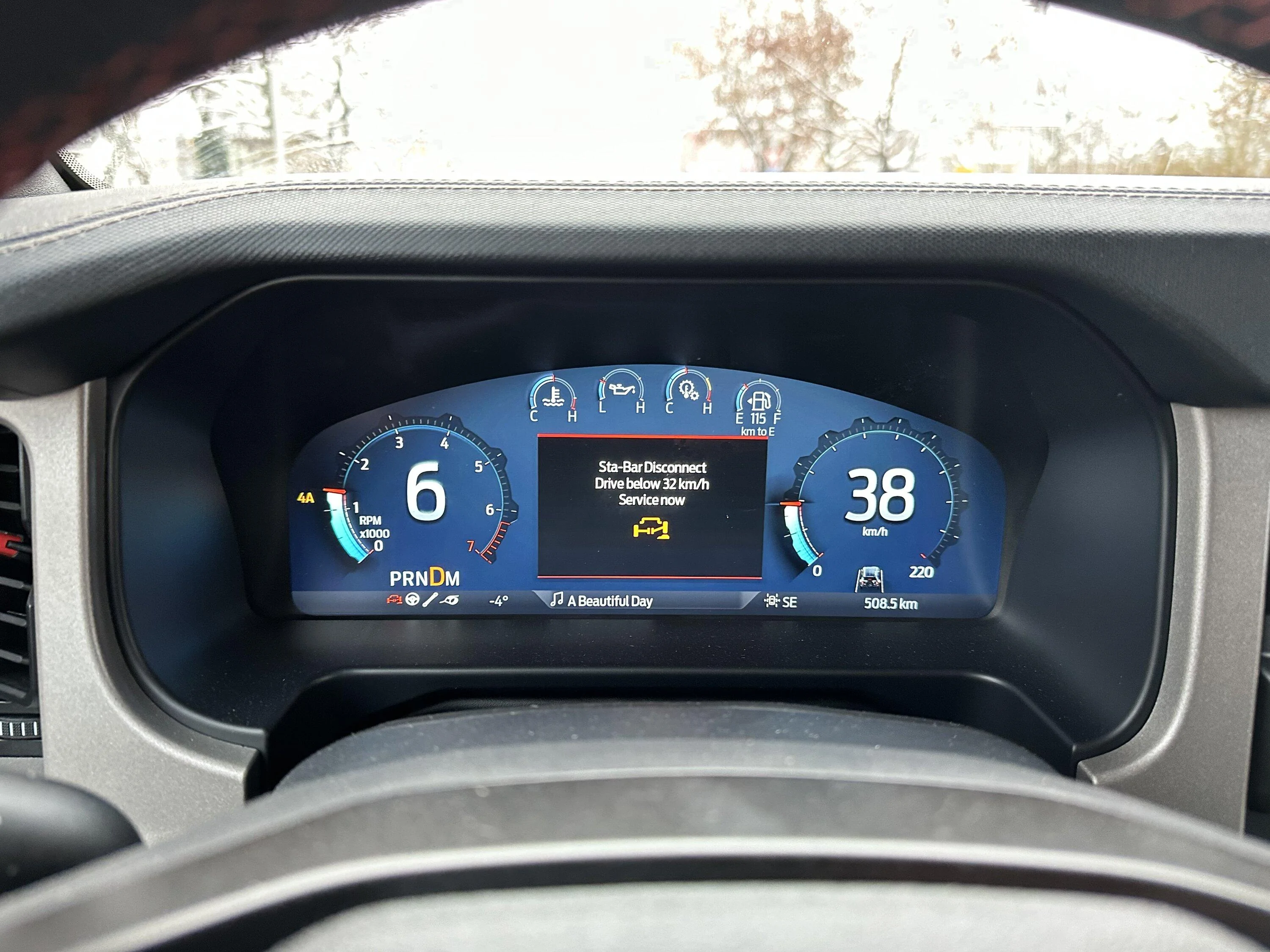

Raptor. Happened to me quite quickly, when I had only about 500km/~310 miles. I was on a roundabout and went fast around it, and got the error immediatelly. Swaybar was not disconnected. Cleared the error via Forscan and no problem after several hundreds of kilometers after that. Did the same roundabout in same speed and all good. Let’s see…

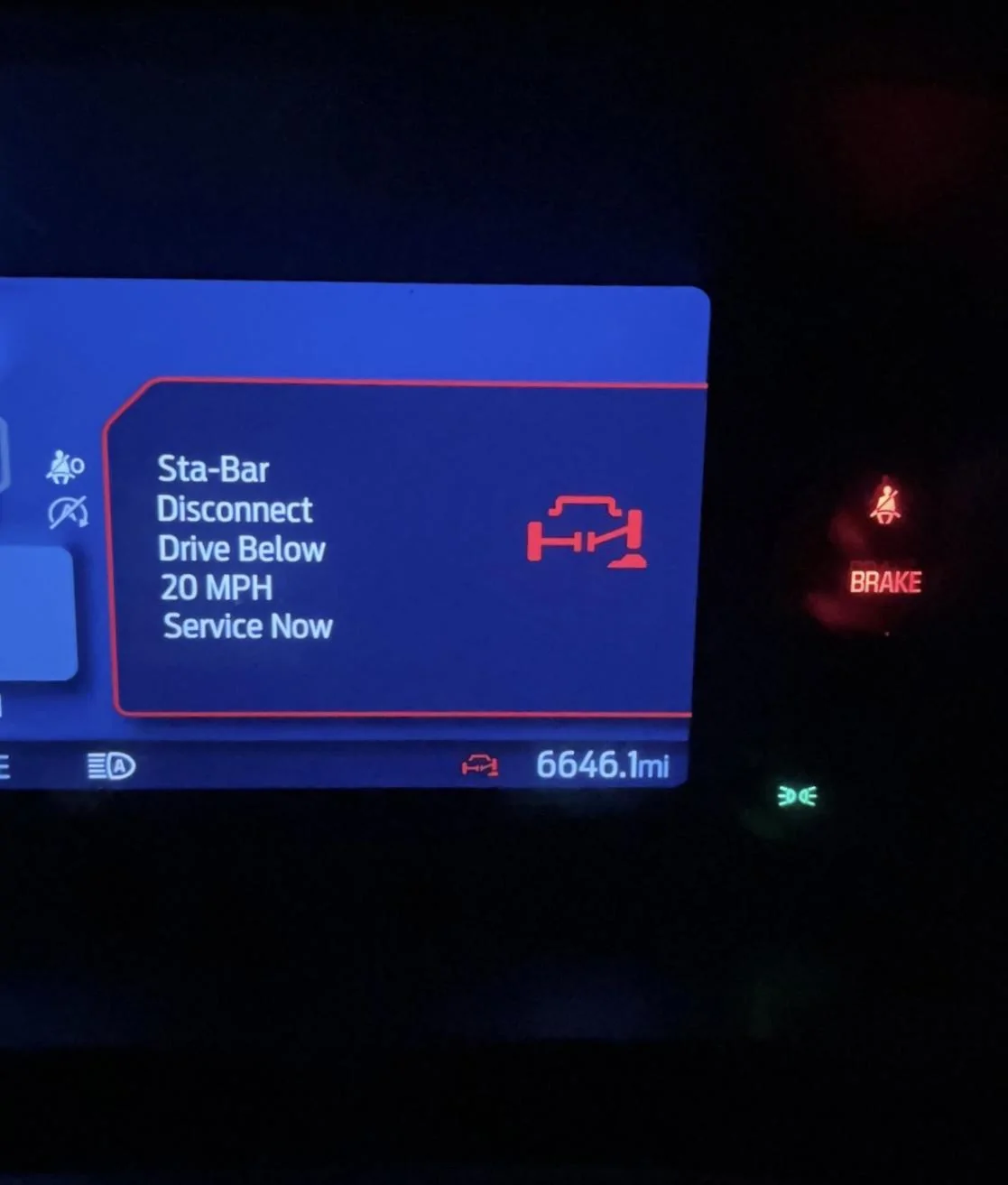

Just had this pop up today. 21 Badlands produced in November of 21. 19,339 miles (I think I win the mileage contest on this one). Haven't been off roading in over a month, haven't had the sta-bar disconnected since October. Leaving the parking lot at work and it came on. Used Ford Roadside Assistance to get towed to the dealership (which took damn near 4 hours because apparently Ford contracts with morons out here). Thanks to the tow driver, I had to drop my Bronco off at the service department after hours. They'll call me tomorrow and let me know what they find.

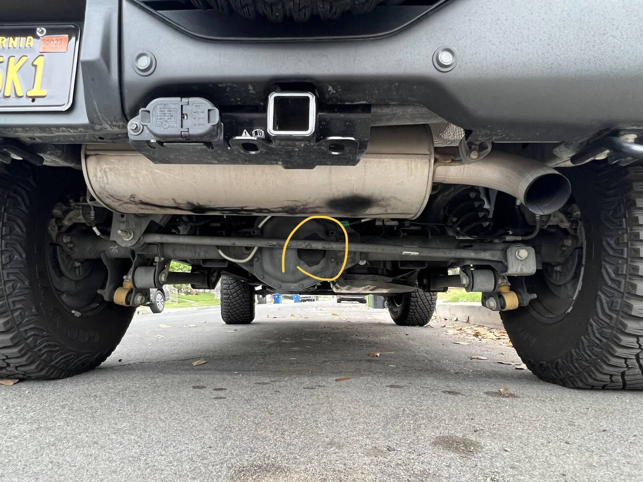

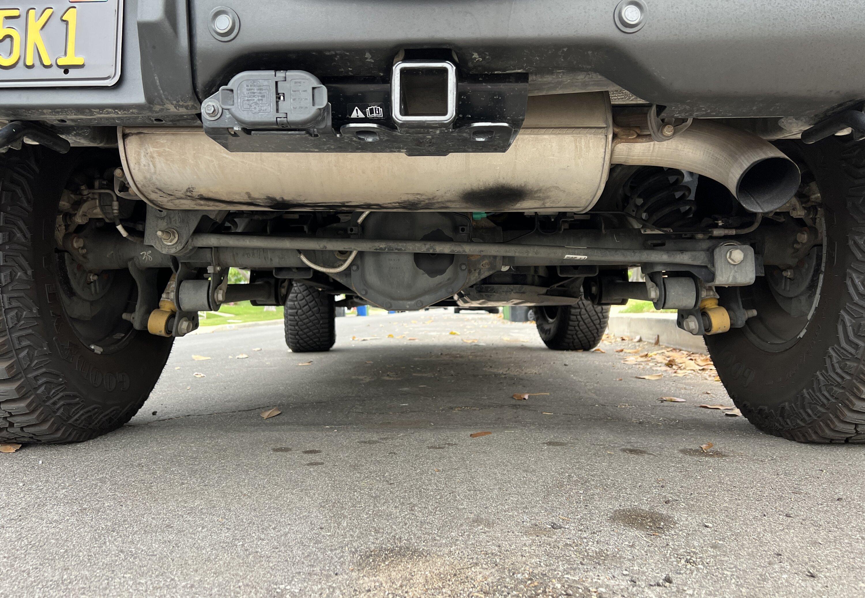

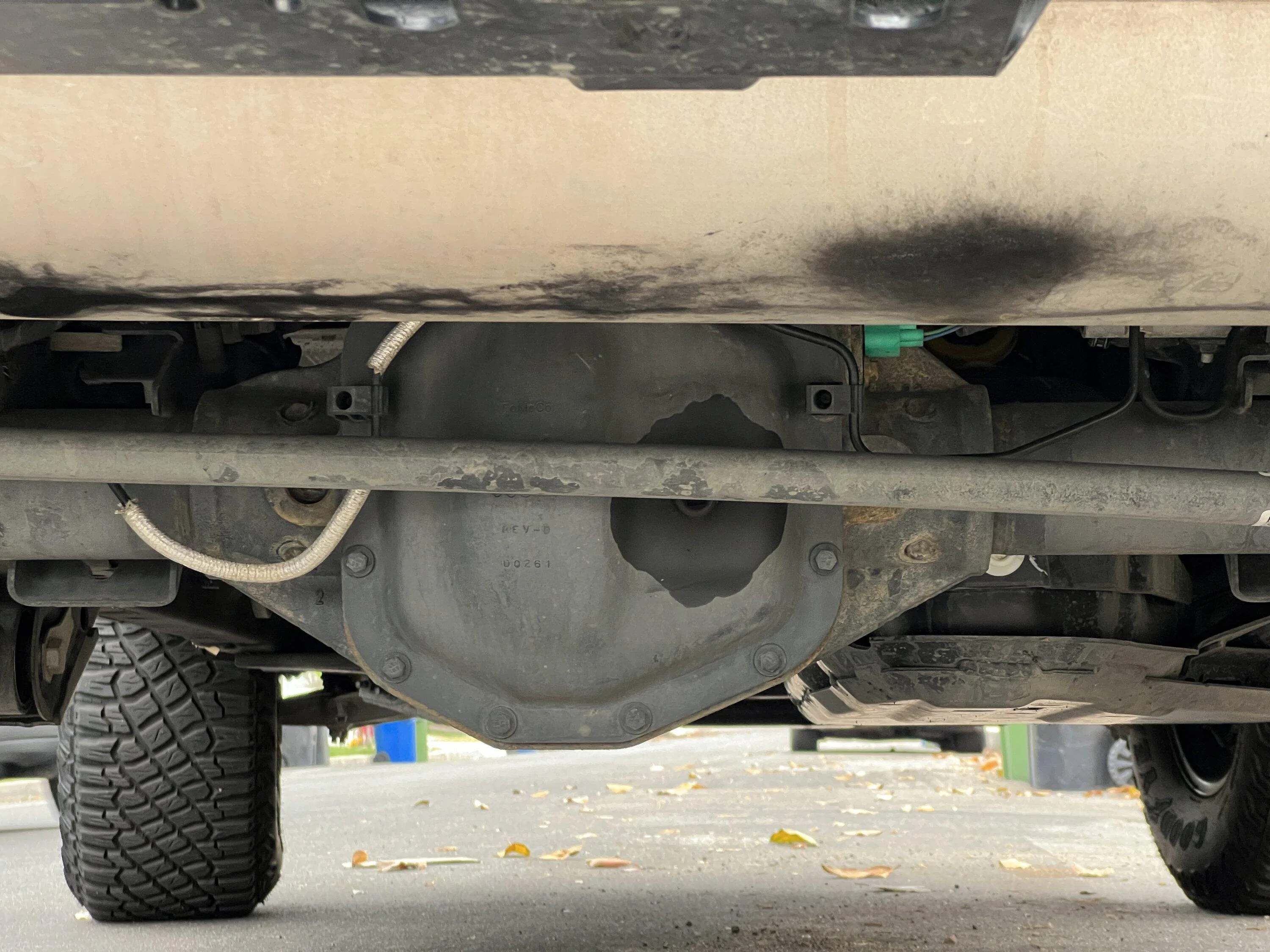

After prob 5 service visits - starting w software updates, electrical grease and a slew of other things that didn’t work, they finally think they’ve fixed it by replacing stabilizer and disconnect harness (attached is latest service doc) I am hoping this works - only time will tell if so cause it happens on freeway almost exclusively and I can clear it out by pressing ok and restarting.
I see a grease or some fluid spot and for some reason the whole rear suspension seems slanted to me now, something I never noticed before. I need to look under my neighbors and see if his is the same.
anyone had this particular service done w success and does the rear assembly look right?
