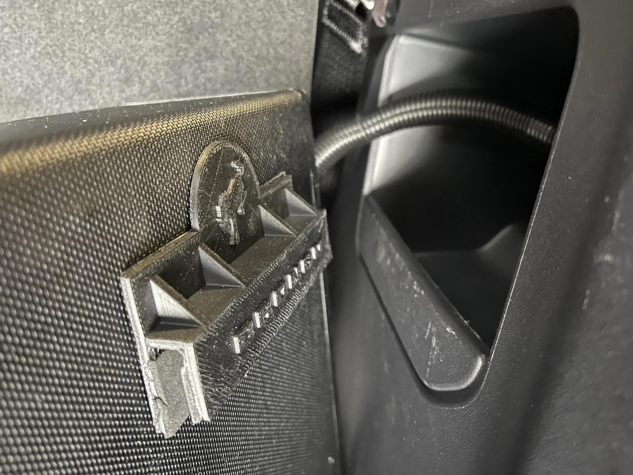

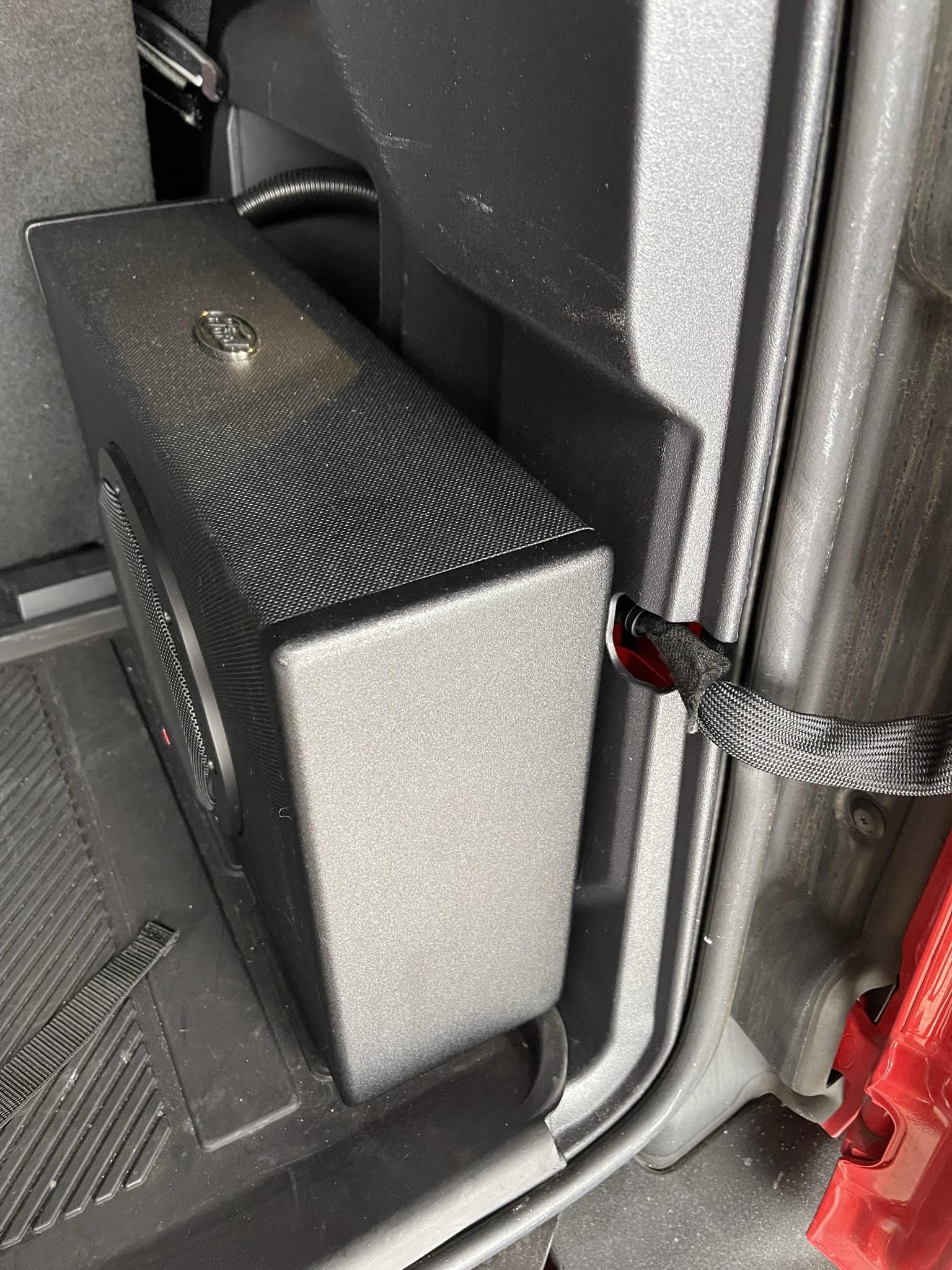

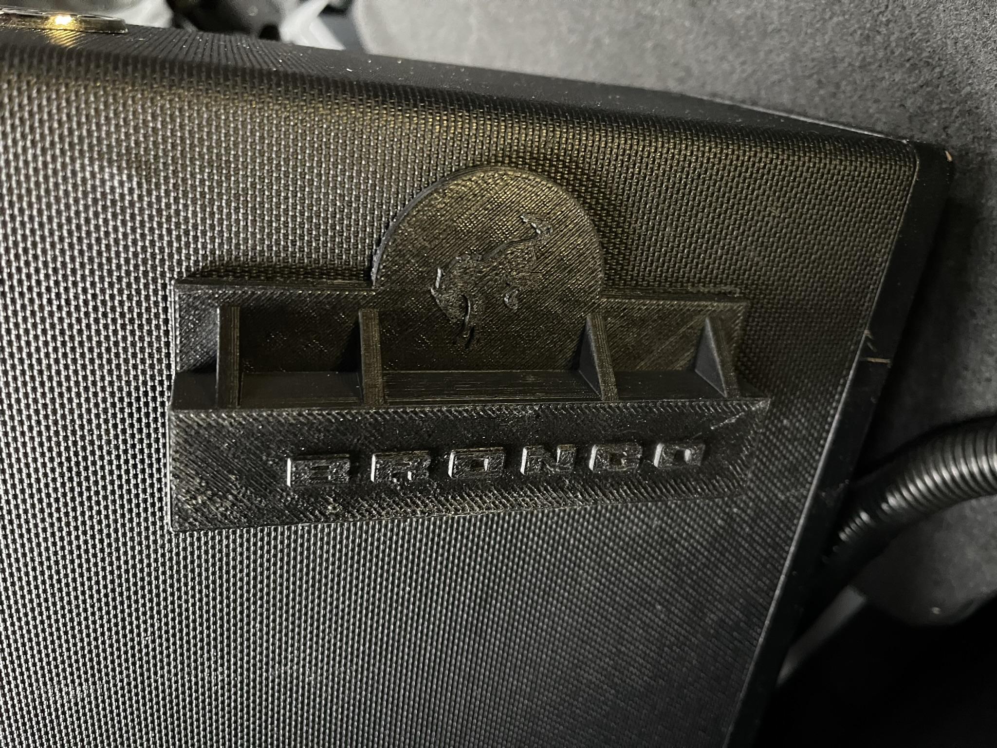

Do you have a pick of how it’s attached to the bracket and wall? Thanks

The bracket is attached to the sub with strong double sided tape. We'll see how long that holds, it may require a couple screws. You position the sub against the side wall and just slide it down so that the bracket is using the storage bin to hold. I lined the bracket with some foam so it wouldn't scratch or rattle. It really works well!

well done! you should sell those brackets!!
