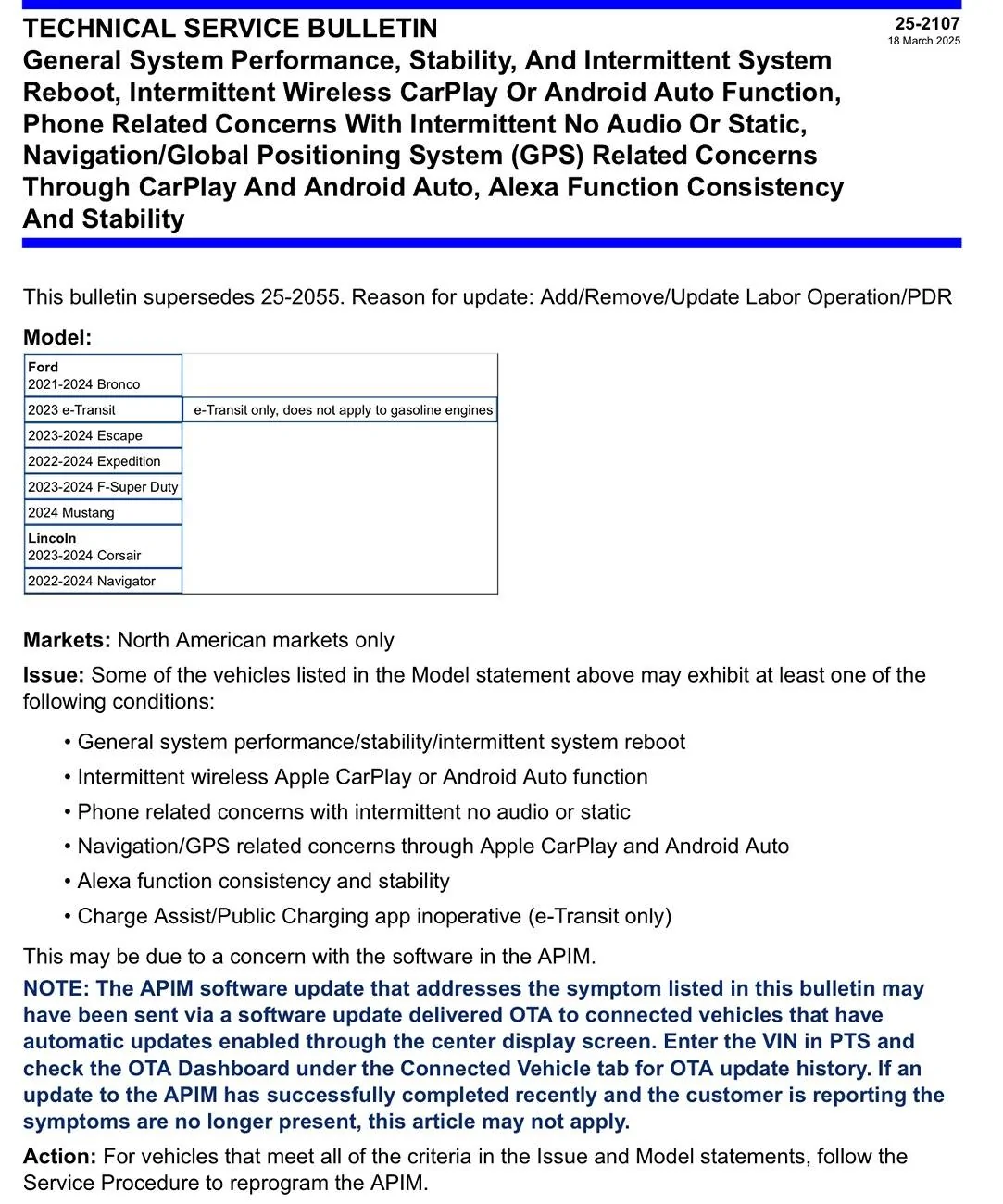

Same vehicle (except mine is a 2dr), same software version and revision number. To the best of my knowledge it has never updated since I purchased it new in April 2022. And I'm in the USA. The dealer has repeatedly told me it's up to date and there's nothing they can do.
However, I dropped it off today for some unrelated issues and made sure that my friend who is one of their service technicians was the one working on it. Because I knew he would communicate with me much better than some random person. He just called and said there was a TSB released about SYNC updates within the last week or so that should fix the issue. Whatever they are doing will take at least 8-12 hours so they are getting me a loaner car for tomorrow.
I'll post back with more when I know if it updated successfully.

Successful update!
I'm now on version 22293, revision 610
No idea if that's fully up to date or not, but it's certainly better than it was.
Here's what they put on the invoice, in case it helps:
"Verified the customer's concern. The technician found 25-2055 applies to the customer's concern. Verified the vehicle has open campaign 25-2107. This vehicle requires software module updates. Accessed the diagnostic port, connected the FDRS and performed a gateway module software update APIM update and TCU update all needed several updates to complete process. Cleared all diagnostic trouble codes. The system is now operating as designed. Request extra programming time"
I looked online for info about the two codes mentioned. 25-2055 is a TSB that came out about a month ago regarding sync not working properly. I couldn't find anything on 25-2107, and I think it might be a typo.
25-2107 is the newest number and supersedes 25-2055
