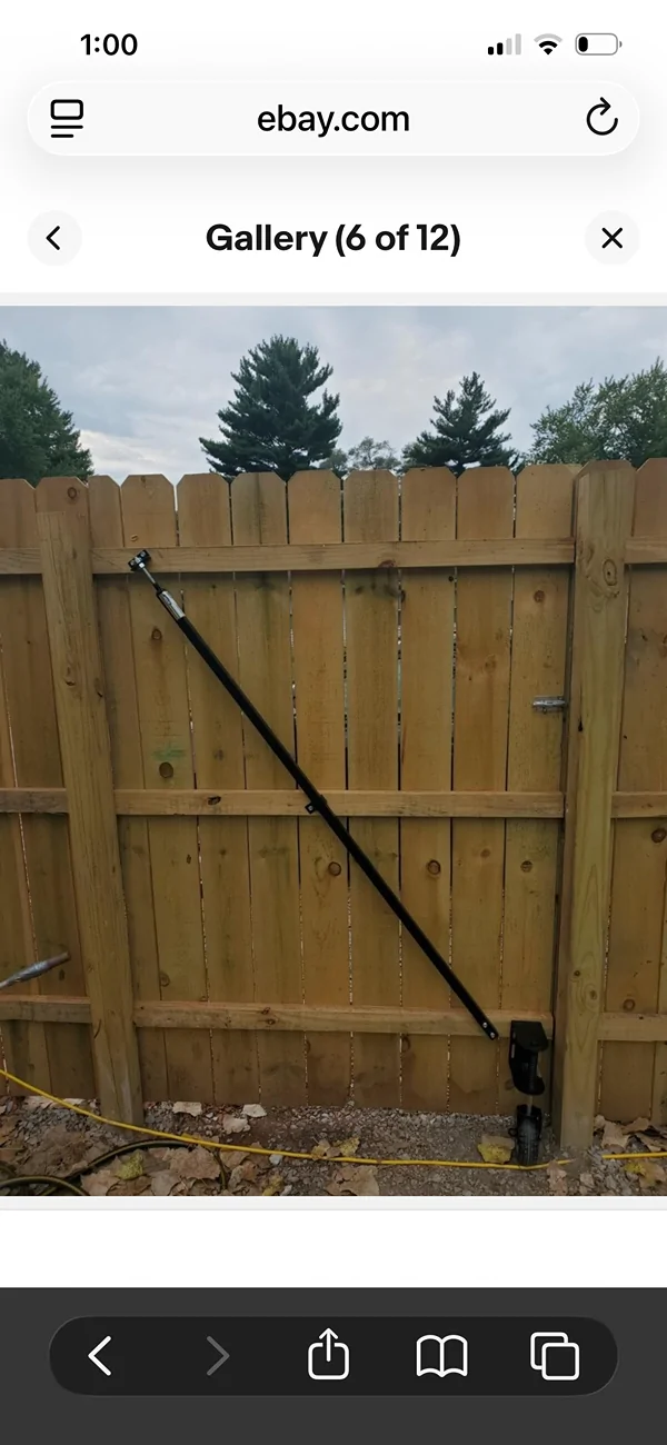

It will add some stability. Same concept as this:
Ford Bronco Tailgate "Reinforcement" IMG_2824

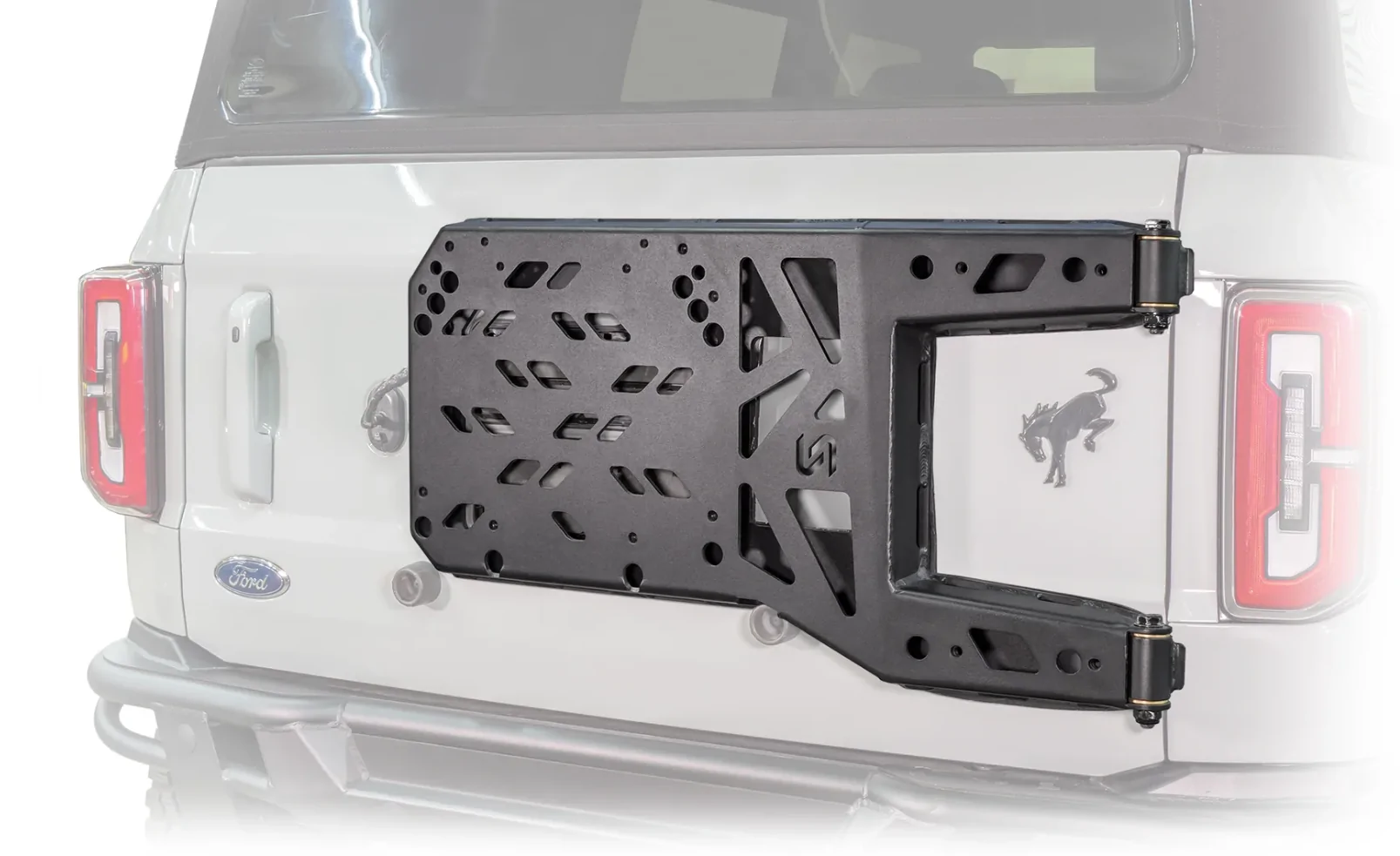

TOR does replace the hinge, but only by virtue that it's installing a new hinge built as part of a full steel frame to carry all the weight of the spare tire and any additional mounted equipment. Nothing mounted externally is carried by the aluminum tailgate any longer. The tailgate itself bolts to the backside of that frame - the frame carries all the weight of the spare (and anything you mount externally)
This entire piece is one solid chunk of welded steel, which bolts directly up to the frame brackets. The spare hangs from the back side, and the tailgate hangs from the front side.
Ford Bronco Tailgate "Reinforcement" 1766786479343-1
