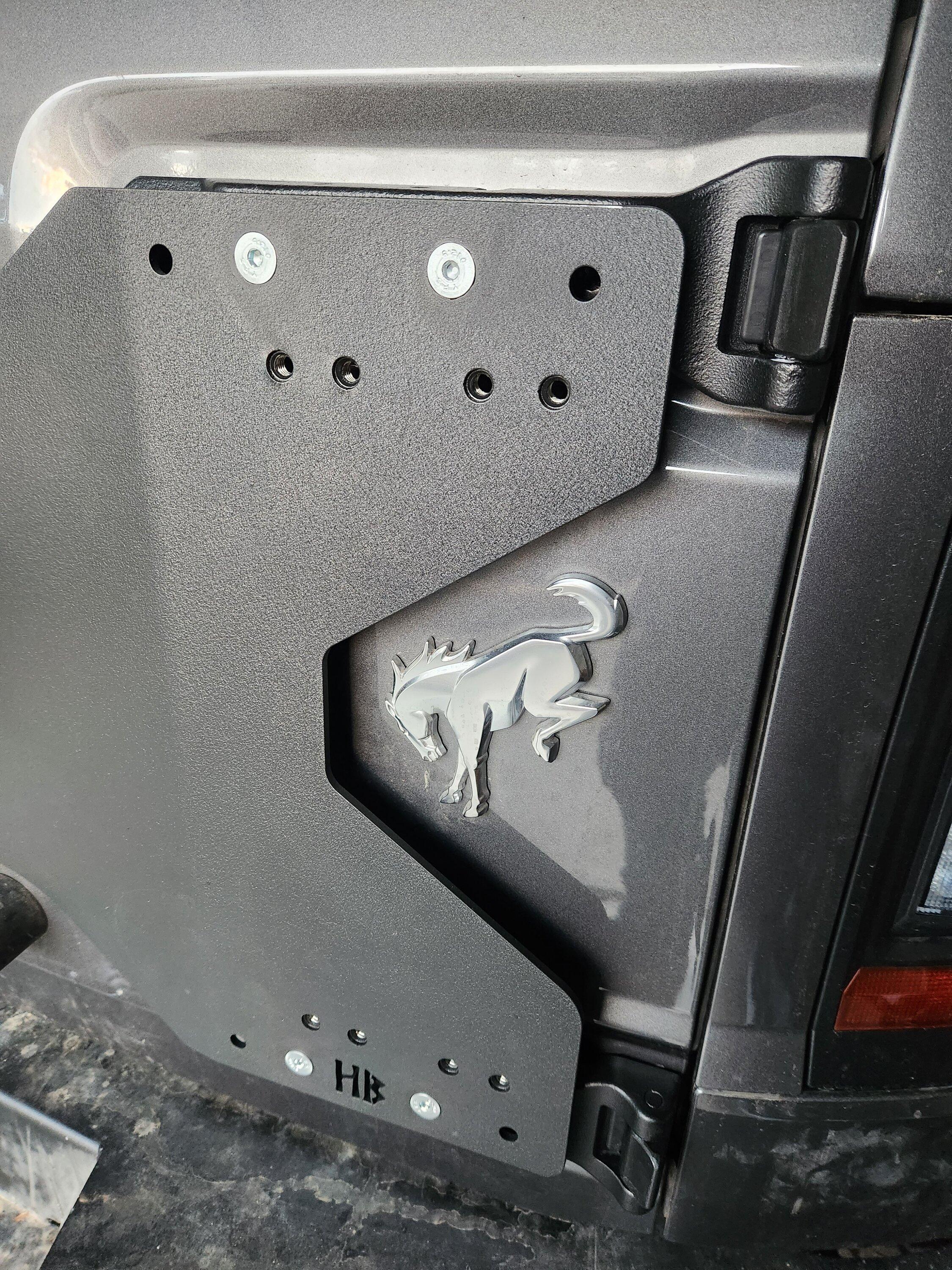

I replaced the the OEM hinges with the Raptor hinges which are much stronger and Hammer built makes a plate specifically for the Raptor hinges.

In one of my posts I have a step-by-step instruction guide with the part numbers. If you buy them from an online for vendor, they're about $195 each...but if you buy them at MSRP, then they're close to $300 each. I was thrilled to find the Tyson was willing to alter his existing brackets to work with the Raptor hinges, and with the measurements I was able to take he sent me the first prototype plate and it worked like a charm. Additionally, he tweaked the accessory arm a few degrees so that now an MFC carrier can be bolted to that and it's parallel with the spare tire tread surface.

If you're going to be carrying something crazy heavy on your tailgate then there's nothing better suited for the task then a stronger bumper with a swing out carrier...but for something close to the weight limit or slightly over the hammer built setup should work just fine. I even went overboard and countersunk the holes so I'd get no lateral movement.

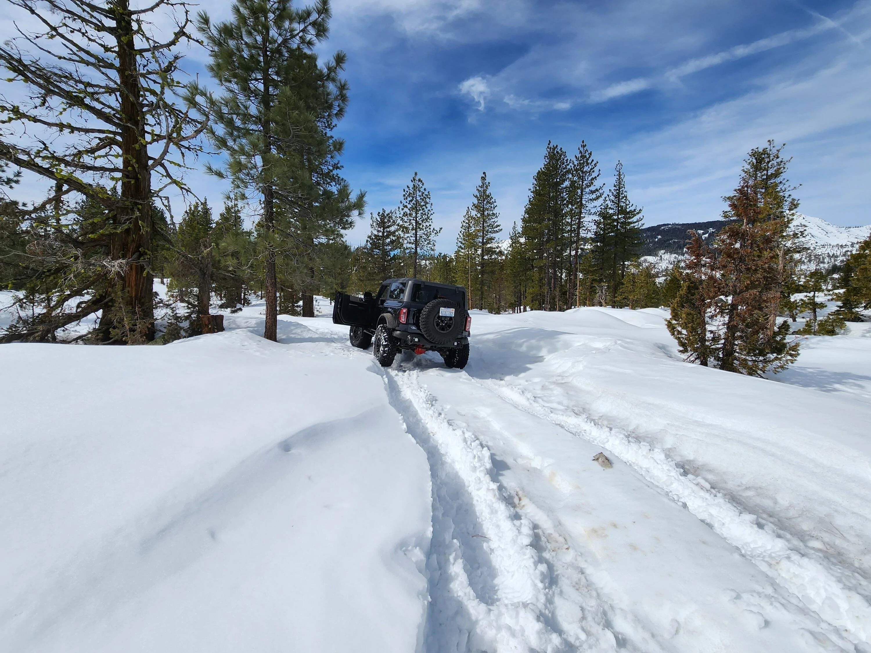

If your that worried don't go off road. Today's adventure.
