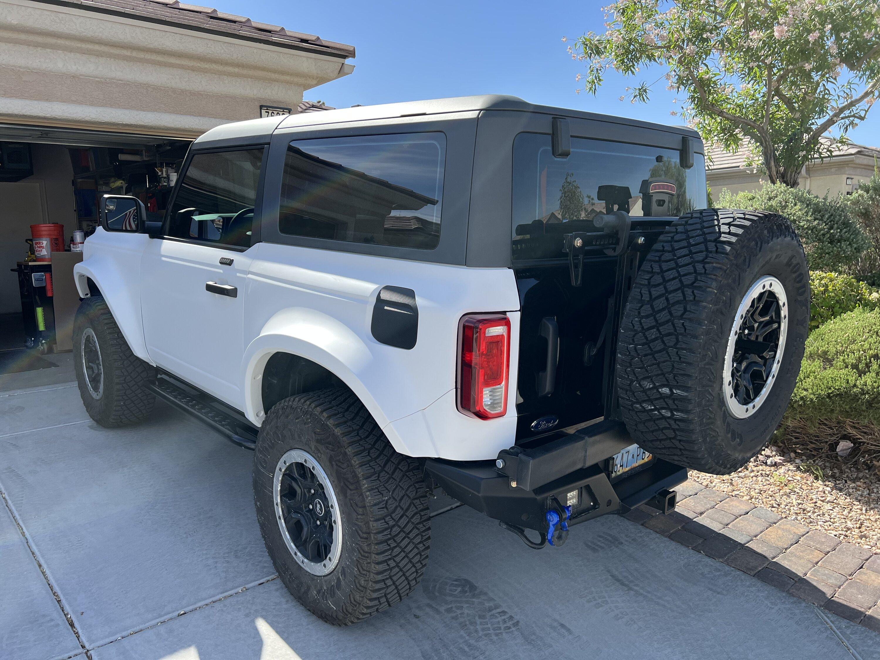

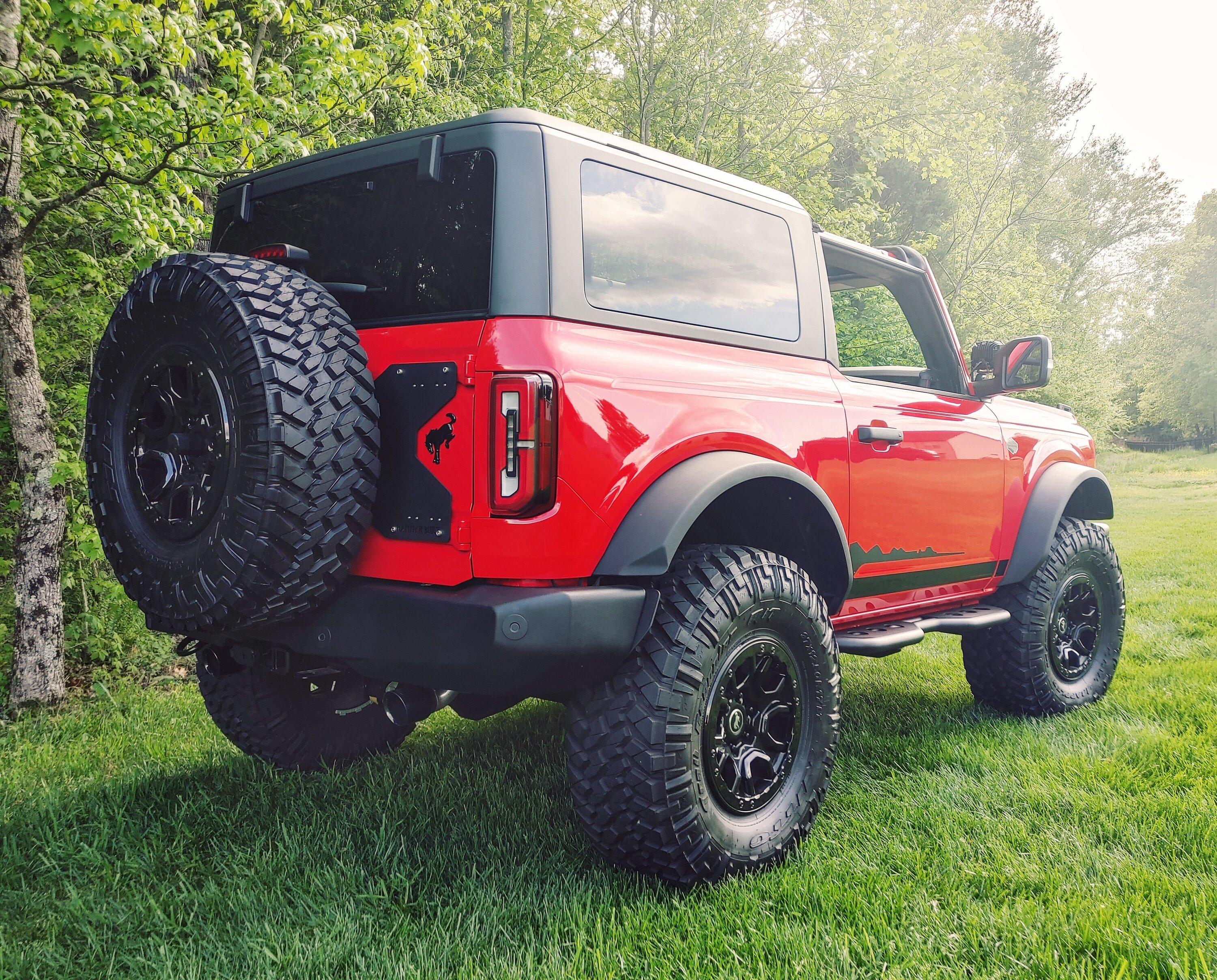

I went with Hammerbuilt with Raptor hinges.
Ford Bronco Any consensus on which tailgate reinforcement has performed best? 20230512_163950
Ford Bronco Any consensus on which tailgate reinforcement has performed best? 20230624_095425

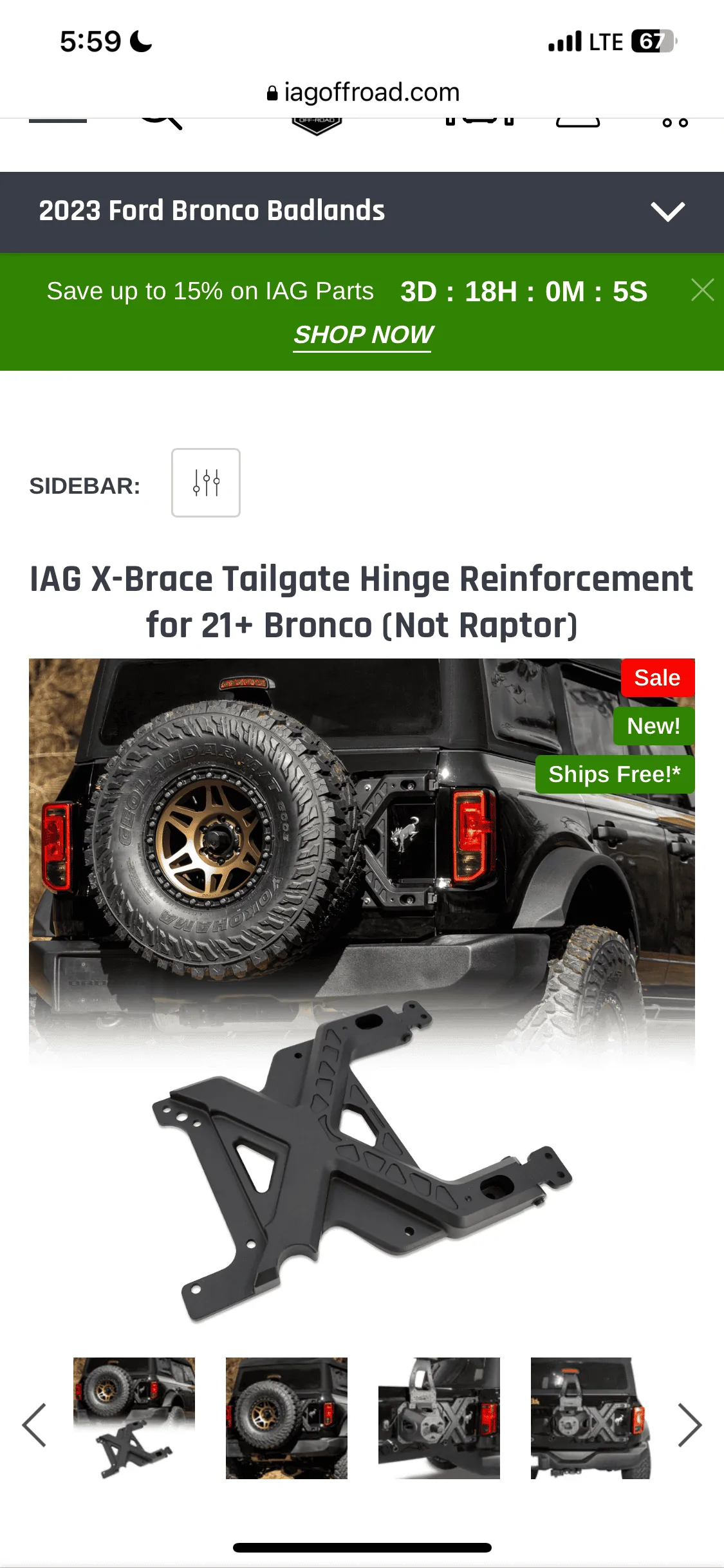

I went with IAG. I like their design. Instead of the tailgate taking the load of the tire, IAG replaces hinges to heavy duty allowing the brace to take the load of the tire and tailgate. Price was good too

Personal opinion here, but I won't be timorous because having any counter opinion must be silenced on these digital pages. It would be very difficult to put the IAG as a top performer due to the quizzical choice of using cast aluminum.
No doubt it will work when new, but cast aluminum is far too ductile, and is an extreme risk of stripped threads just by the materials used. You won't be chasing threads in cast aluminum.
