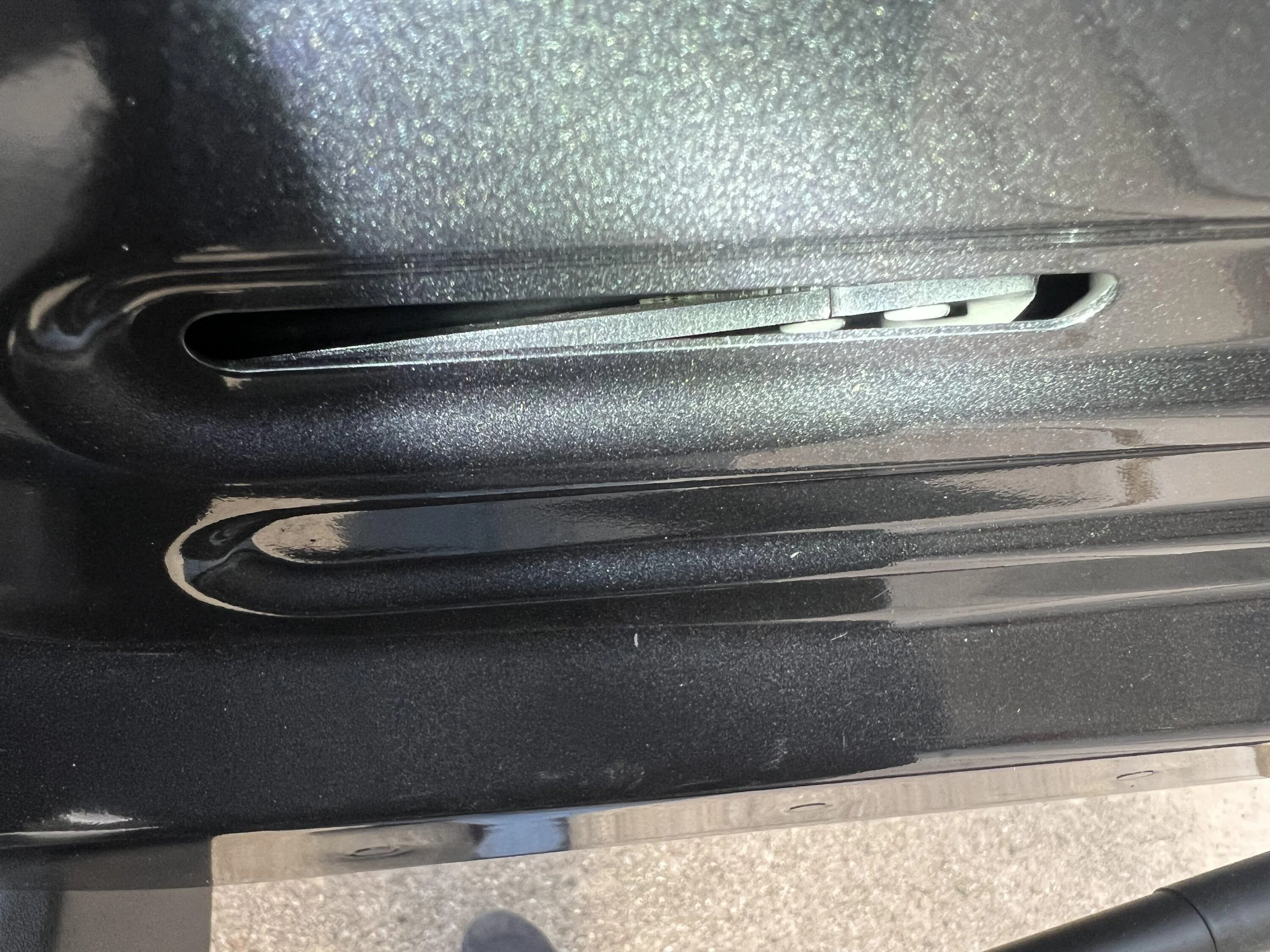

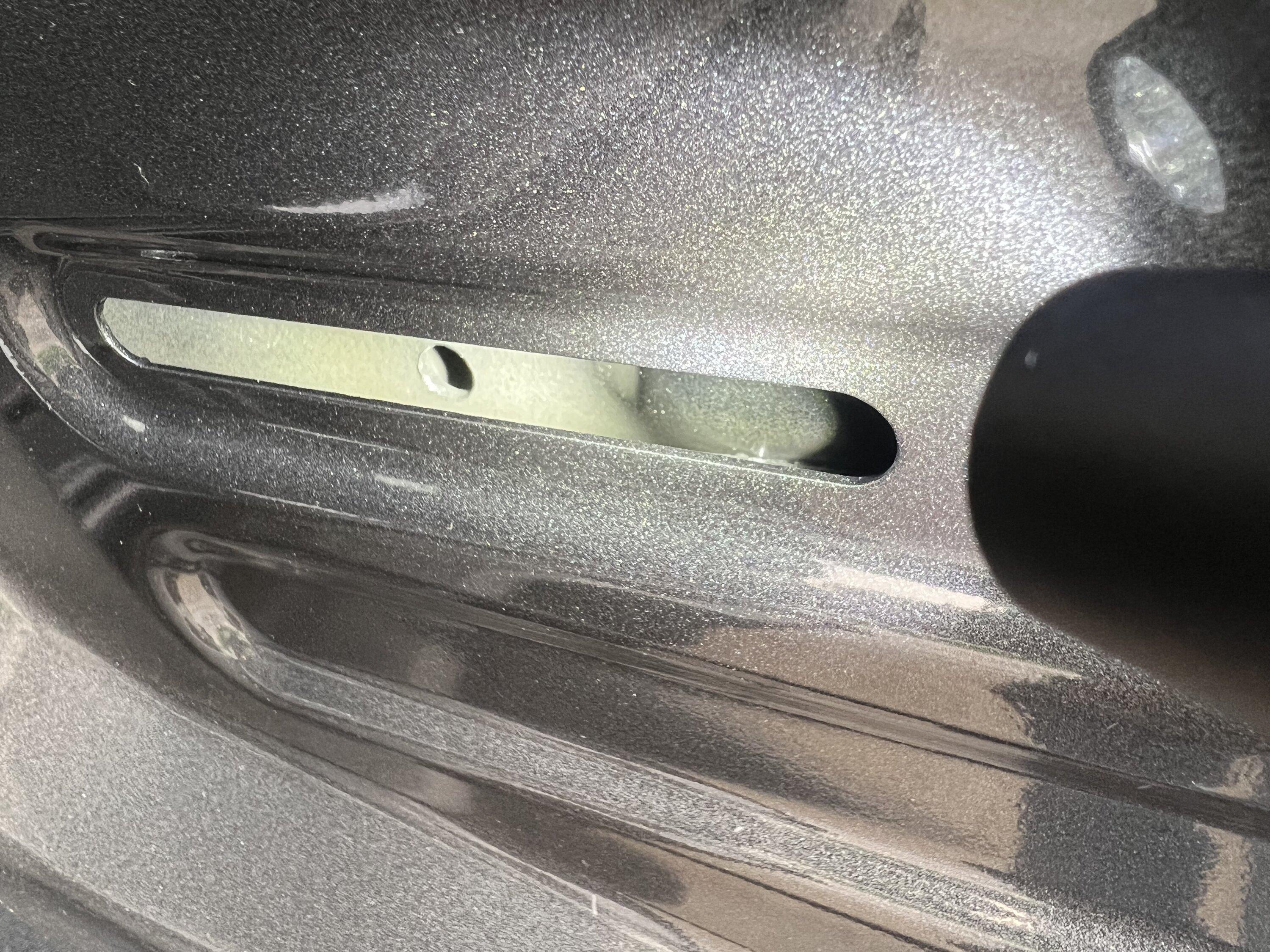

Finally took the spare tire off and drove it around, tapping went away. Drove with both the glass up and down and tapping didn’t come back. So the tire is causing the tapping. It seems as if the weight of the tire is putting some type of strain on the hinge where the inner nut plate (bracket) is located. In the pic below you can see one of the bolts that attached the hinge to the tailgate. Sprayed this with silicone spray and tried to aim for the inner one closest to the bronco.

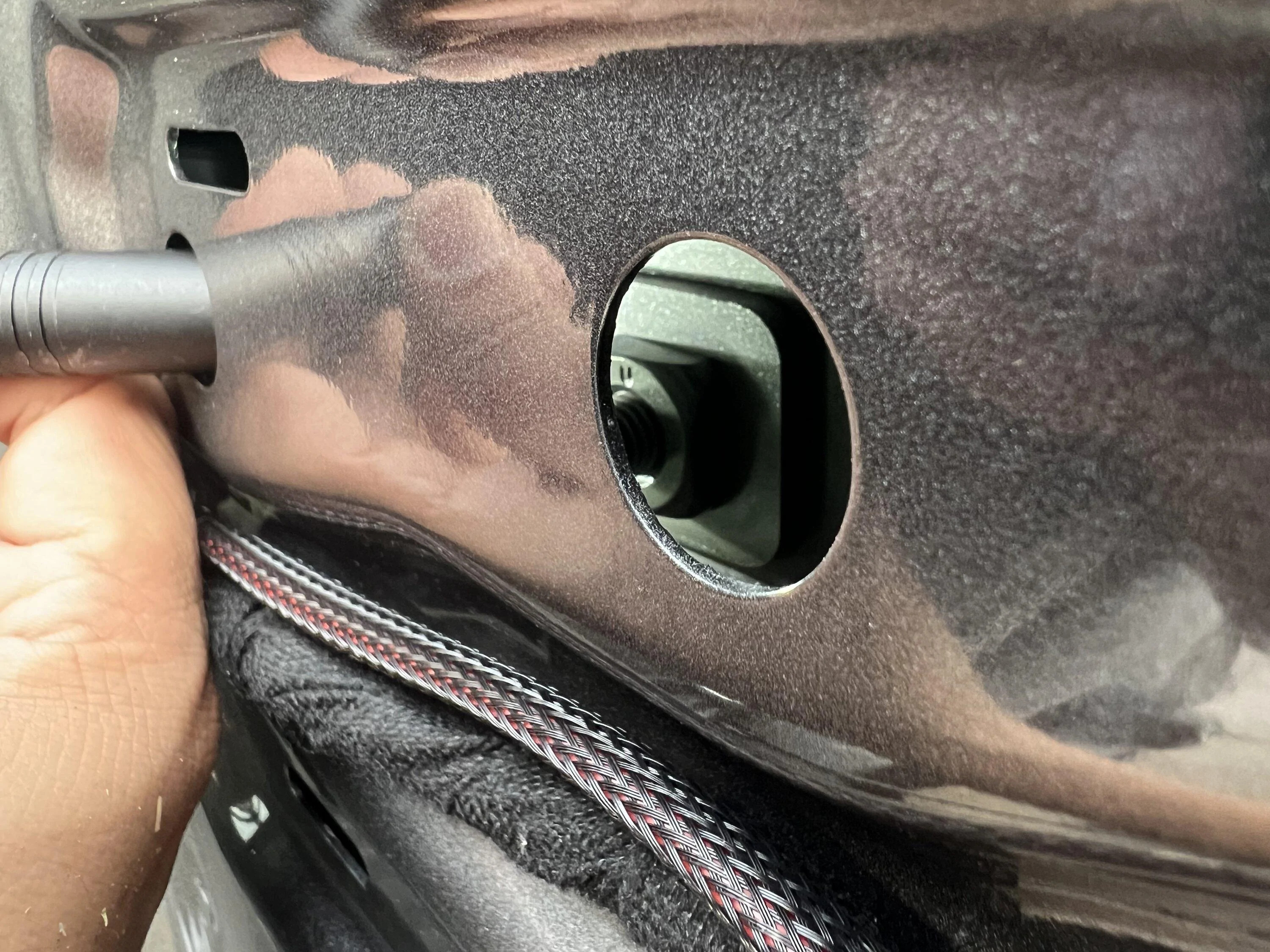

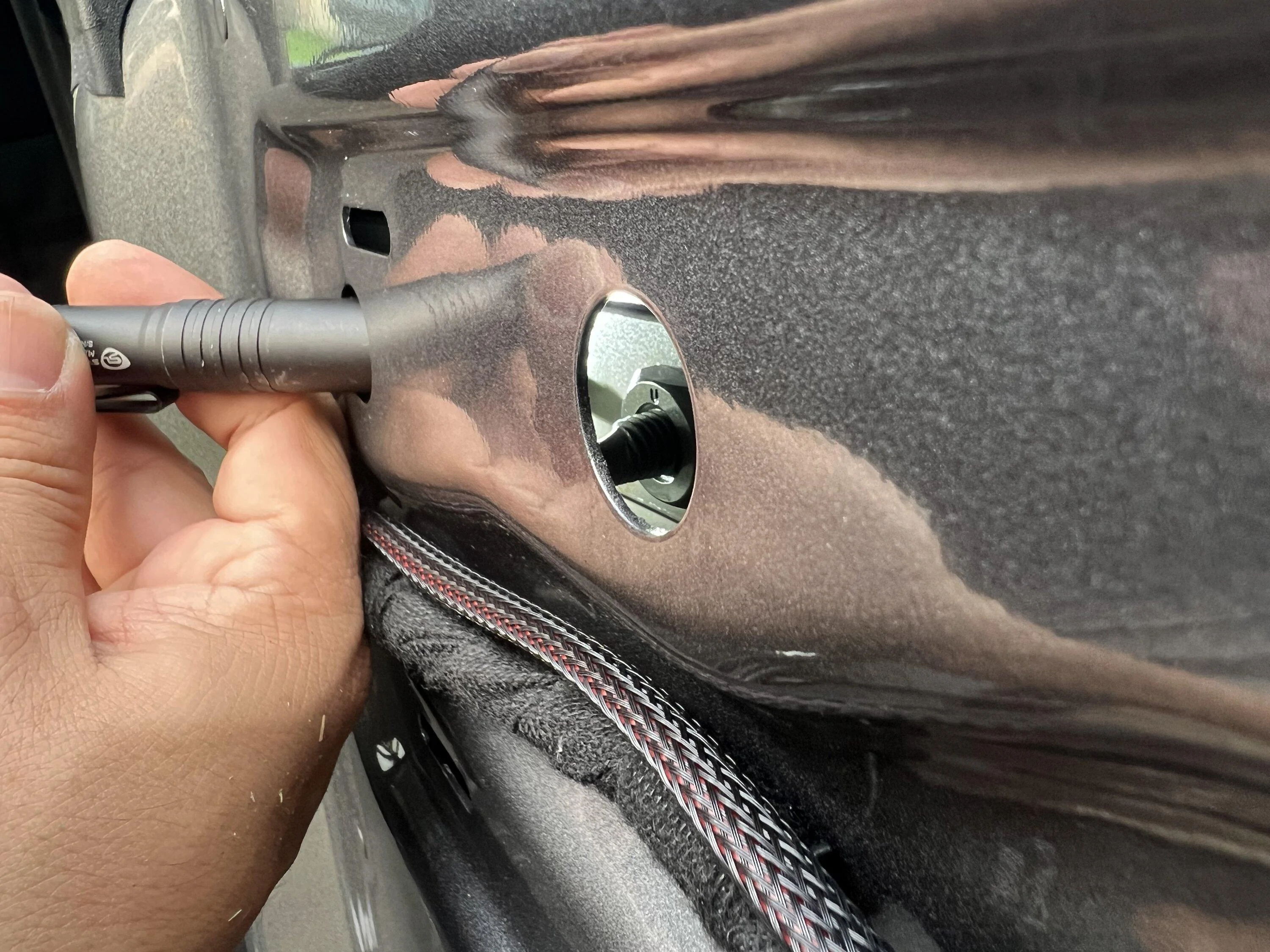

And then for the lower hinge you can’t really see it, I think there’s another wall inside the tailgate. But I stuck The nozzle in this hole and sprayed to both sides.

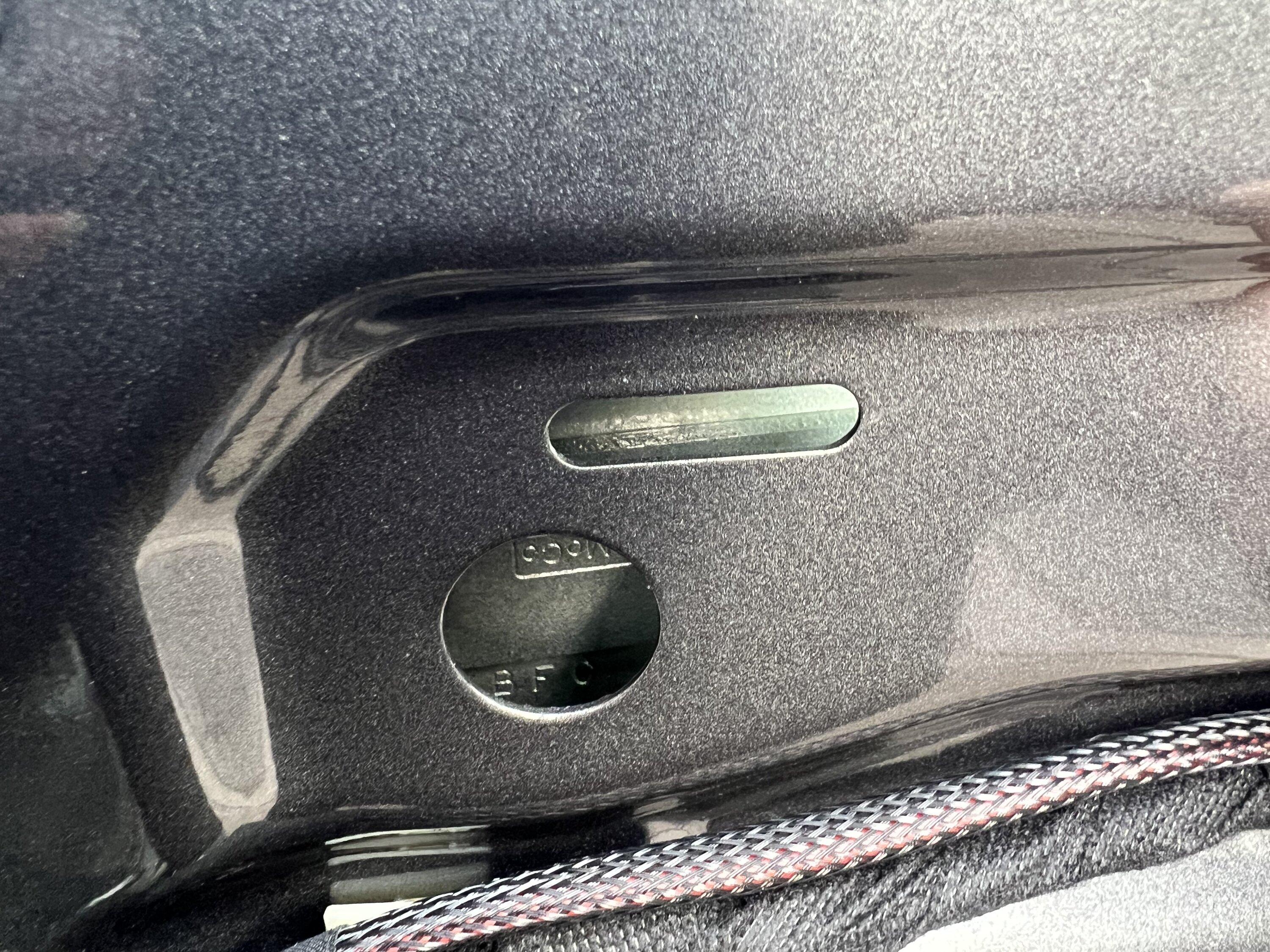

And if you look more to the right of that hole and closer to the inside of the tailgate you’ll see this bracket. Sprayed there too.
