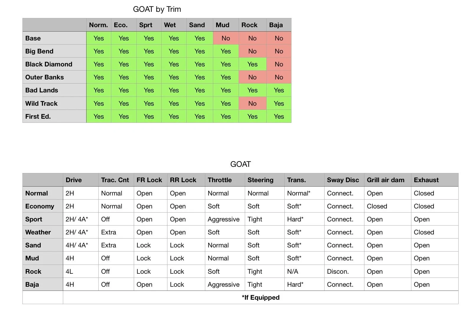

Think I answered my own question, or solved my want anyways, at least if this diagram is accurate
Ford Bronco Tazer style programmer? DE4DE615-87A0-4FD1-896E-226DB65122C8

I don't think those are accurate
I don't think sport mode disables traction control, it may reduce it, but doesn't totally disable it
Also from what I have seen Badlands doesn't have sport mode

I want to say these were derived from the raptor. Just hoping the mud and sand modes are similar.

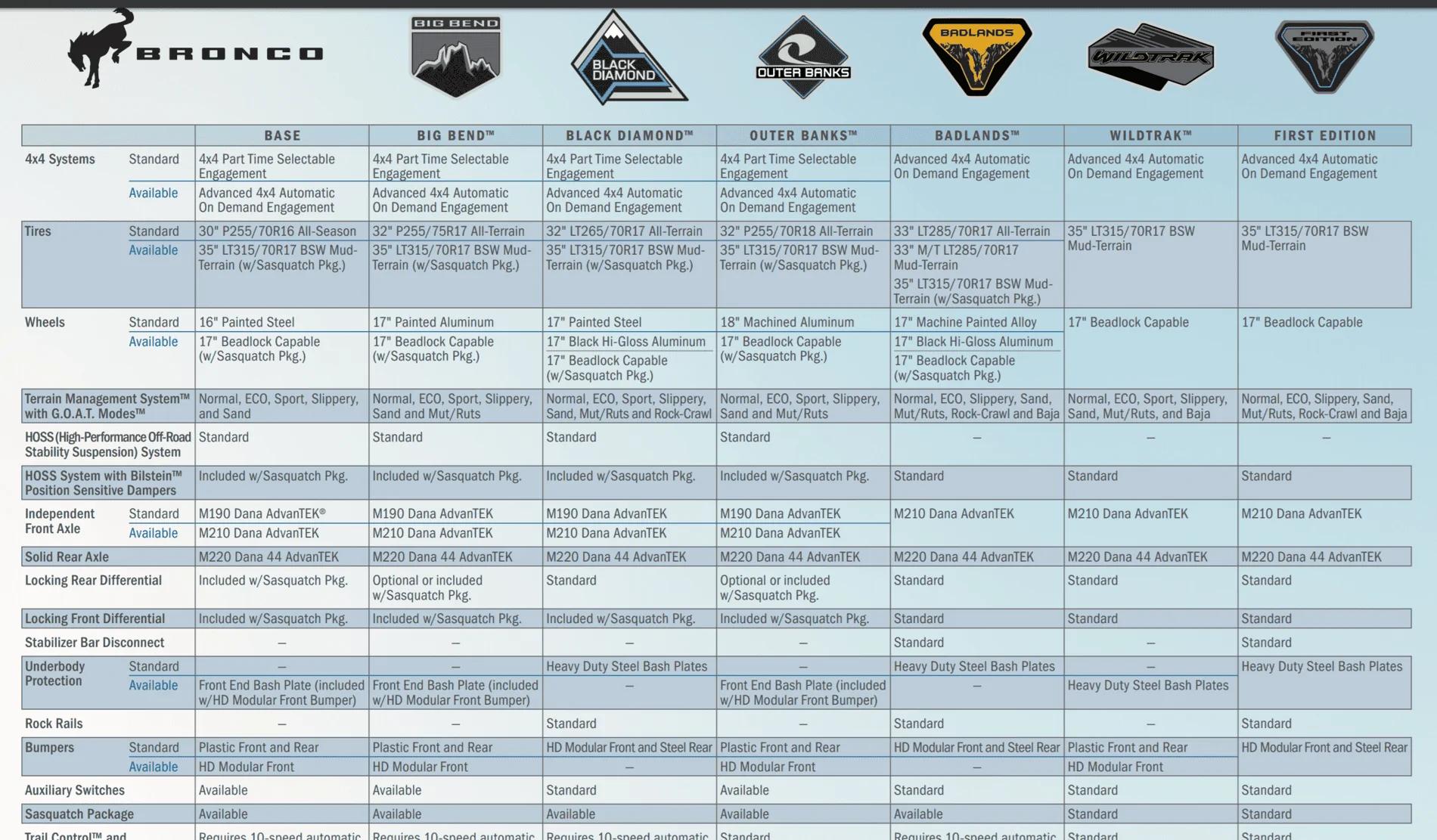

from what I read if your Bronco is equipped with lockers they are activated independently of the Goat modes. Each locker has a button on the dash
Ford Bronco Tazer style programmer? Screenshot (1)
I was more referring to using the lockers in 2h & 4h. If it’s anything like Jeep, the lockers are only accessible in 4L on stock programming. The Tazer lets you circumvent that.

Interesting that it shows in "Rock" mode that sway bar is "disconnected" and doesn't have the "*" to indicated "If equipped" . Considering Black Diamond has Rock mode this doesn't seem accurate.

From what I was told this is from the Raptor.
