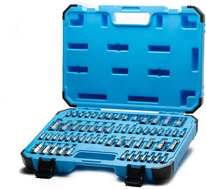

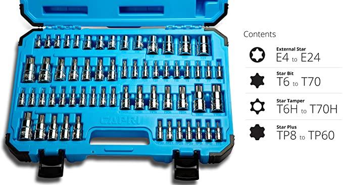

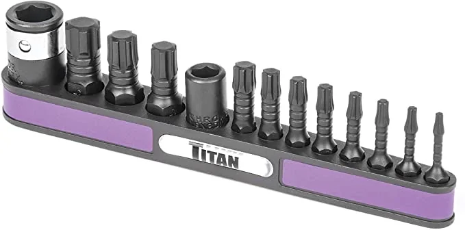

Just an FYI for anyone planning on working on their bronco with the Torx bolts on it.
They are a mix of Torx and Torx PLUS. Torx PLUS is not the same as Torx even though they are the same size.
Take off your beauty rings with a T45 Torx bit and you risk stripping them at worst and frustration with the bit "camming out" at best.
Wheel trim rings are regular Torx. Bronco bolts are Torx+
I talked to TWO different auto parts stores. The individuals I talked to had never heard of Torx PLUS and assured me that Torx bits would work fine.
$24 to me is a cheap investment to make sure you have the right tools for the job: https://smile.amazon.com/Neiko-10086A-Tp8-Steel-Socket/dp/B004UC9WJE/
Apologize if this posts belongs somewhere else but I feel like it should be more prominently displayed if it is somewhere else.
