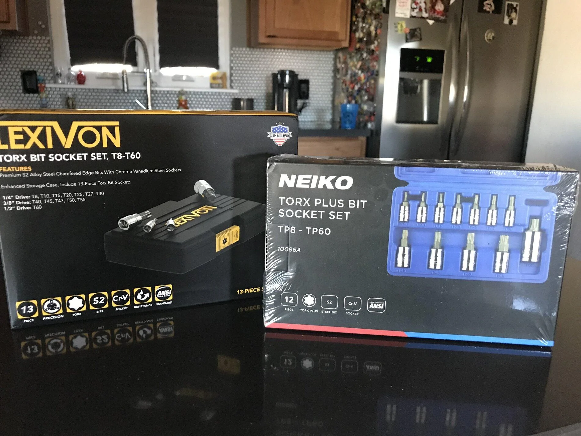

Just an FYI for anyone planning on working on their bronco with the Torx bolts on it.
They are Torx PLUS. Torx PLUS is not the same as Torx even though they are the same size.
Take off your beauty rings with a T45 Torx bit and you risk stripping them at worst and frustration with the bit "camming out" at best.
I talked to TWO different auto parts stores. The individuals I talked to had never heard of Torx PLUS and assured me that Torx bits would work fine.
$24 to me is a cheap investment to make sure you have the right tools for the job: https://smile.amazon.com/Neiko-10086A-Tp8-Steel-Socket/dp/B004UC9WJE/
Apologize if this posts belongs somewhere else but I feel like it should be more prominently displayed if it is somewhere else.
