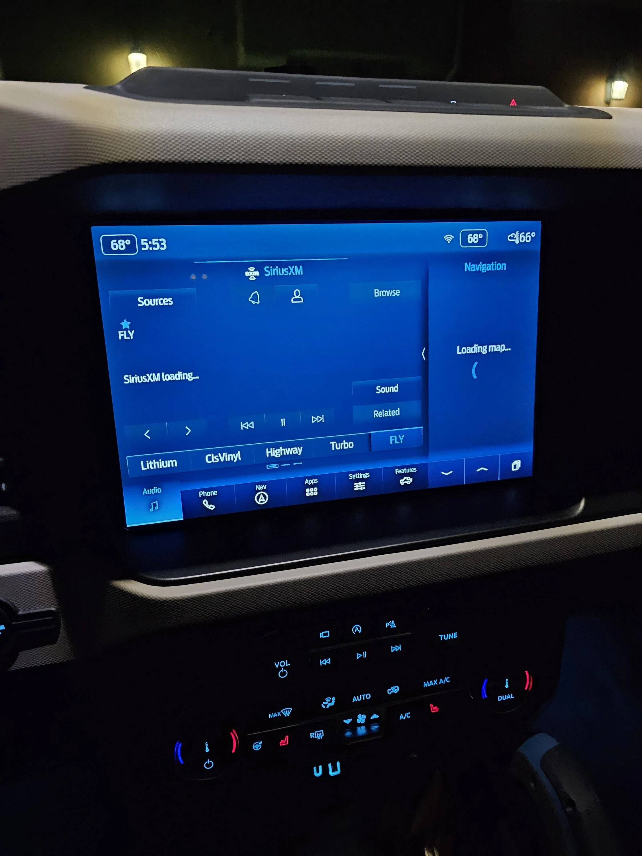

I just started having this issue with my 2022 Wildtrak. Freezes, wont swith to backup camera or won't shut off when I turn off the Bronco. Picture here is after 4min of having vehicle off and door opened. The rest of the vehicle was off. Of course it happens randomly...probably won't replicate for dealer.

Took my 2022 to the dealer...they did some stuff...and still having intermittent issues with infotainment system freezing or not turning on at all. Frustrating to pay so much for a vehicle and have it do this...
