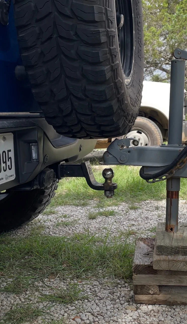

This is what a normal length hitch looks like under the spare. I think this one’s a 3 or 3.5” inch drop. I ended up having to get more drop (shown above) for my other trailer. Also notice how close the tongue jack is to the spare. It will tow the trailer just fine. Do not be tempted to load it so it’s not tongue heavy. You need to be tongue heavy so it does not sway. At least 10% of trailer weight on the ball. It’s gonna squat your bronco, but it won’t mind.
