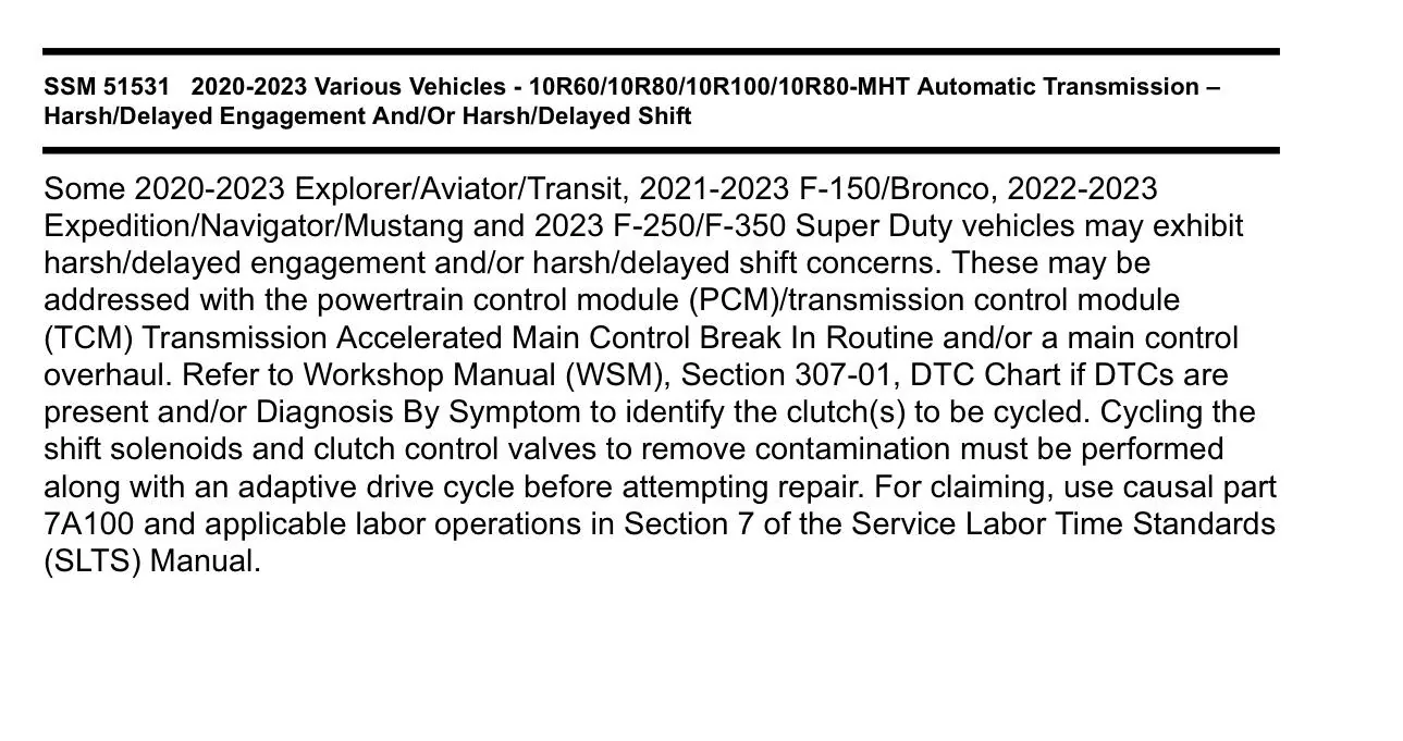

Accelerated main control break in followed by clearing the adaptive transmission learning. I always have very good luck with this curing most intermittent weird shifts with 10 speeds.
Ask the dealership about SSM 51531

Here you go, this should help.
Ford Bronco Transmission issues IMG_1087
