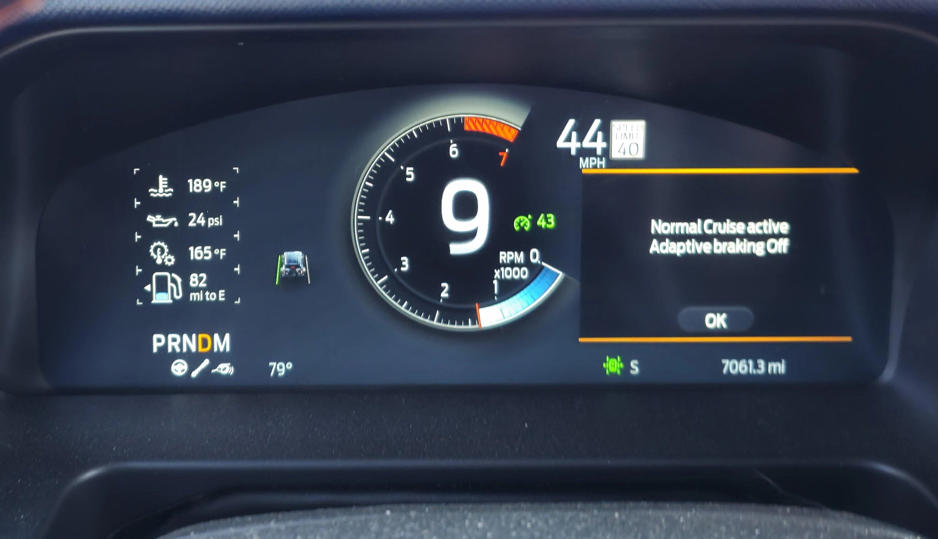

The adaptive cruise has stopped working and it defaults to normal cruise control. Anybody see this before? Pic for detail

aluminum potato chip bag covering the chin mounted sensor?
JK.
see page 258 of the owner's manual for instructions to swap between adaptive and normal cruise control

Thank you. Somehow the setting must have been turned off when I was playing with AsBuilt values and I was fearing the worst.
