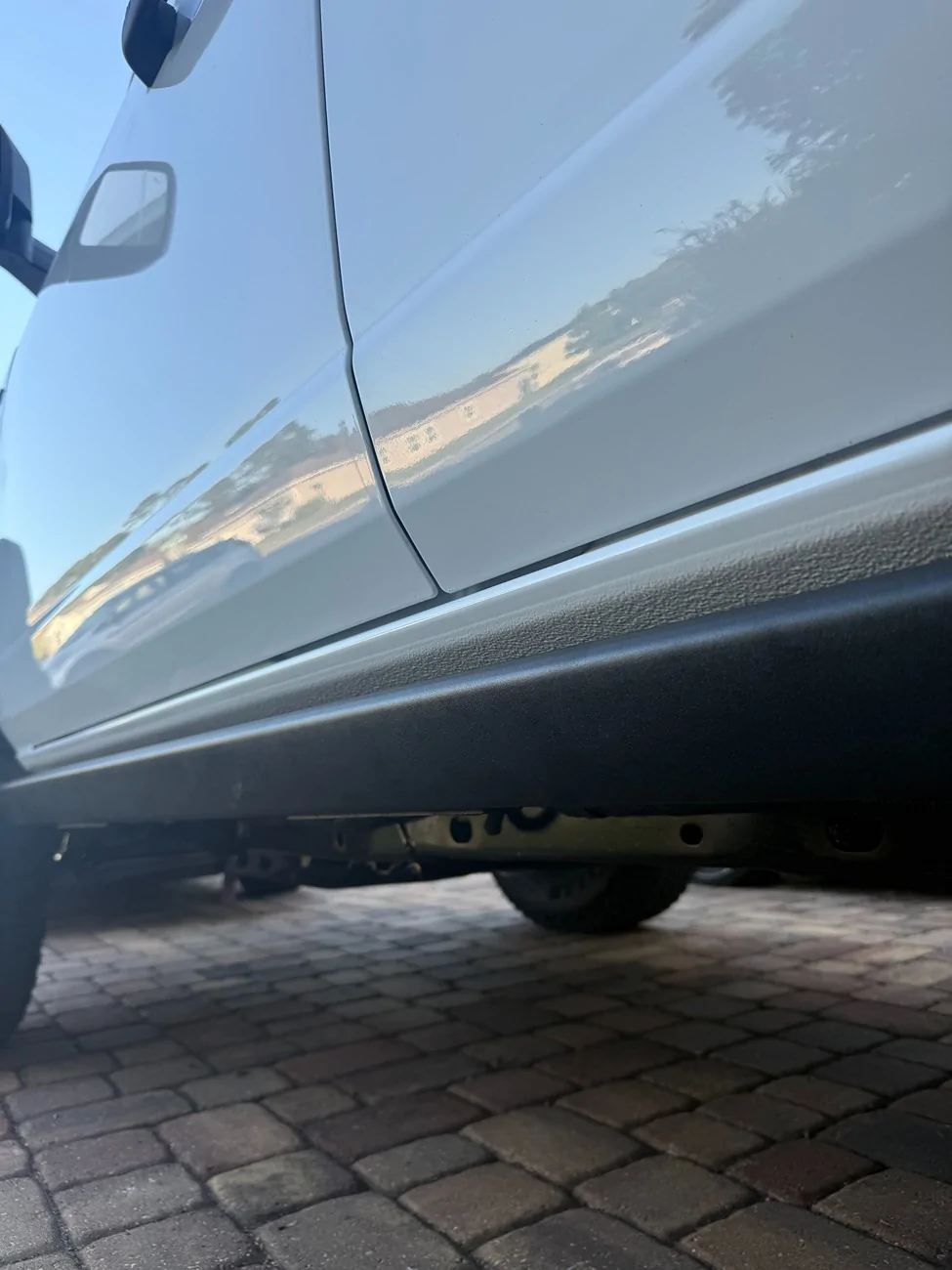

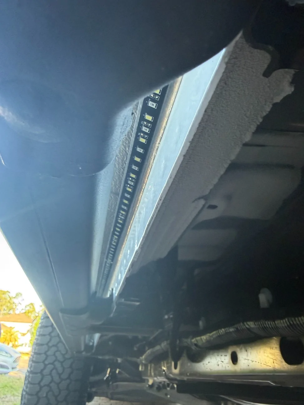

Hey Doc, they are mounted to the outer side of the pinch welds using the 3M that comes pre-installed and behind the factory rock-sliders. if you don't have room for that due to aftermarket sliders you can use the frame rails.
