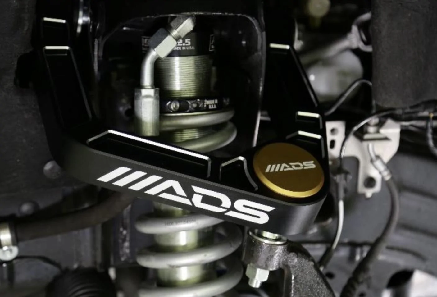

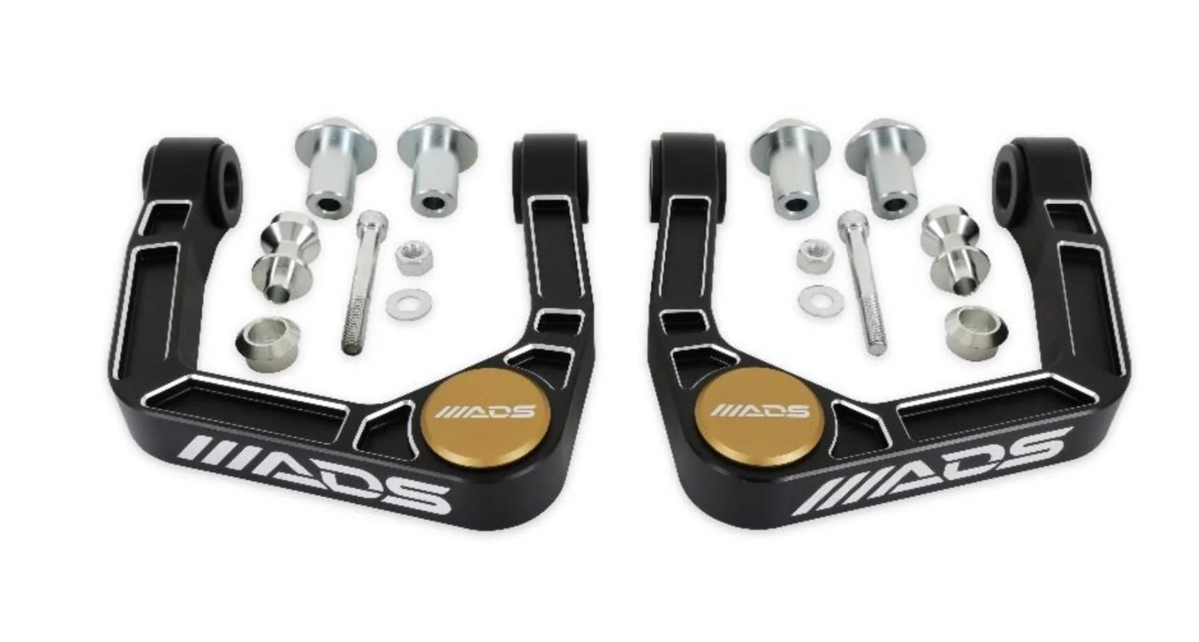

Typically the billet arms are stronger than most of the fabricated arms. This isn't hard and fast rule but applies to most. The fabricated ones you listed have a factory style ball joint and will likely wear faster and won't provide as much articulation. Short of them possibly correcting some of the angles in the design, I don't see much of an advantage to that arm. We have been running our factory arms while we waited for ADS to release their billet arms. We will also make some higher quality fabricated arms as well.
The ADS arms do correct caster and camber in the design and have a standard uniball that is easily sourced for rebuilding when needed.

Hi would you recommend these ADS over the icon billet delta joint pro?
Shifts And Grins Fab
Base Sponsor (Level 1)
Ryan
Feb 8, 2023
259
474
Gilbert AZ
shiftsandgrinsfabrication.com
2023 Badlands, 2022 Bronco Wildtrak Sas
Yes. Based on what I've seen from Icon I’m not at all impressed. I am in other areas outside of Bronco and there has been a ton of issues with Icon. The materials and hardware used is hands down better with ADS.
