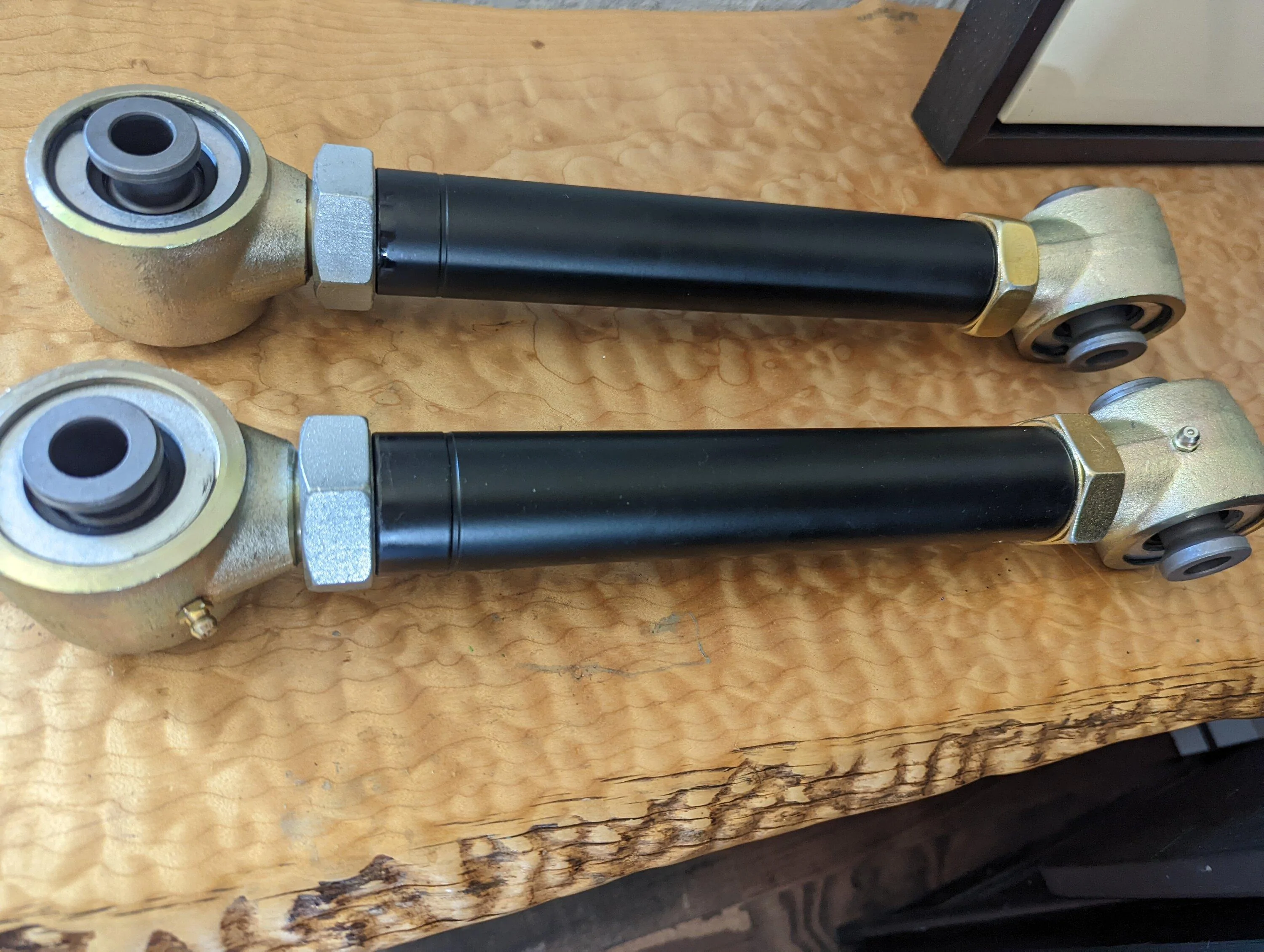

Anything more than 1.5 inches, you should technically be changing the UCAs. Anything lower and assuming you are using 35s and NOT 37s, then the stock UCAs are just fine and are actually designed very, very well on the Bronco. As most have specified here, IF you have to add the UCAs, seeing as you are above 3 inches on lift - ICONs are the best for price point and joint quality.
Personally, I have gotten the Eibach Pro Lift kit (springs ONLY). This is about a 1-inch lift. I'm retaining my stock UCAs and then adding - Rear Trailing links (https://www.rockjock4x4.com/RJ-182400-101) and an Icon Track Bar (https://www.polyperformance.com/icon-21-ford-bronco-rear-adjustable-track-bar-kit).
Sometime next year, if I decide to go full Coilover setup, then I will upgrade my UCAs as well.

I am running the Icon Tubular arms and they are great, and would definitely recommend with the Eibachs. At full droop even the Icon 1.25" delta joint is almost maxed out so you are definitely limiting droop travel with the stock arm. It probably will not hurt anything but you probably are leaving an appreciable amount of travel and articulation on the table when using the stock arms. Another one I would definitely recommend considering are SPCs. They have separate camber and caster adjustment and have almost as much range of motion at the joint as the Icon, which is substantially more than just about any ball joint or uniball arm. I was really interested in trying the SPCs to max out negative camber on the upper and try to correct for it on the lower to shorten the effective distance between the diff output and the hub and try and fix the issue of the stock CV axle being a touch short.
