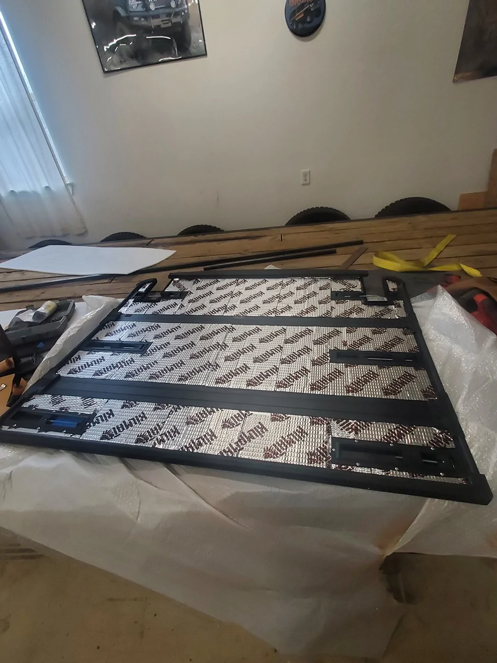

Got the rear foam done....
Starting on the bed insert

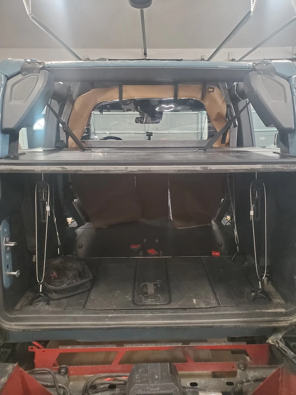

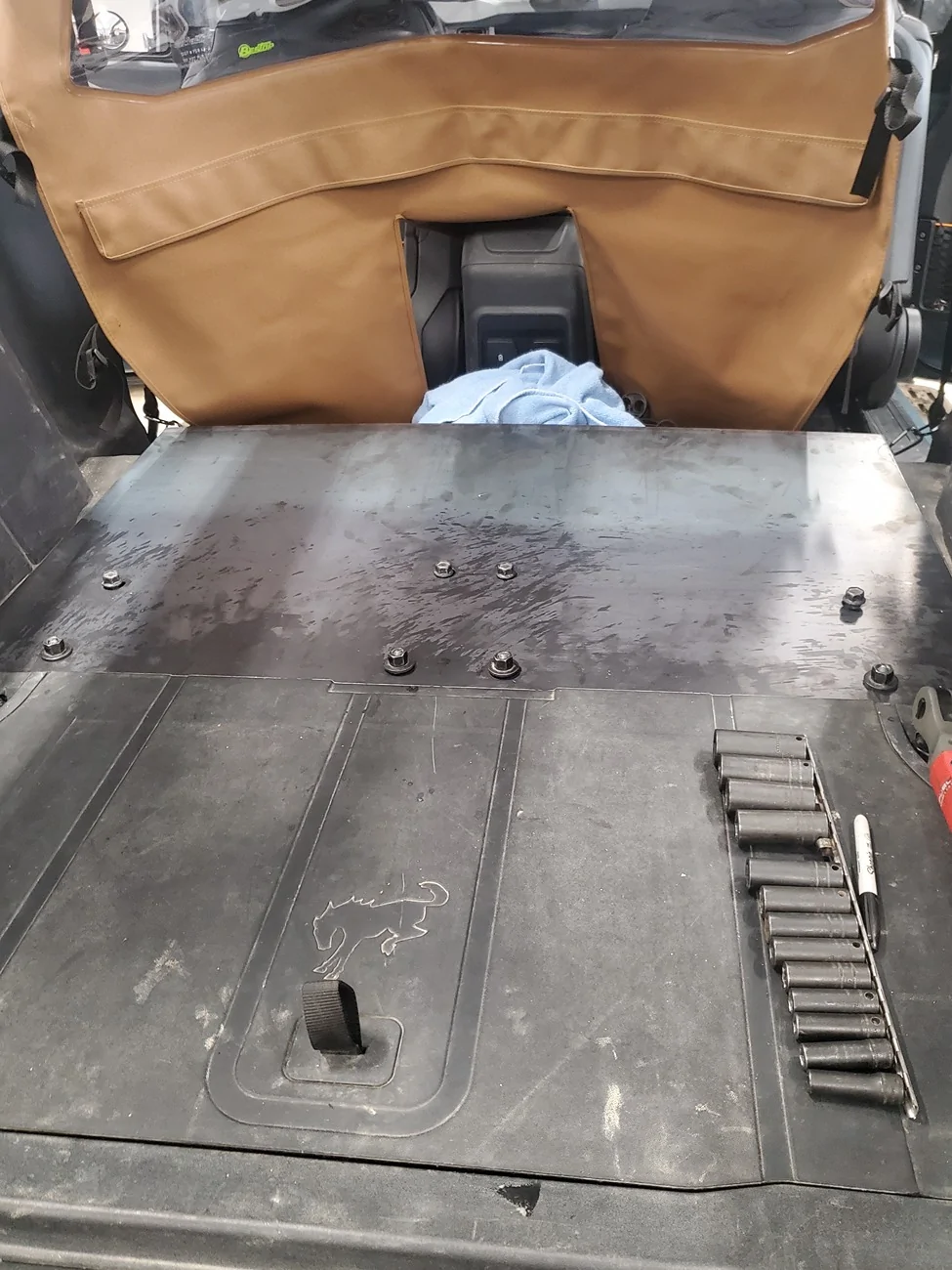

Not much done today, had to put a battery in the HEEP and make wires to plug in a tricklecharger on it.
Finished some holes in the bed plate.

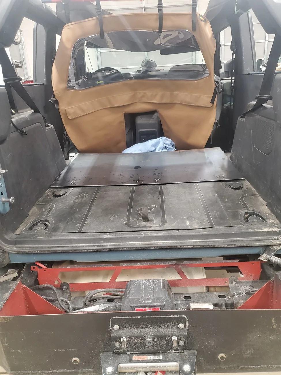

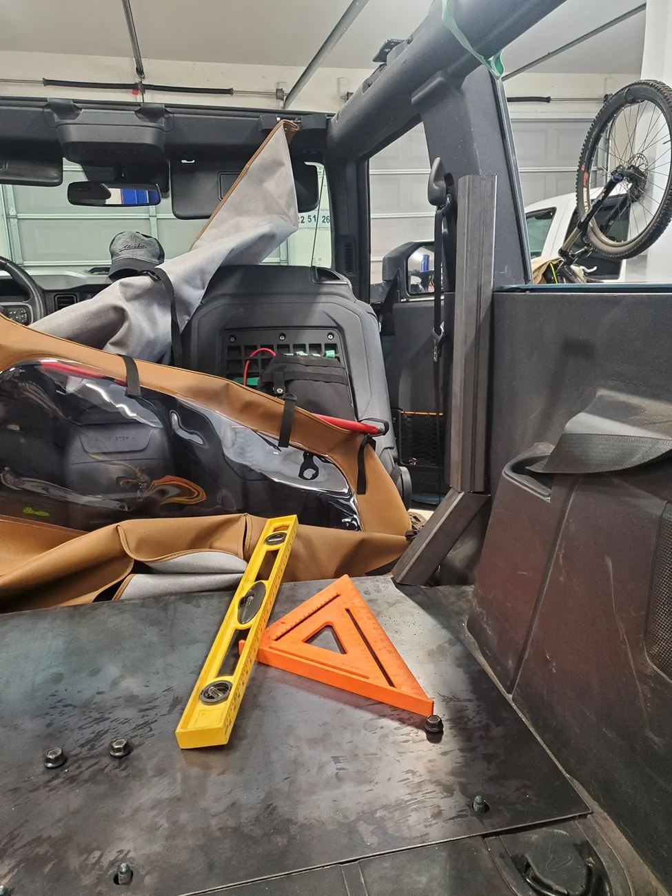

Got the holes done started cutting pipe. This gives the idea of my plan.

This is so going to work!!! Some bending then decide if I'm srewing it on or making a piece!!

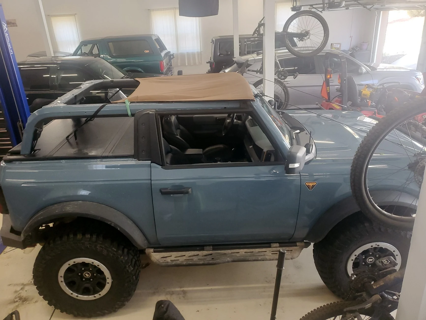

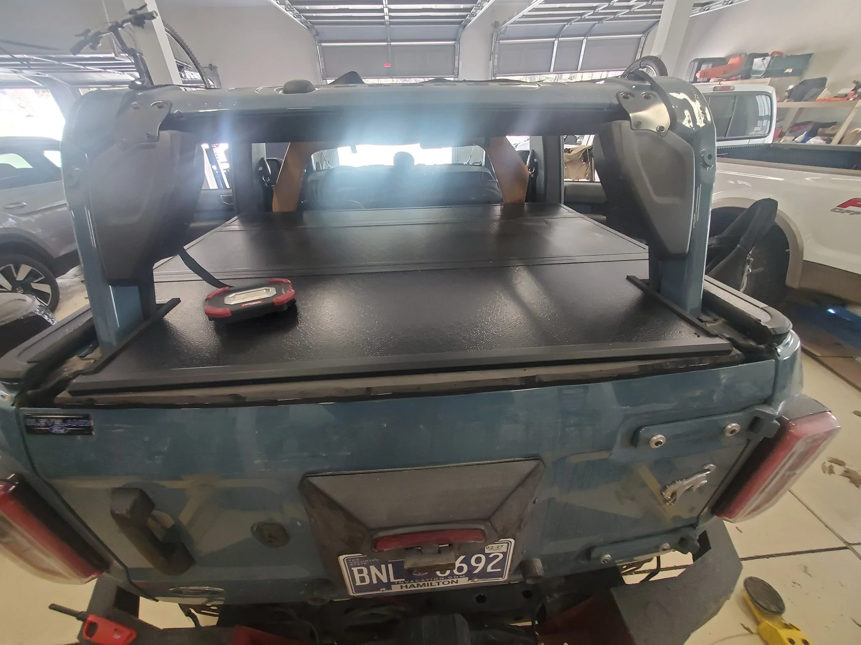

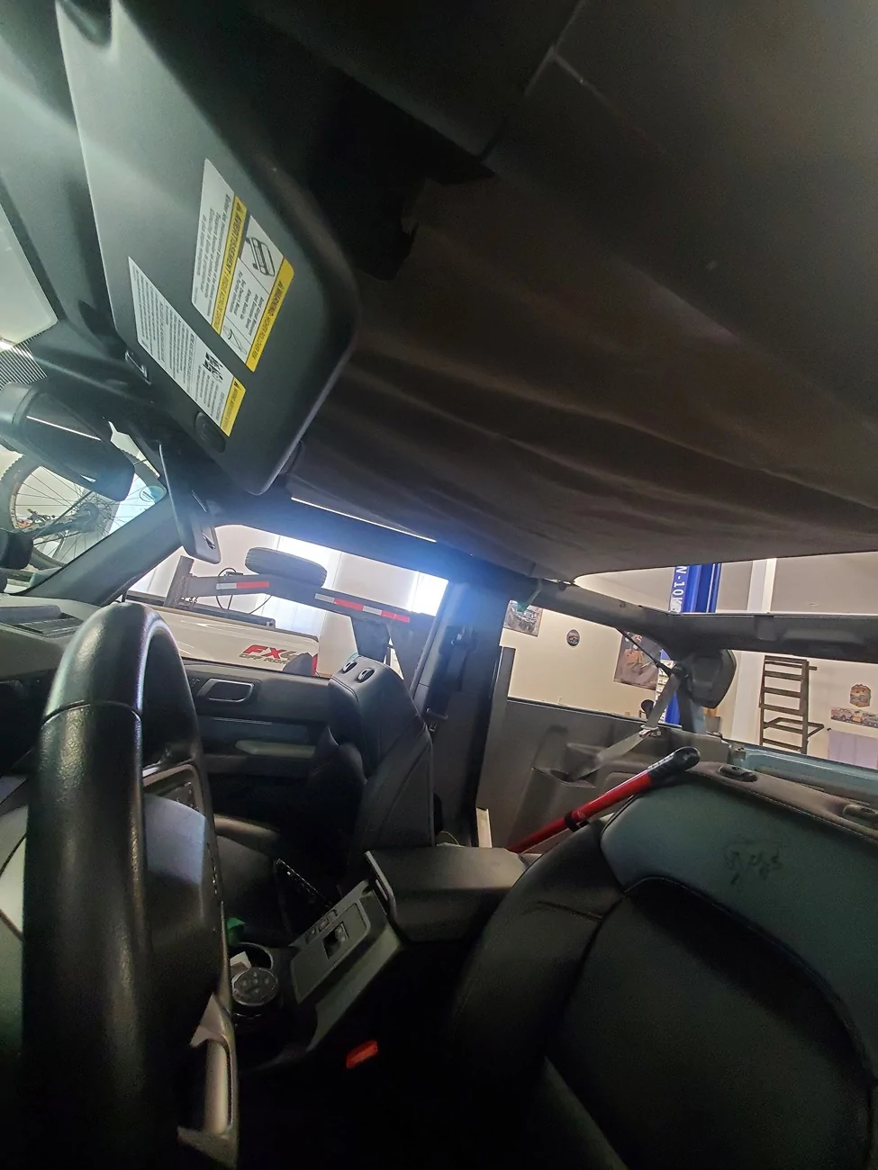

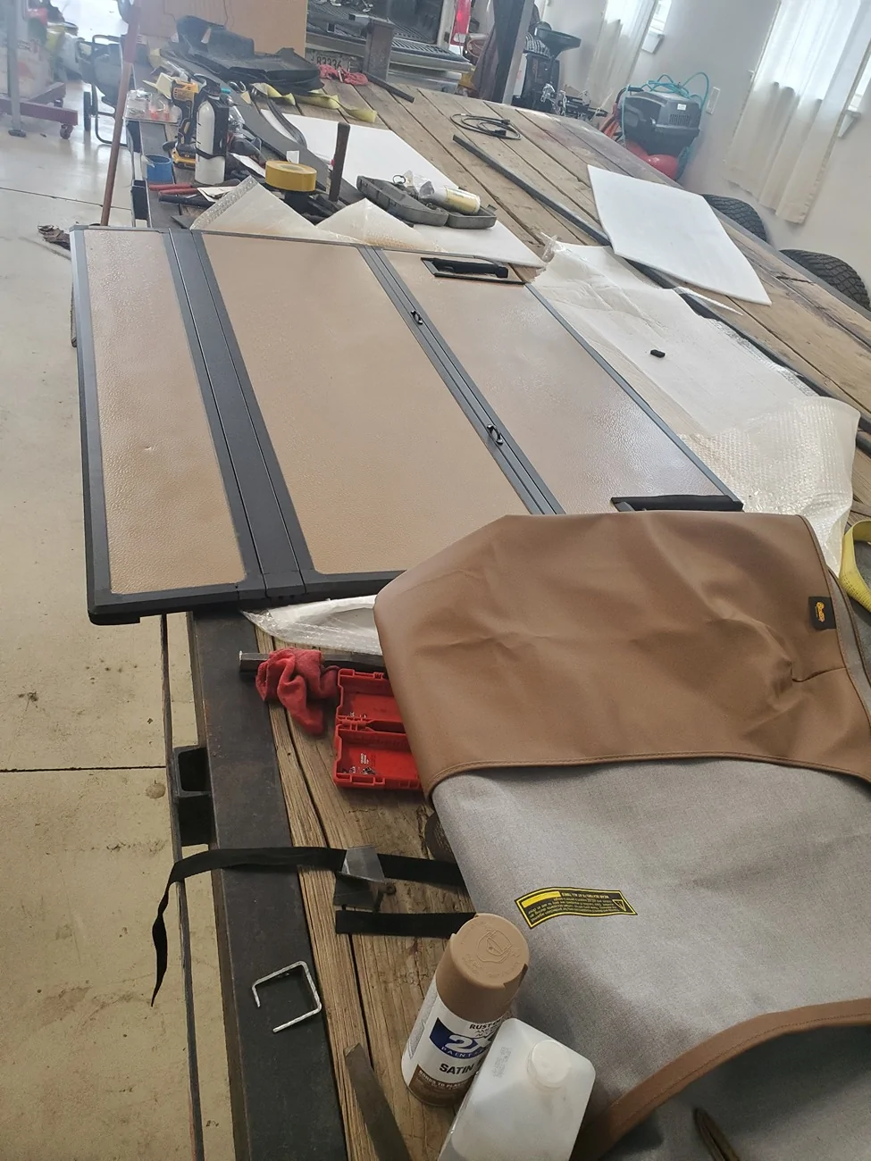

More done on the bikini
Ford Bronco Valhalla's Long term build thread 20260220_141624

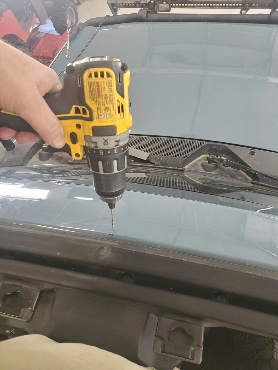

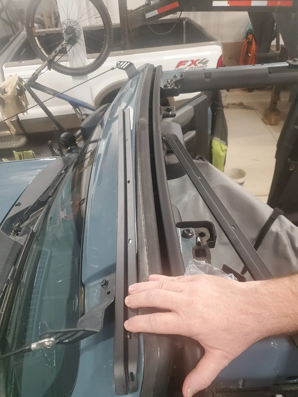

I literally had to have a beer before I drilled holes in my windshield frame so I could do what I really wanted with my truck.
Ford Bronco Valhalla's Long term build thread 20260220_121825
Looks good I'll have to see how it is at speed. This is just the fit process. I'll be securing the straps to the bed cover.
Ford Bronco Valhalla's Long term build thread 20260220_141503

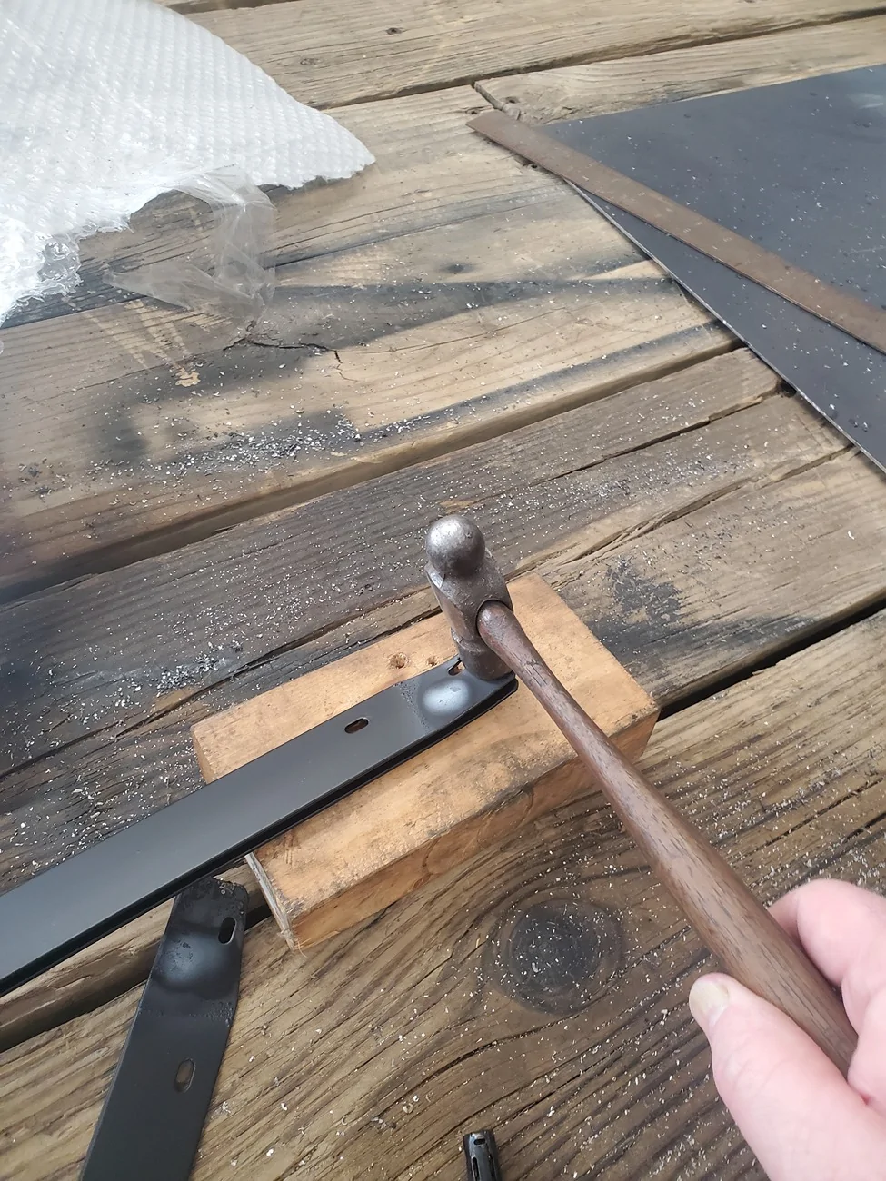

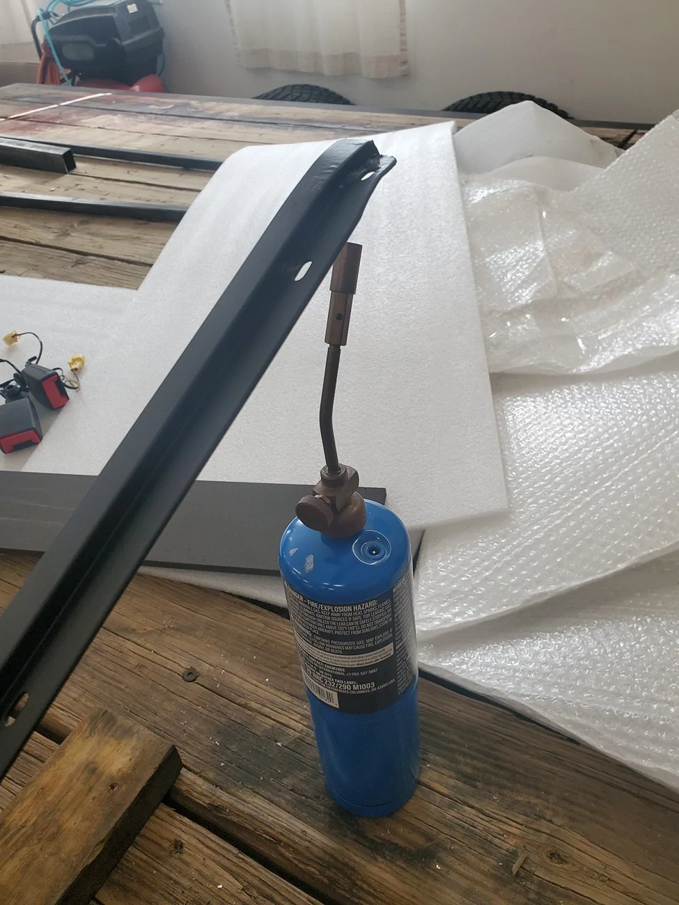

I heated the pieces to bend them easier; this made it where I had to shoot some paint on it.

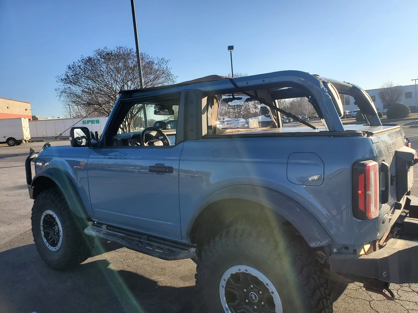

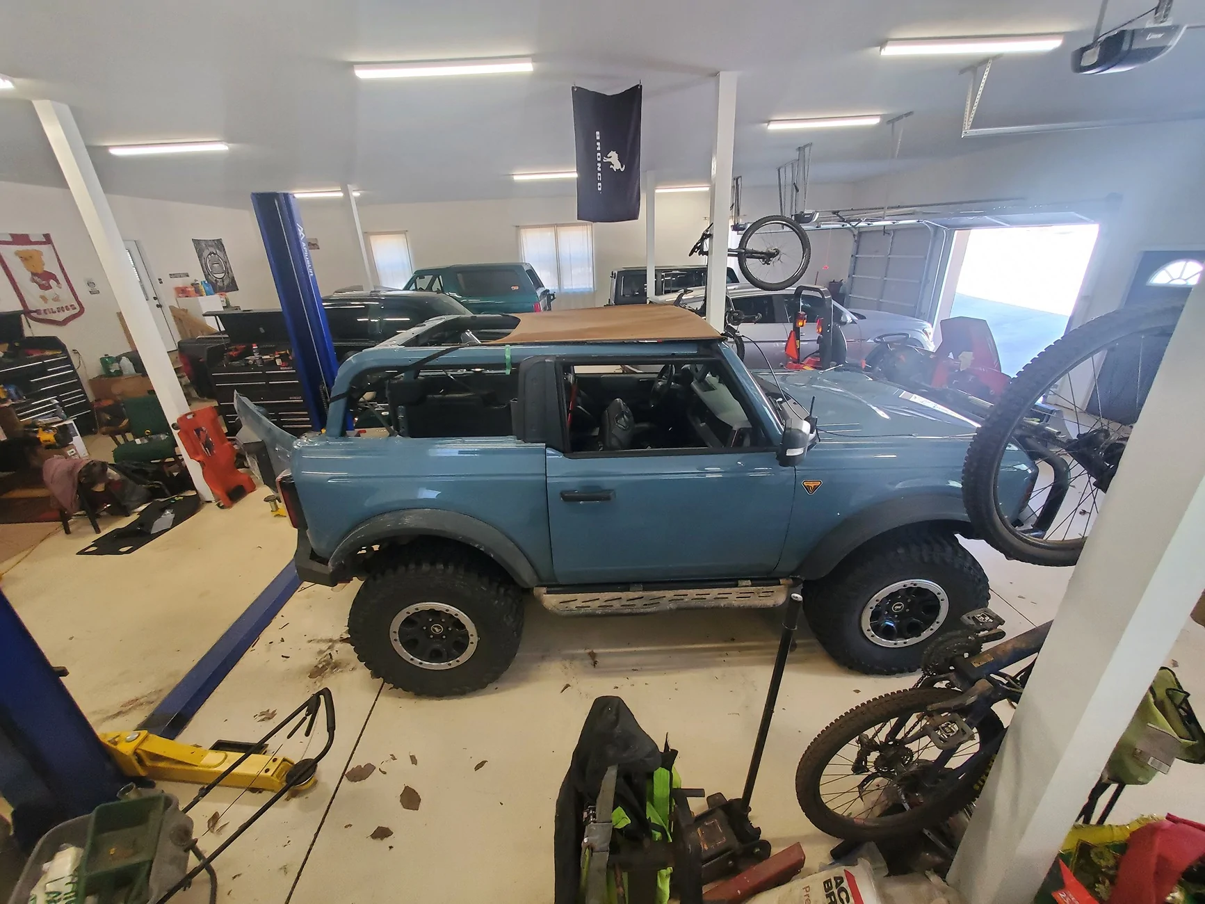

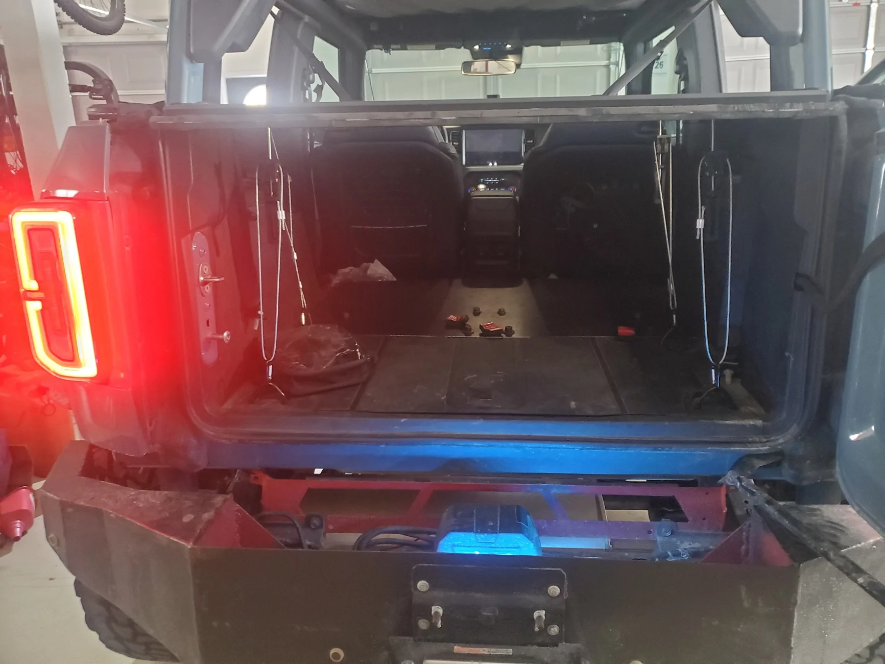

A few more pics. I used 1/8" wire rope to attach the cover to the d rings .
Ford Bronco Valhalla's Long term build thread 20260223_112446
This is what it currently looks like.
Ford Bronco Valhalla's Long term build thread 20260221_153159

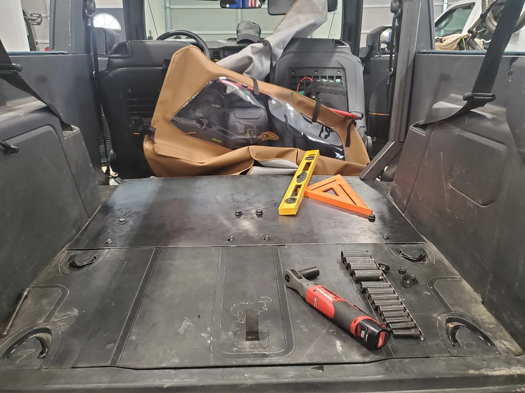

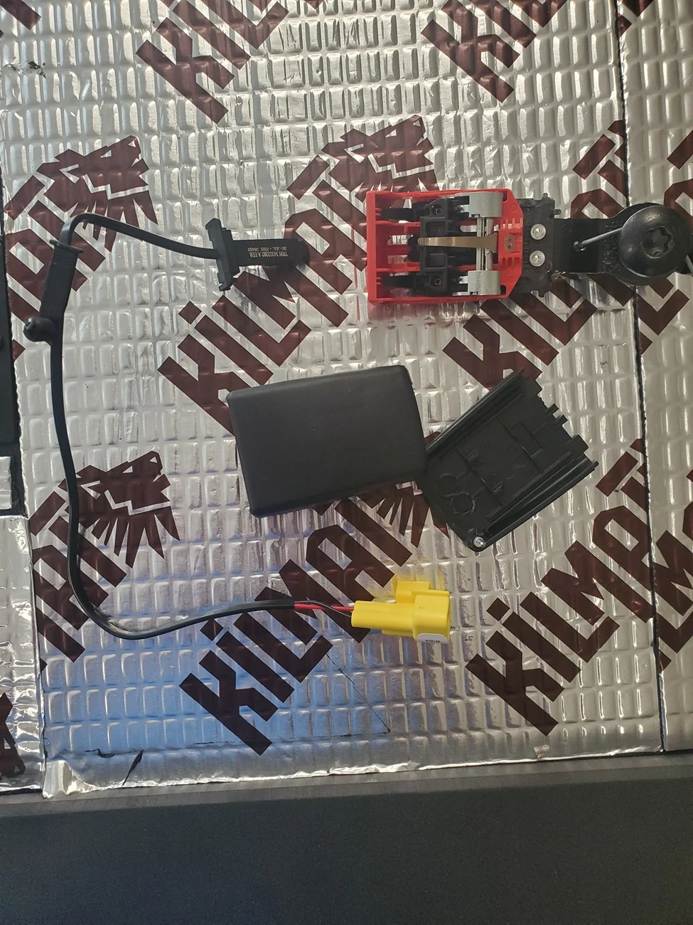

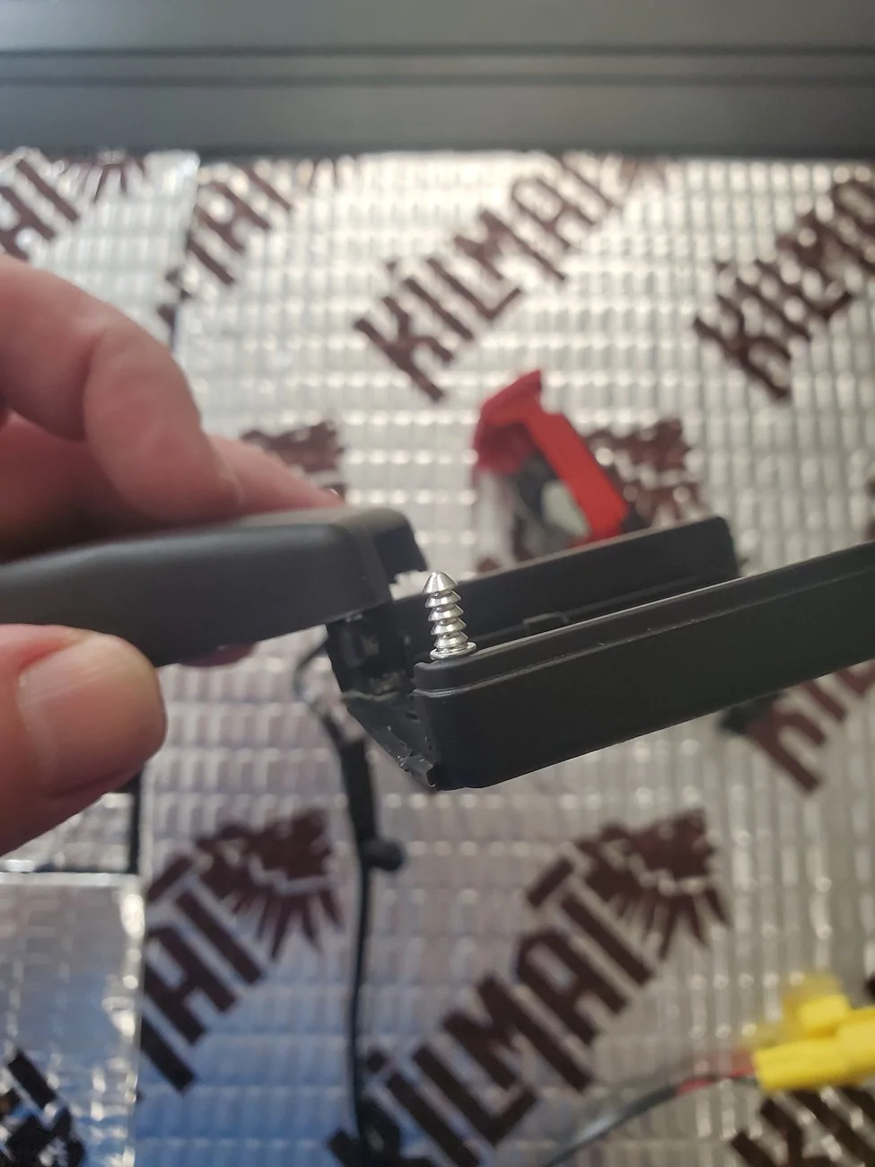

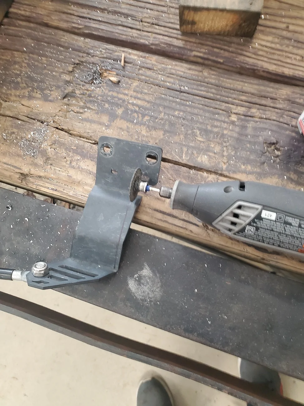

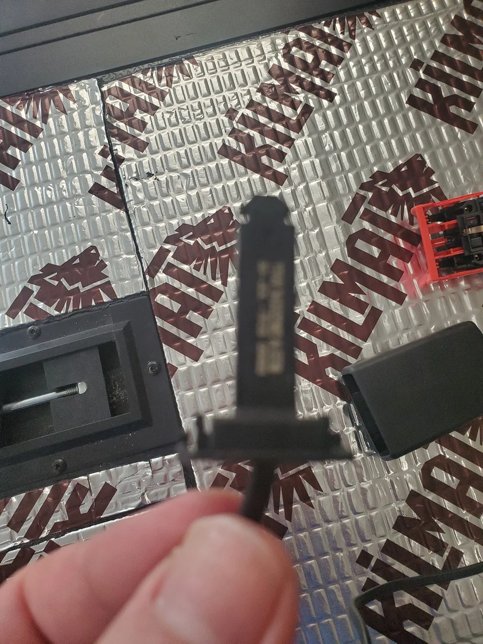

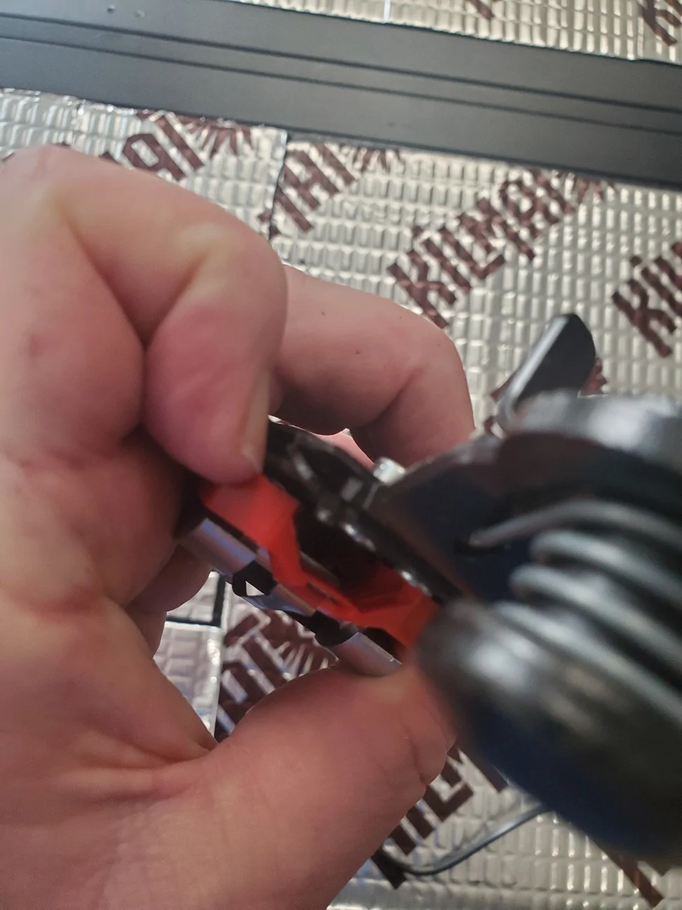

Anyone tearing apart rear seatbelts to remove them and not have a warning: they are 3 pieces the case snapped together with 2 one way rivets, the mechanism, and a proximity sensor. Buy 2 right belts, (cheaper) for the sensor.

You were much more surgical than I was tearing those apart. The replacements I bought were Dremel'd and hacked apart. :devil:
Yeah, I wanted to see how feasible it would be to remove and replace in stock belts.

why dont you Forscan the seatbelt stuff? I have mine all turned off.
This was sensing the airbag sensor wasn't there where I removed the lap belt connection.
It's a removing rear seat thing.
