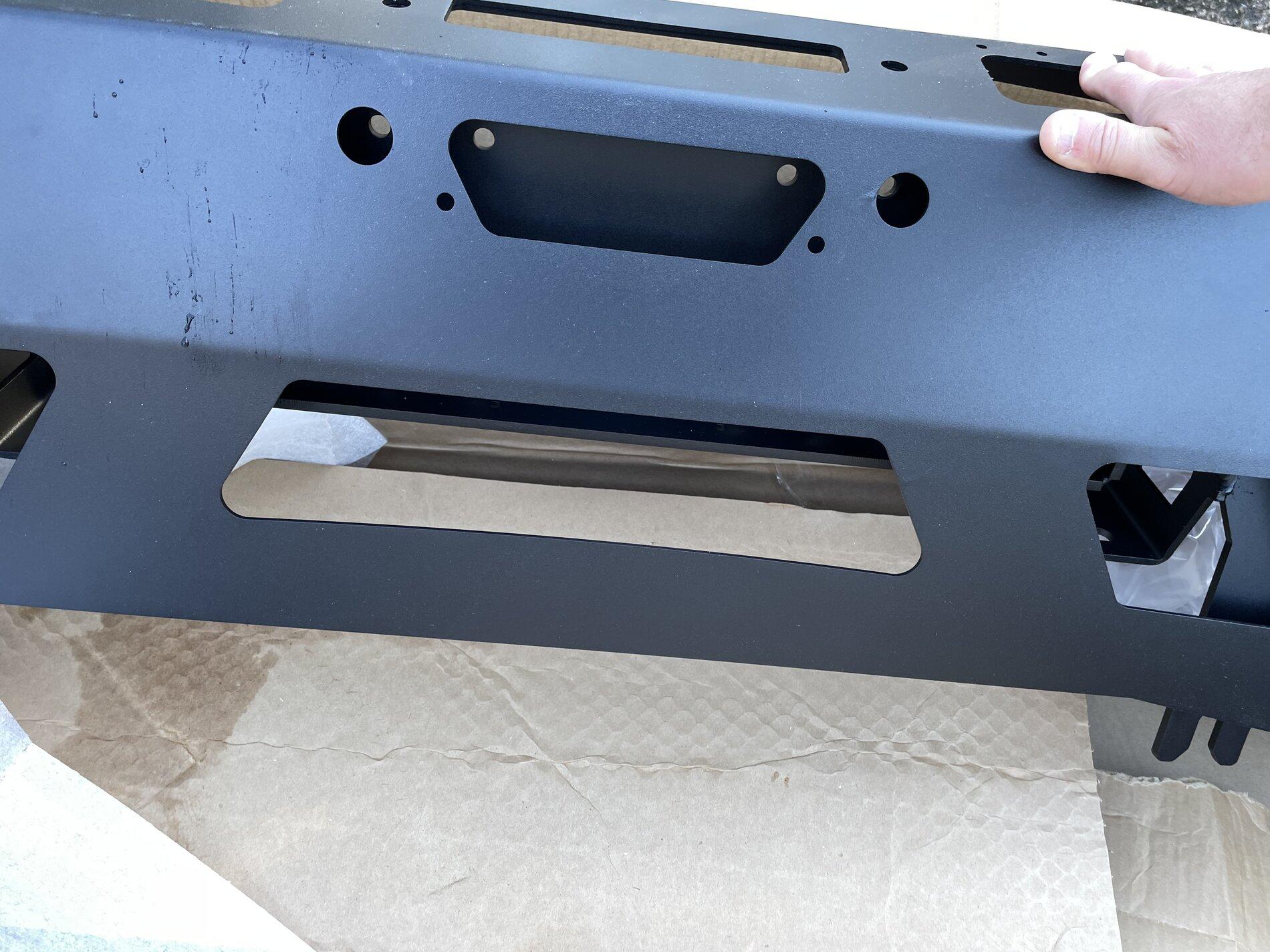

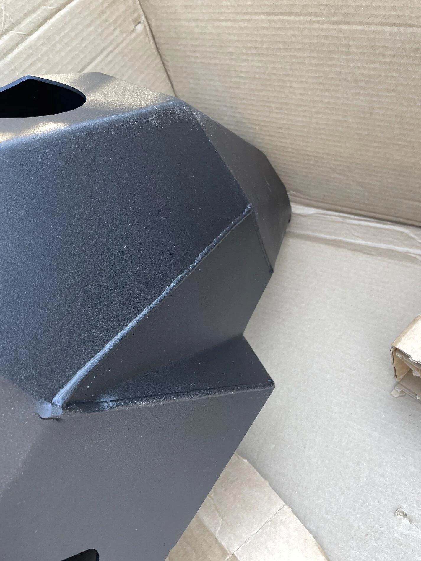

A Warn Zeon 10s and the Warn Elite bumper have arrived and thought others would like to get a closer look at this bumper. It appears to be well built and I think it’s one of the better looking and cleanest looking options available right now.

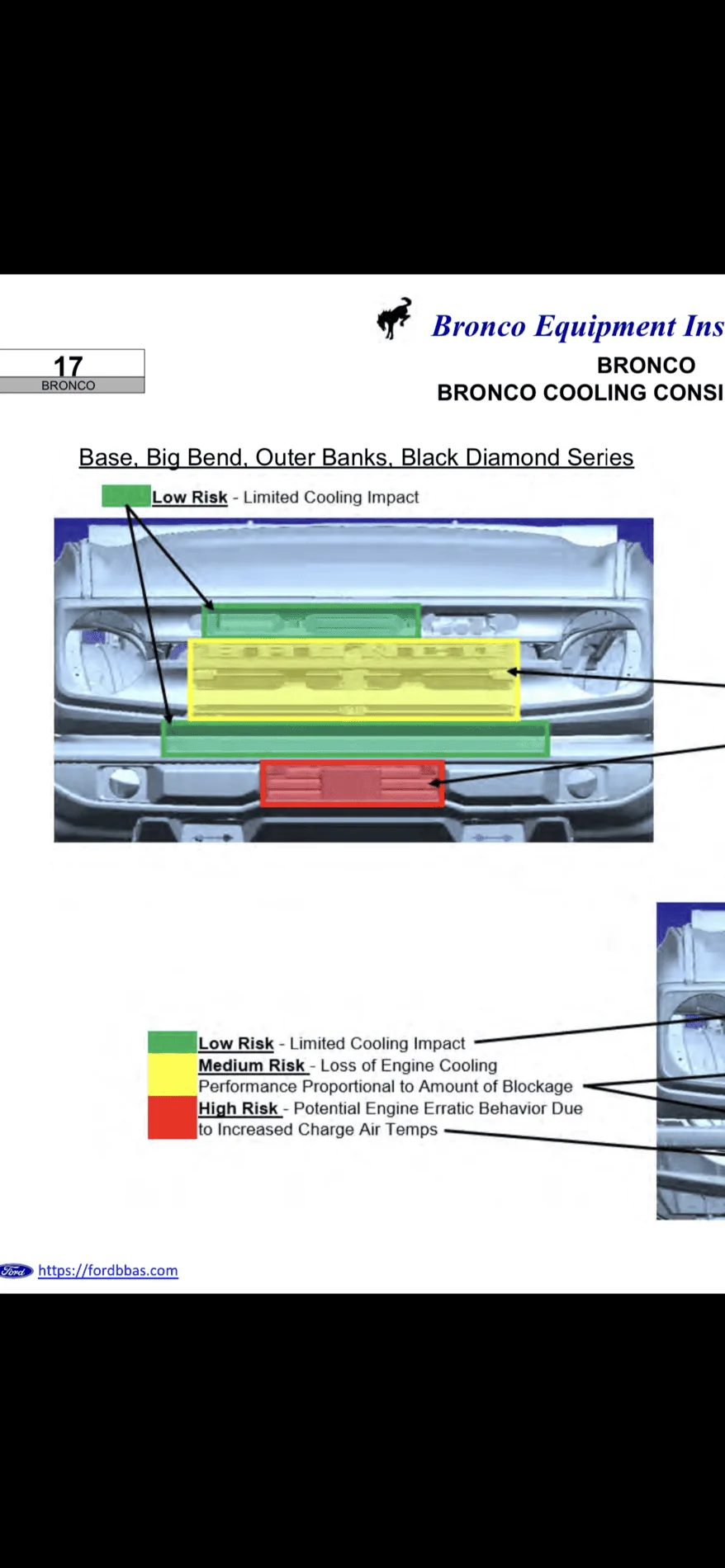

This will be my first vehicle with a mounted winch and I have some intercooler concerns after after a friend forwarded me the “Bronco Equipment Installation Guide” that Ford has created. Below is an image of the page that shows areas of the front of the vehicle that, if obstructed, are low, medium, and high risk for causing problems.

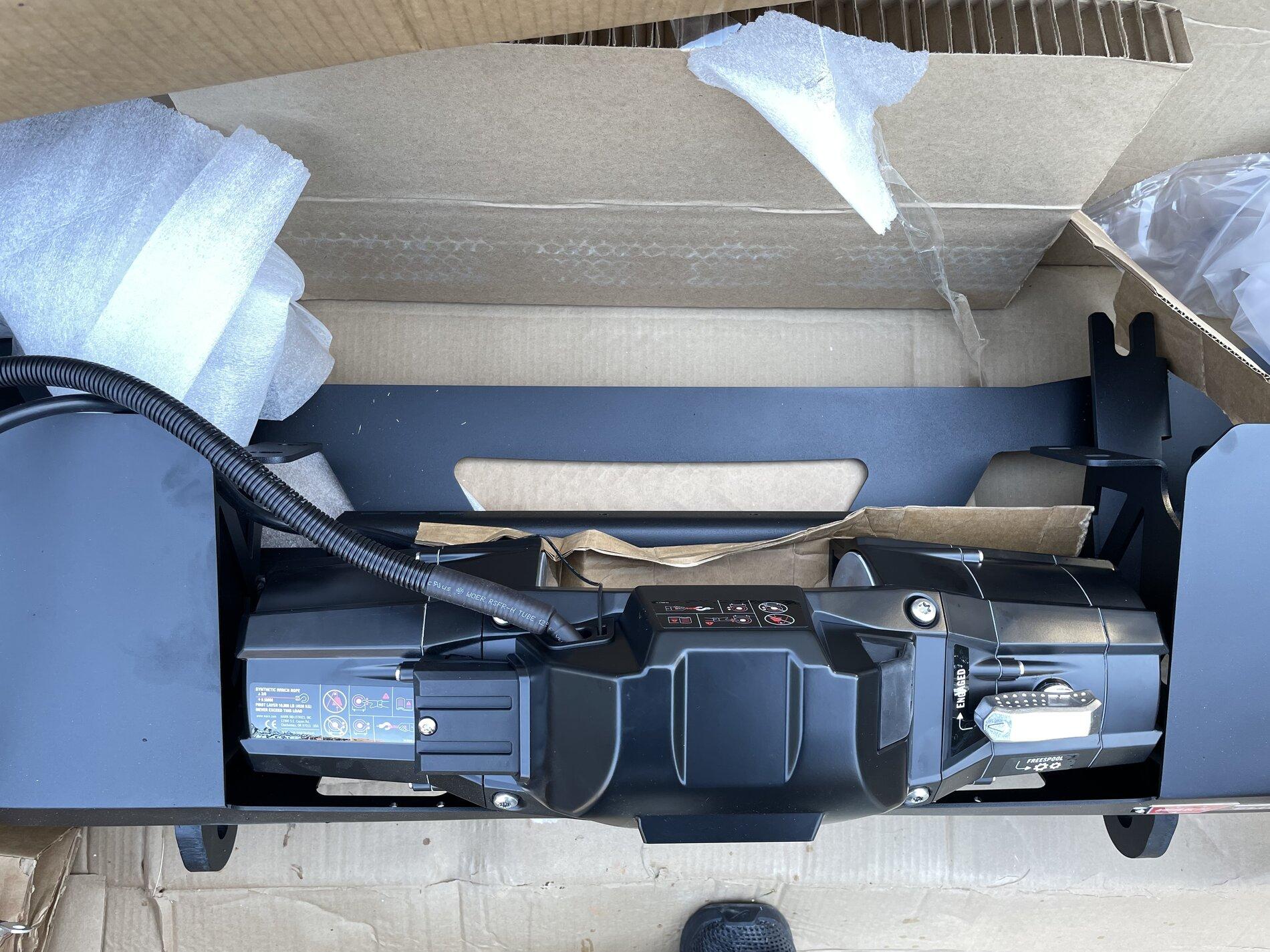

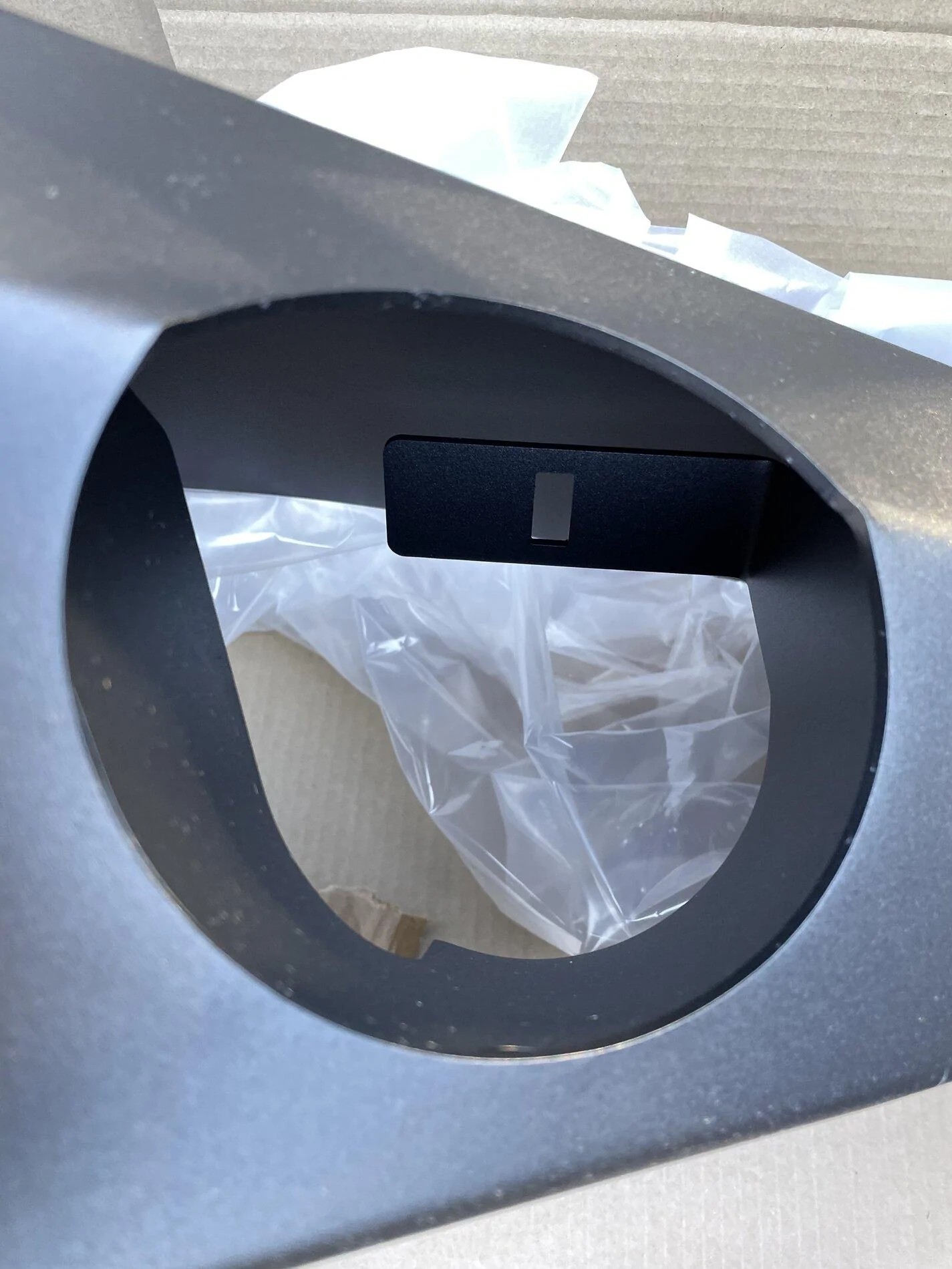

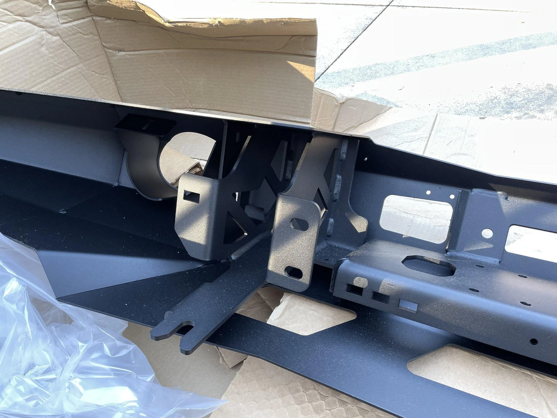

Best I can tell, the winch itself will sit directly in front of the intercooler. There does not seem to be any clear path for airflow to the intercooler once the winch is mounted, as seen in the photos I’m including. There are two cutout sections below the fairlead access hole, the lower most being a potential place for an aftermarket duct to scoop air up and direct at the intercooler. It’s difficult to tell if the geometry and space would work for this solution. I’ll be able to better tell once my Bronco arrives and I get it mounted.

The Ford factory winch DOES appear to mount a fair bit higher than the Warn.

I would definitely be concerned about covering such a critical cooling "port"
On the other hand, intercooling of turbos is used to get more power and uncooled turbos have run for years. But it depends on where the turbo is located. If you block the air be prepared to lose maybe 15,20% off the top, maybe more. You could always remove the turbo and reprogram the chip, but running it hotter will do much of the same.
