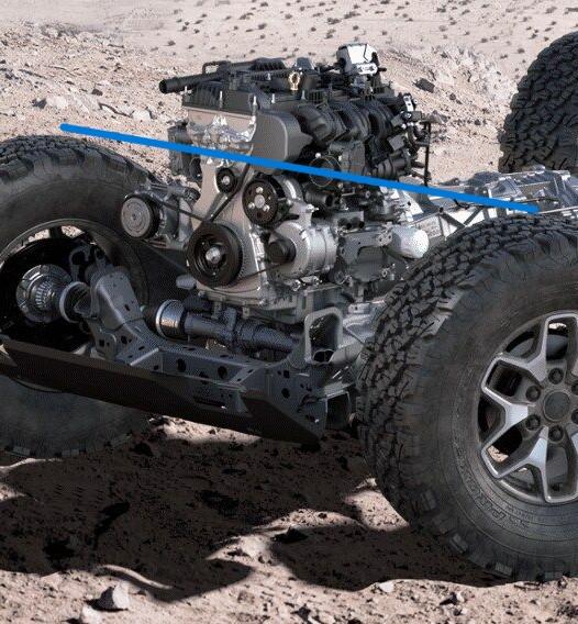

It's not a "myth" that submerging your alternator can carry in mud and debris that cause it to stop charging these very electronic dependant vehicles.
The alternator is higher off the ground on the 2.3, that is a fact. If I'm driving through water, I would prefer that my alternator stay out of the water as much as possible. Maybe the Everglades is immune to this somehow... I have no idea.
For me, I'm not driving anywhere that I need a snorkel on a regular basis, and I would prefer (when crossing water) to keep the alternate dry (especially on long trips) instead of having it continue to get wet and collect crap that is extremely difficult to clean out.

Wait, it's a "myth" that submerging your alternator can carry in mud and debris that cause it to stop charging these very electronic dependant vehicles... huh.
The alternator is higher off the ground on the 2.3, that is a fact. If I'm driving through water, I would prefer that my alternator stay out of the water as much as possible. Maybe the Everglades is immune to this somehow... I have no idea. Drive with yours submerged as much as you want.
For me, I'm not driving anywhere that I need a snorkel, and I would prefer (when closing streams) to keep the alternate dry on long trips instead of having it continue to get wet and collect crap that is extremely difficult to clean out.
*Ford claims that the "safe fording depth" of the Everglades is 36.4"
*The alternator in the 2.3 engine in the Bronco will be completely submerged in 36.4" of water
*Ford has never stated the engine choice had anything to do with fording depth
>Perhaps the reason Ford didn't allow the MANUAL TRANSMISSION in the Everglades has nothing to do with it being submerged in water, but to streamline the building process on a specialty edition, at a time when the 2.7, the manual transmissions and the high/lux packages were high restraint items.💡
I also would not like water into my electrical components, however if I'm in 35" of water, it will be.

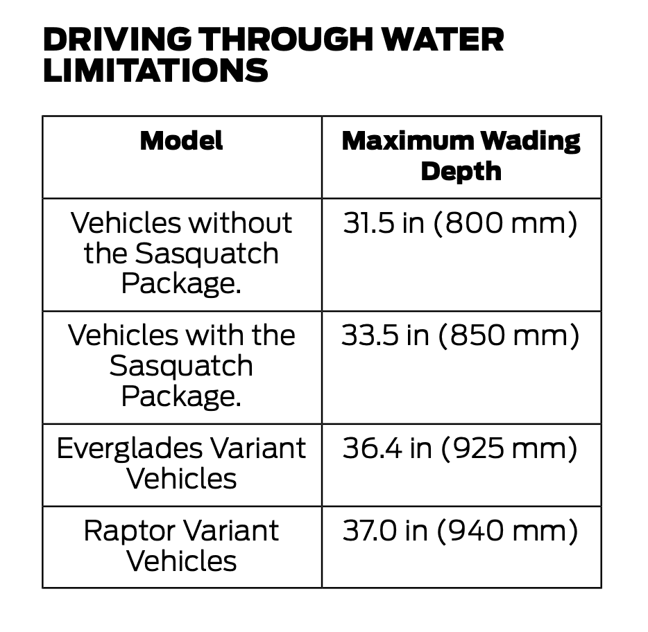

From the 2023 owner's manual.
Ford Bronco Water Fording Screen Shot 2024-04-14 at 7.16.02 PM

Yes. Also the Badlands has 33" inch tires instead of 32". Probably a good idea not to push the numbers in the manual.
