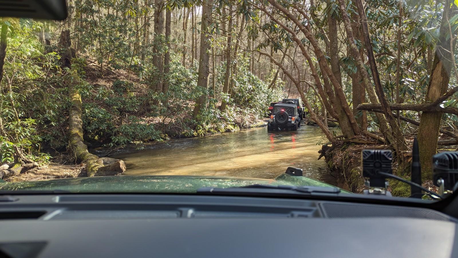

See my thread the diff tubes are actually up near the hood your limiting factor is the fuse box under your steering wheel. After my adventure the alternator hiccuped a little when the auto shut off system triggered and wouldn't restart, but I just did it manually and that went away after I cleaned the engine bay. They're tough cars.

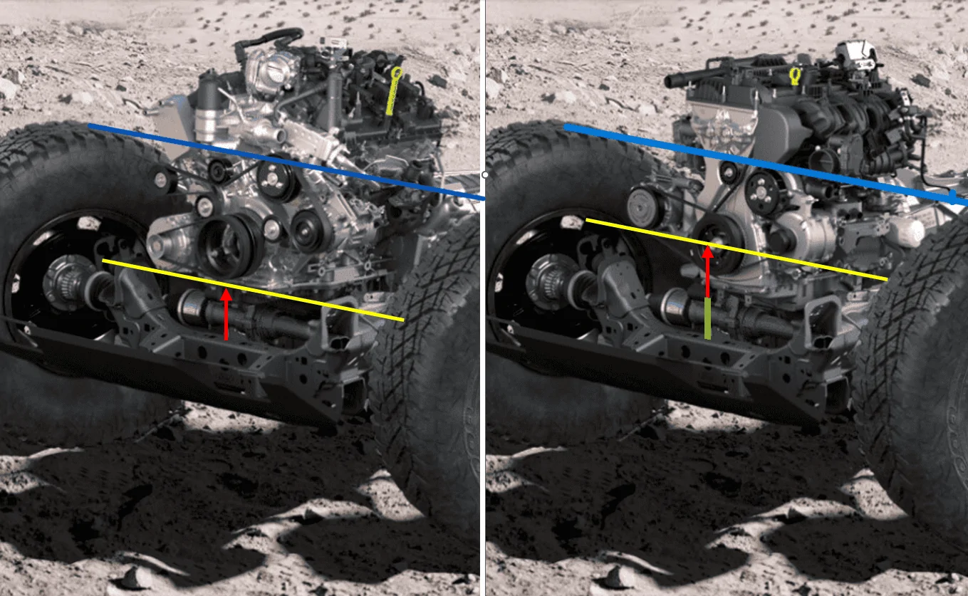

I feel like (if you're sticking with the stock configuration) a Squtached 2.3L is probably your best bet to have some fording success. Thought I read this was why the Everglades wasn't offered with the V6.
The decal on the Everglades shows the Safe water fording mark 2" above the top of the tires, the alternators on both the 2.7 and 2.3 will be submerged at the level (see blue line). So it appears that is simply a false claim that keeps on getting repeated on here.
