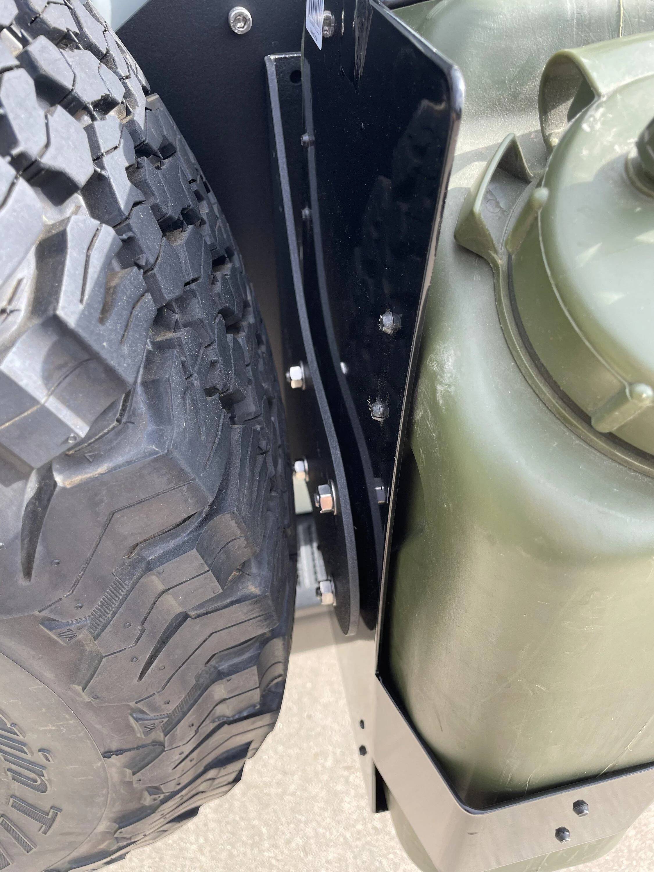

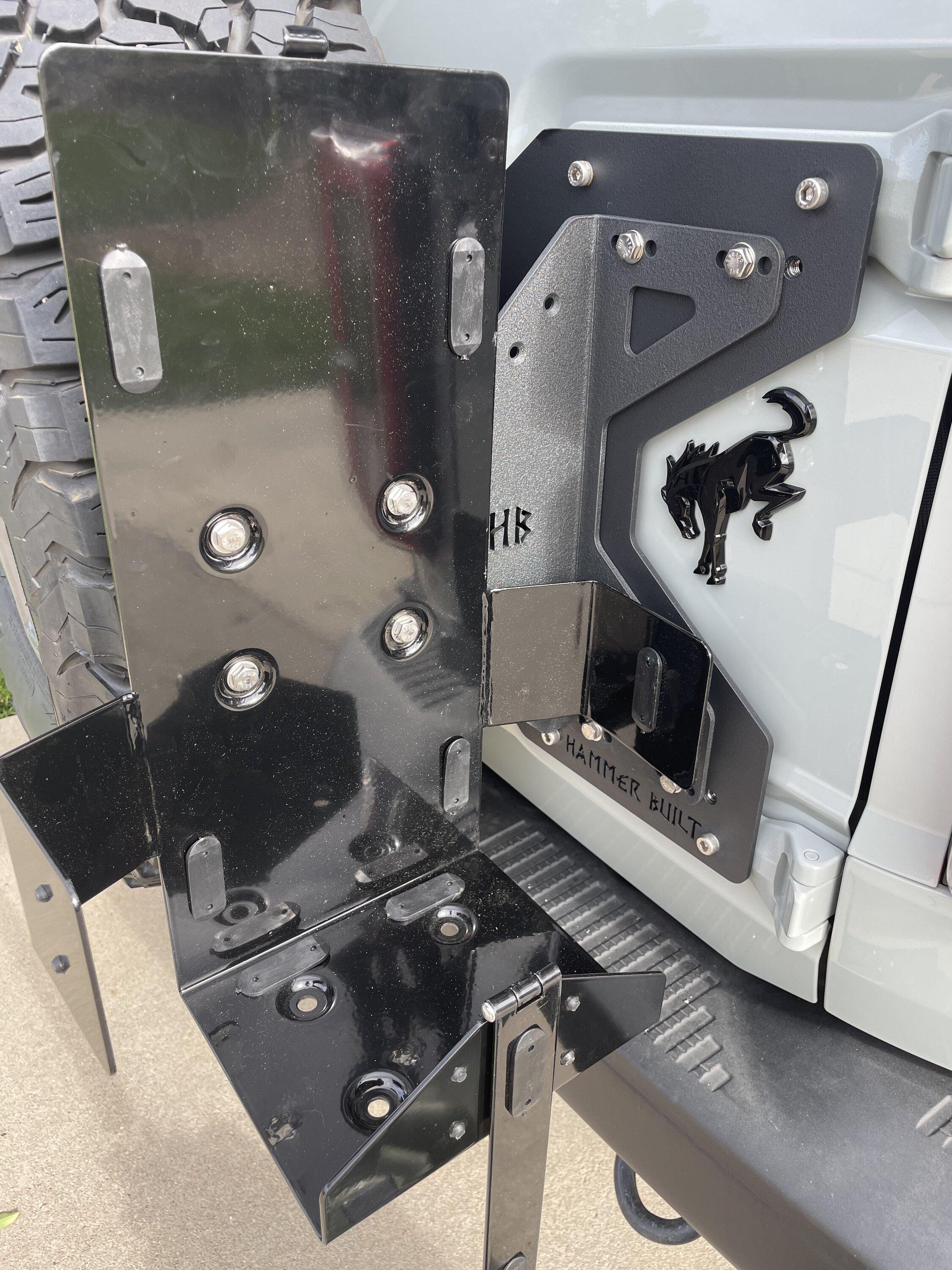

Jerry can mount installed.

Are you mounting this on the HammerBuilt Tailgate reinforcement plate? I was thinking of doing the same just trying to figure out where to drill, would love to know how you mounted the Jerry can holder! looks great!

So I first added the hammer built reinforcement with the accessory arm plate. Once the jerry can mount arrived I used that as a template to mark my bolts. I made sure the mount and can wouldn’t make contact with the taillight when the tailgate is at the 90deg open and marked my holes. From there I drilled out my bolt holes in the hammer built accessory arm, sprayed the holes with some black paint using a rag to avoid over spray and to wipe the plate. Then installed the mount using all stainless steel hardware from Home Depot and blue loctite. I’m also using a lock for security that rattled metal on metal when closing the tailgate so I threw some shrink tube on it and it’s eliminated the rattle. Overall it was really simple and took no time to do.

Great work, glad to see it fits in there!! I was thinking of doing the same exact thing! Tyson from Hammer Built said they are in the works to make a Jerry Can Holder to mount to their base so I held off on doing what you just did.
