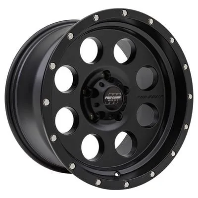

I don't want to buy a wheel and find out it won't fit on my 2022. The wheel I want has 4.75 backspace and -6 offset. Does anyone know if this works?
Here is the ProComp 45 Proxy I want.

I have a 2022 Black Diamond and will be adding a 3 in lift, 35x12.50x17 BFGs and the wheels I mentioned, hopefully.

Those wheels will have a lot of poke. Maybe you like that look. Many do, I do not, but it's your rig.
Due to the negative offset, they will stick out 1.5" more than a Squatch.
-6 offset may lead to rubbing issues due to increasing the swing arc so much, maybe not.
I think others here have run -6 wheels.
Search is your friend .... as is research.

That wheel will def work. But as noted, you'll have a bunch more poke than you need or might like. With that build and 12.5" tires on 9" wheels, you could get away with as little as +25 offset. The sas wheel is something like +33.
You'll have a tough time finding wheels you love with the right offset. You can settle for a little more poke. But down into the negatives is generally doing too much. I don't know why Ford has such extreme hub alignment and stock wheels with outrageous positive offset. Hopefully as they pump out more and more broncos, wheel makers will offer more for us. But that cycle of r&d, manufacturing and delivery is slooooow right now.

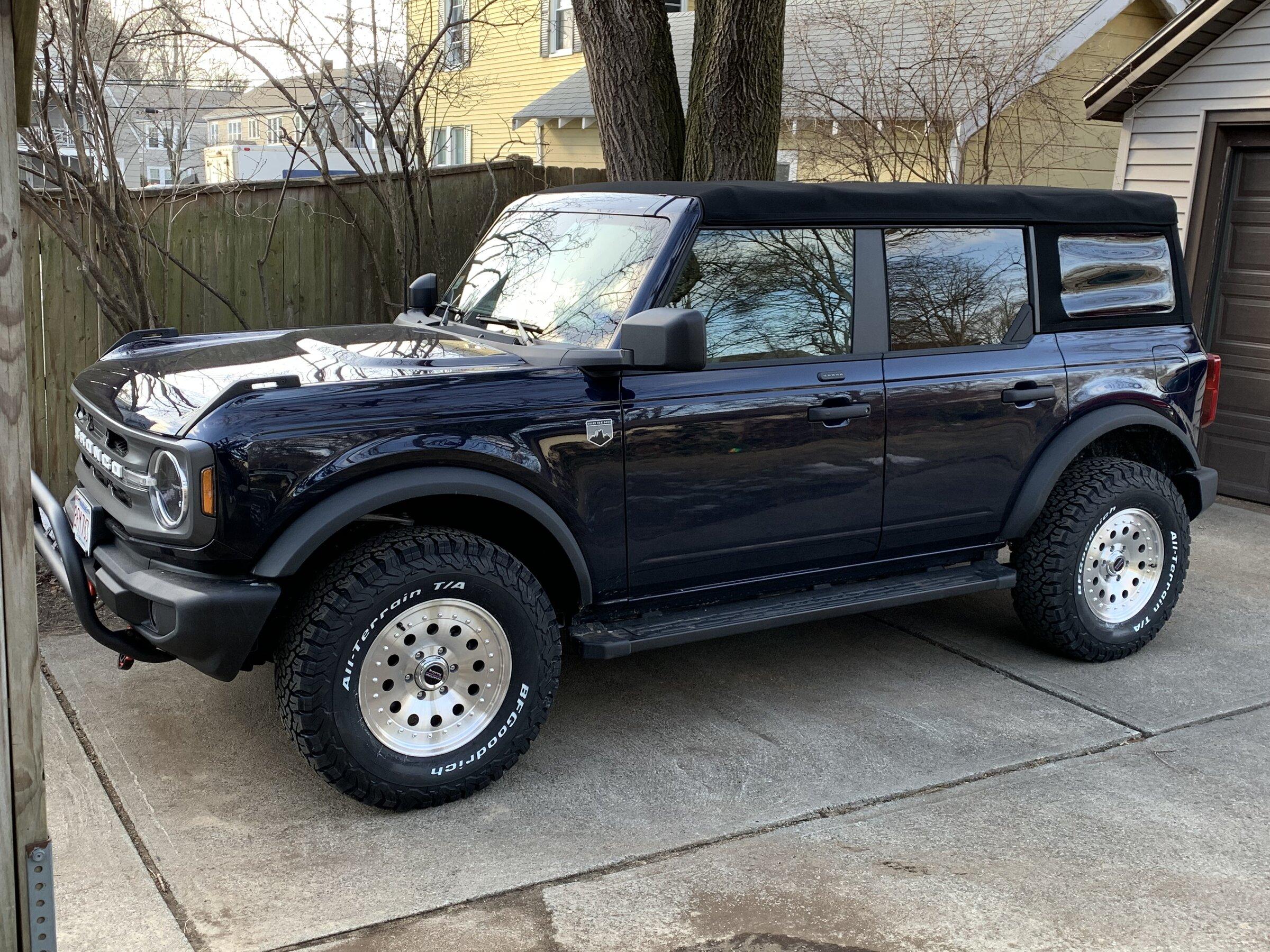

I run zero offset, pic in profile.​

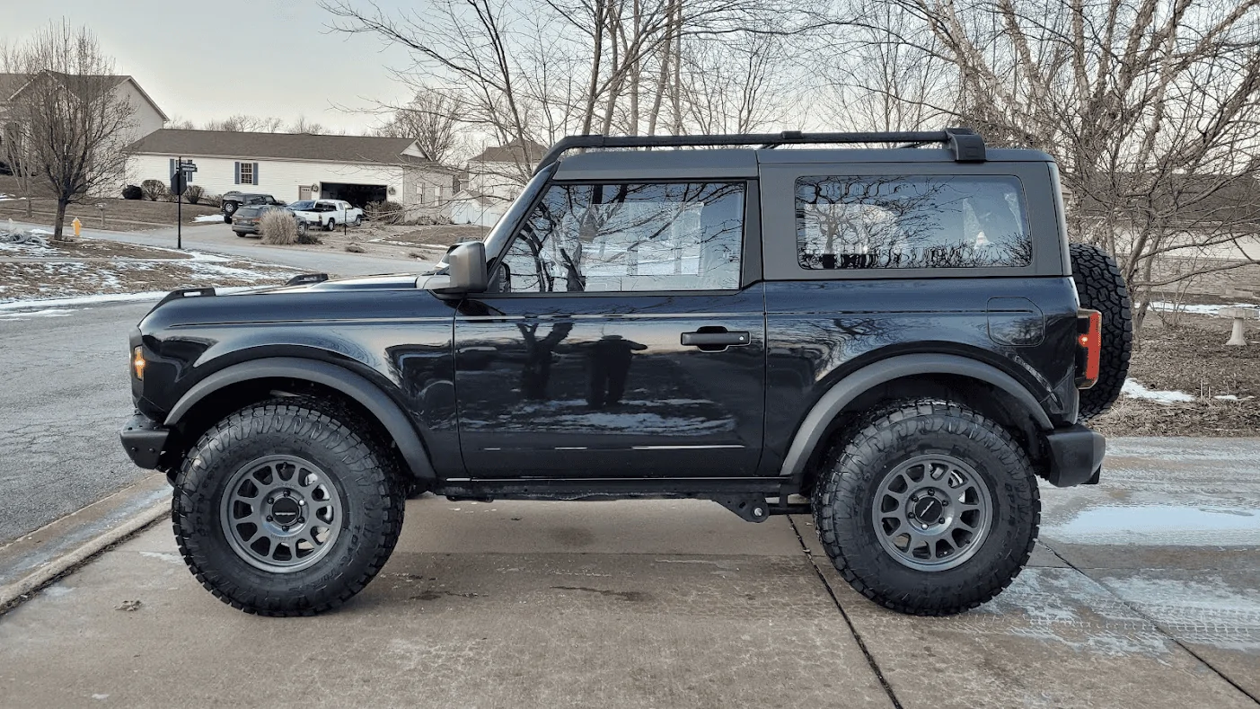

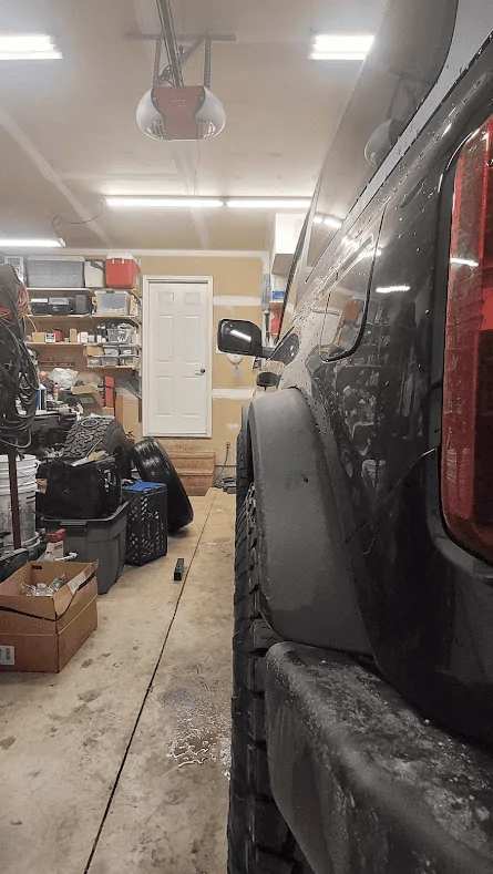

Here is +35mm offset with 11.5" wide tires on standard flares.
Ford Bronco WHAT OFFSET AND BACKSPACE WORK? 1643324952077
Full specs:
Method 703 , 17 x 8.5 +35mm ;
Toyo AT3 35 x 11.5 x 17 Load Range C
NO LIFT on a Base Bronco (non-squatch)
Ford Bronco WHAT OFFSET AND BACKSPACE WORK? 1643325163075
Ford Bronco WHAT OFFSET AND BACKSPACE WORK? 1643325377340

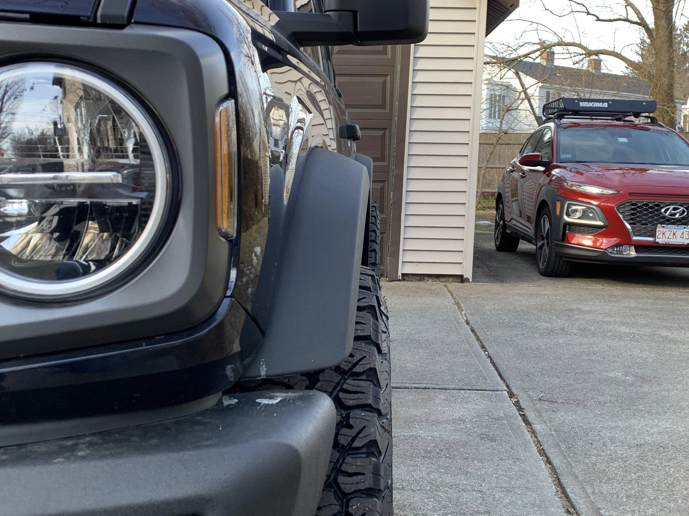

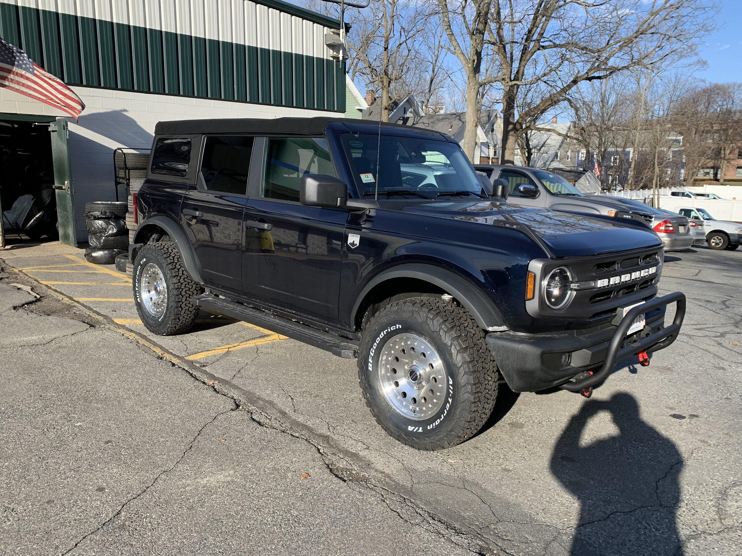

Dez
Geoff
Jan 1, 2022
164
493
Framingbury, MA
1967 Mustang, 2021 Hyundai Kona, 2021 Ford Bronco

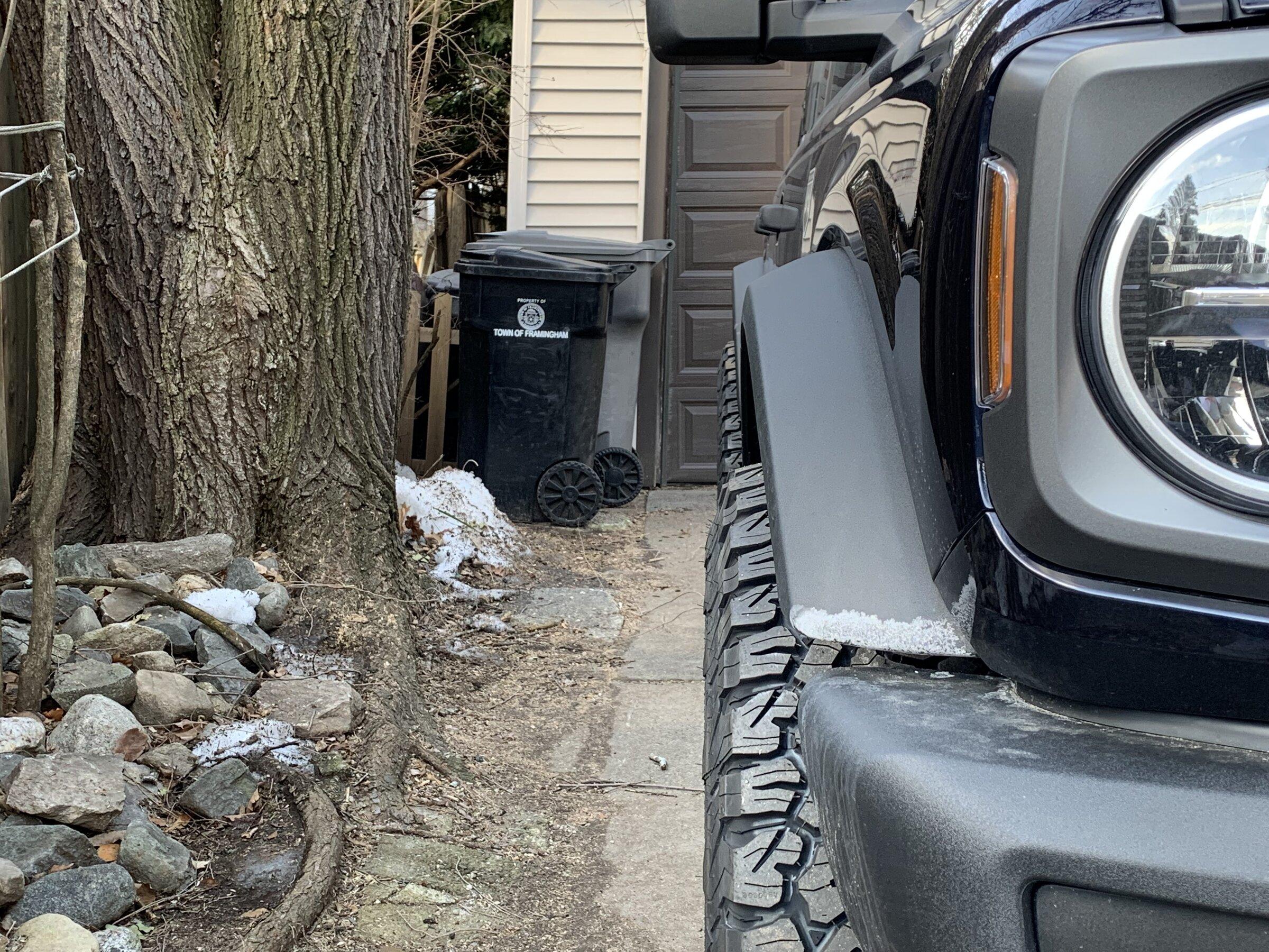

These are 17X8 with a +18mm offset and 5.21" BS. 285/70/17 BF KO2's. Stock flares, no lift.
