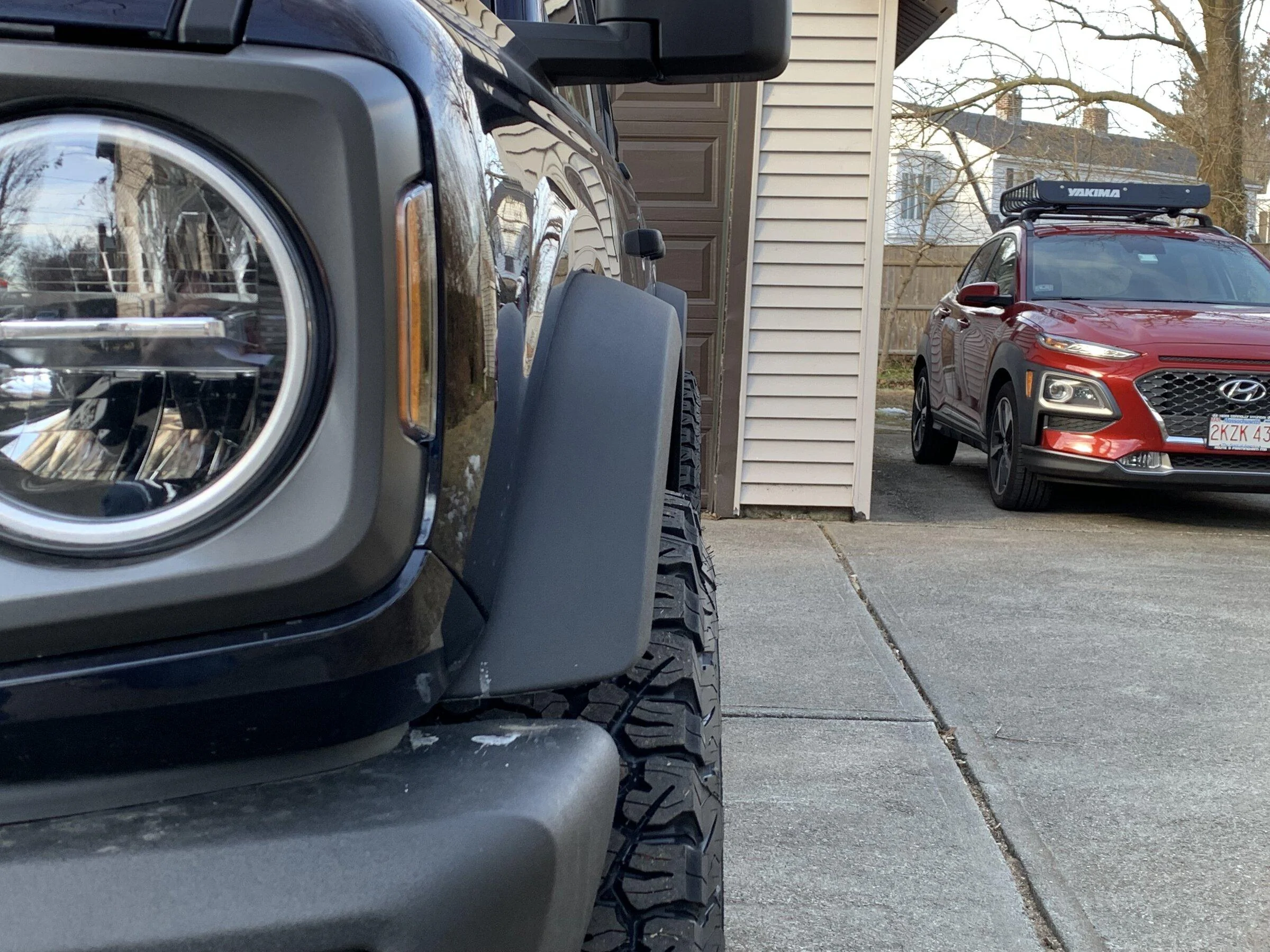

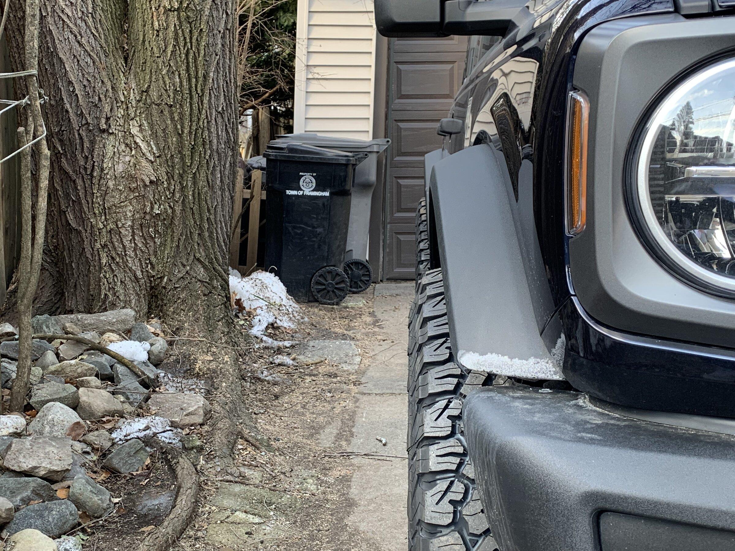

Yup, I have the same offset as Dez up there but waaay more poke, more than I really wanted. I kind of regret going with 315s.
Dez
Geoff
Jan 1, 2022
164
487
Framingbury, MA
1967 Mustang, 2021 Hyundai Kona, 2021 Ford Bronco
Thanks for doing this. Do you have the stock 285/70-17 BFG tires or something different?
Yes and no. Since mine is a big bend they are not stock size but are the stock tires/size for the badlands. 285/70/17 BFG KO2's.
I think the fact that my wheels are 17x8 also helped keep the poke in check. The backspacing of the wheels is 5.21".
