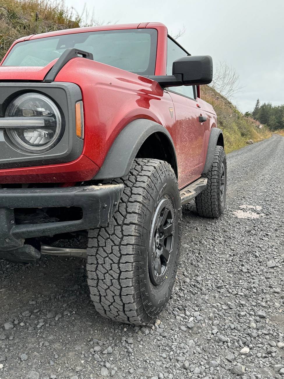

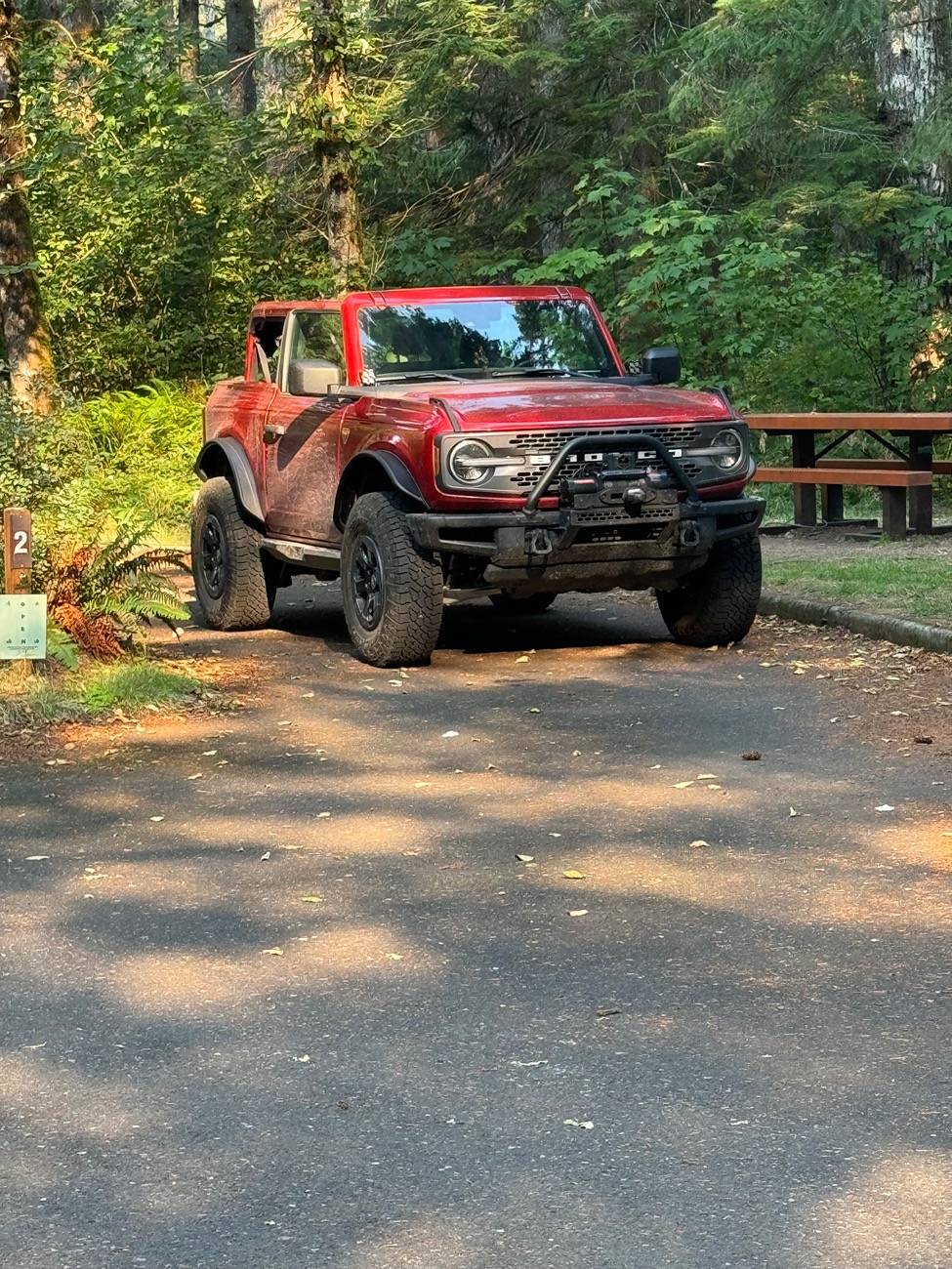

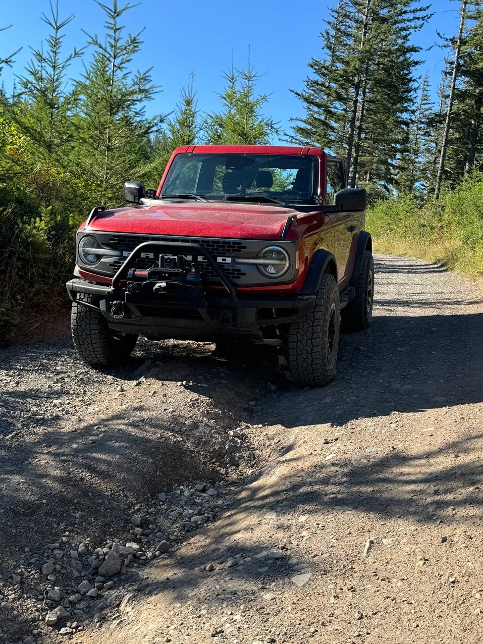

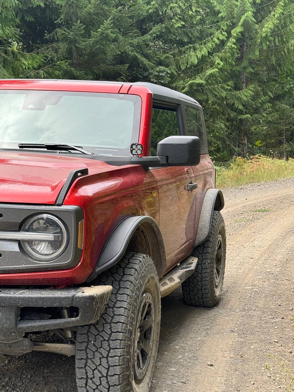

I have 1.75" Bora Wheel Spacers on mine to add additional poke. I am pretty sure I was getting rubbing w/o them..
I also have DV8 Fender flares on mine. These are a little wider than stock Badlands flares but narrower than the Sas Flares. I'd say the DV8 flares are in-between Badlands flares and Sas flares, width wise.
Here are a few images with the DV8 flares:

Here are a few images with the stock Badlands flares:
Ford Bronco What width 35s? IMG_0612
Ford Bronco What width 35s? IMG_0531
