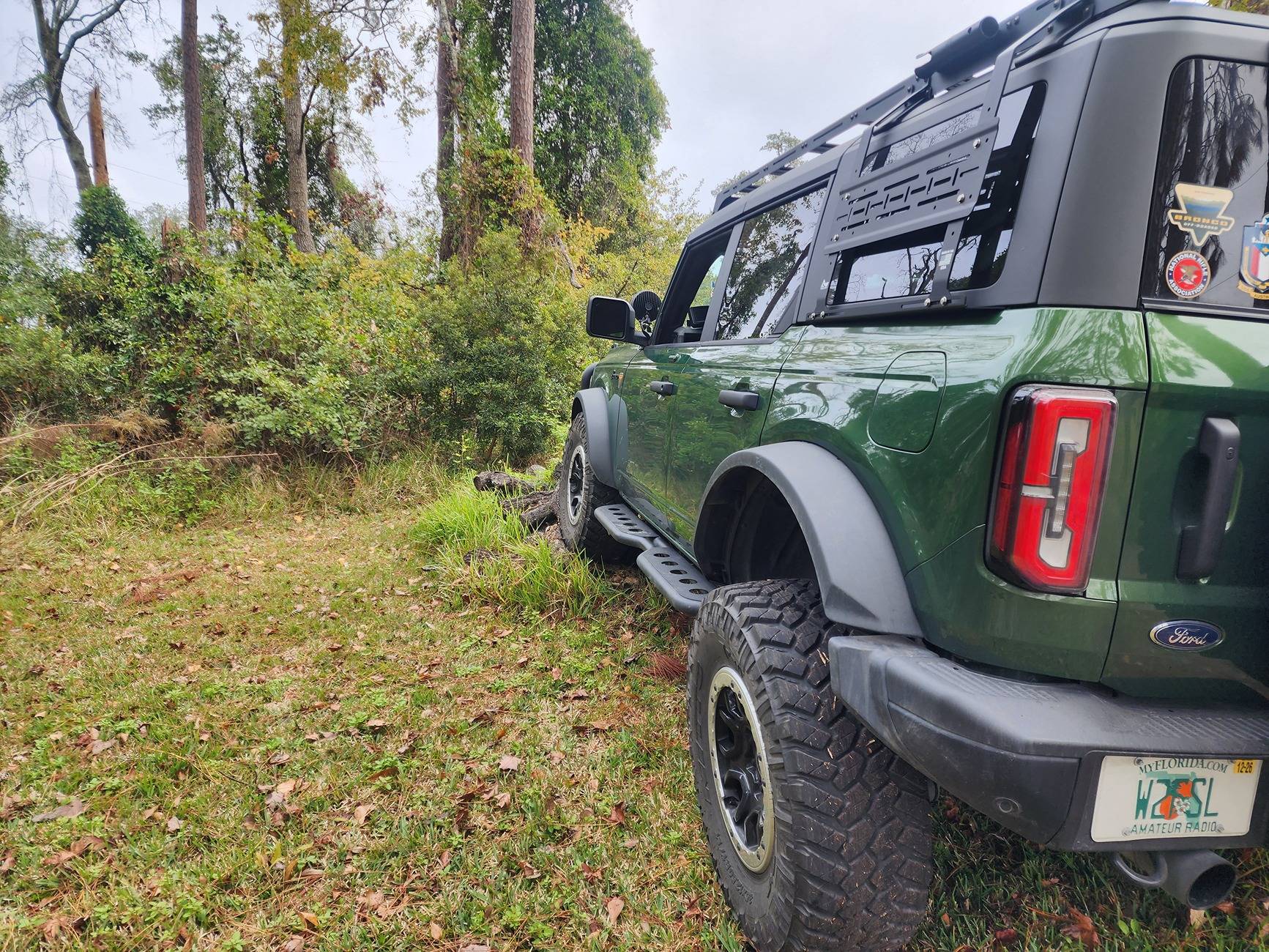

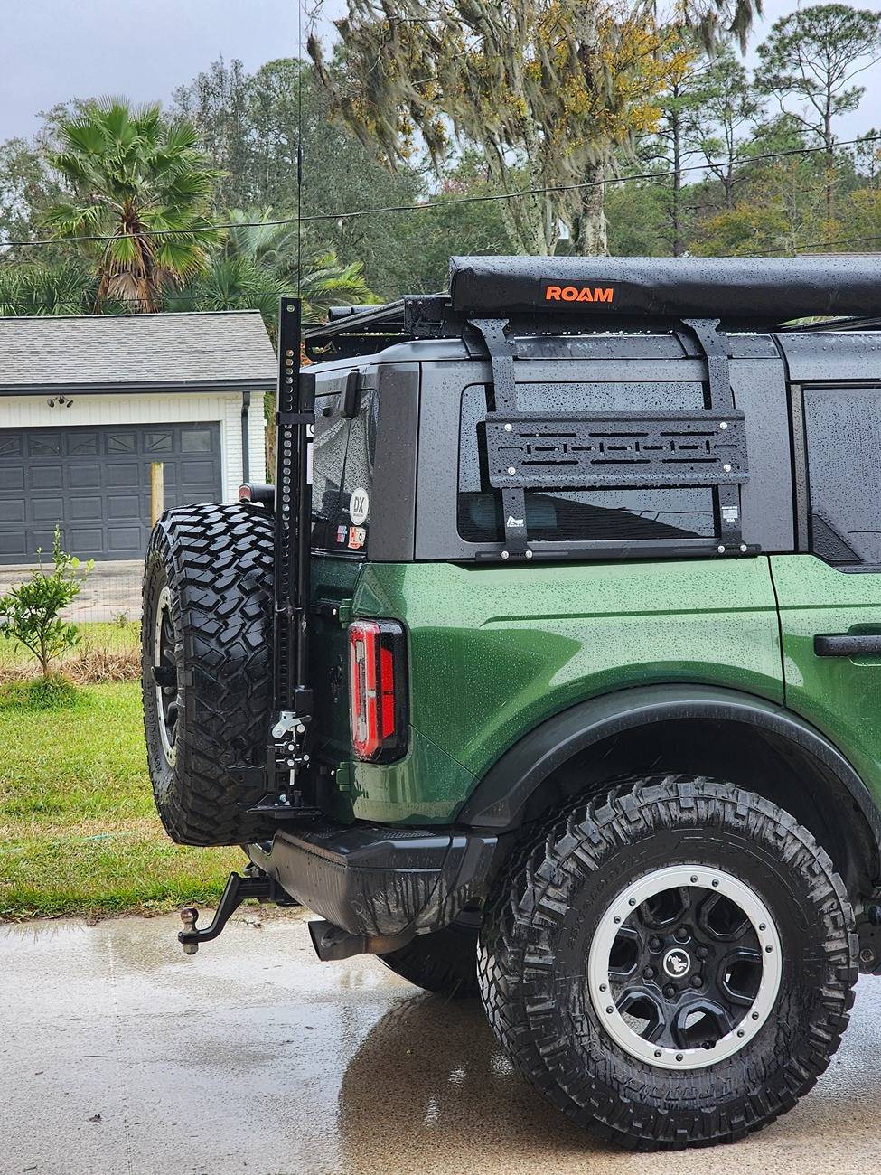

I'm running 35x12.5-17 Trail Grapplers on SAS wheels with zero issues.
Ford Bronco What width 35s? 20241227_112802
Ford Bronco What width 35s? 20241227_145308
It looks like you got some natural poke with the 35s, is that true?

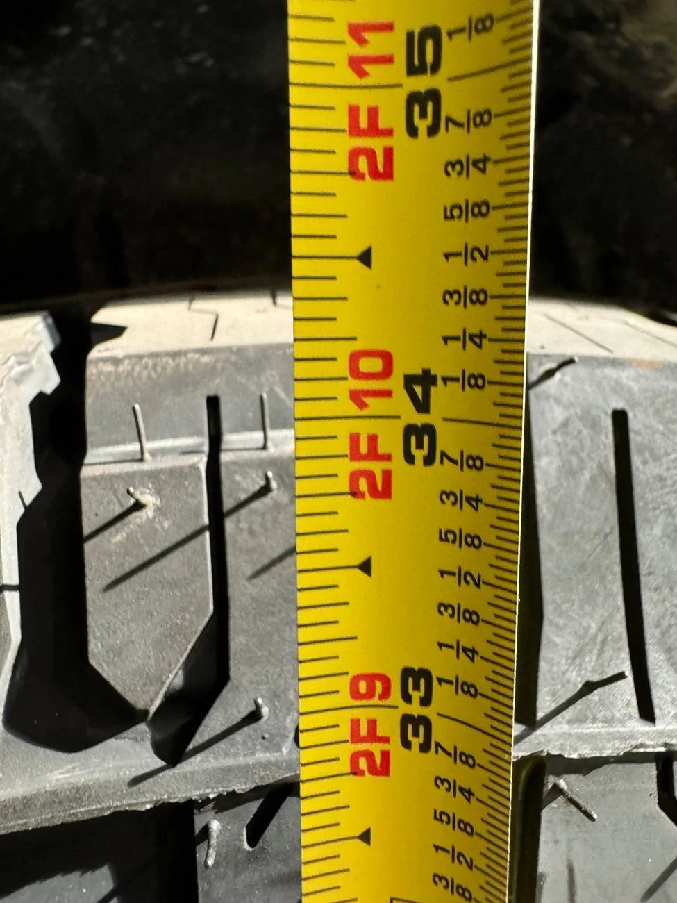

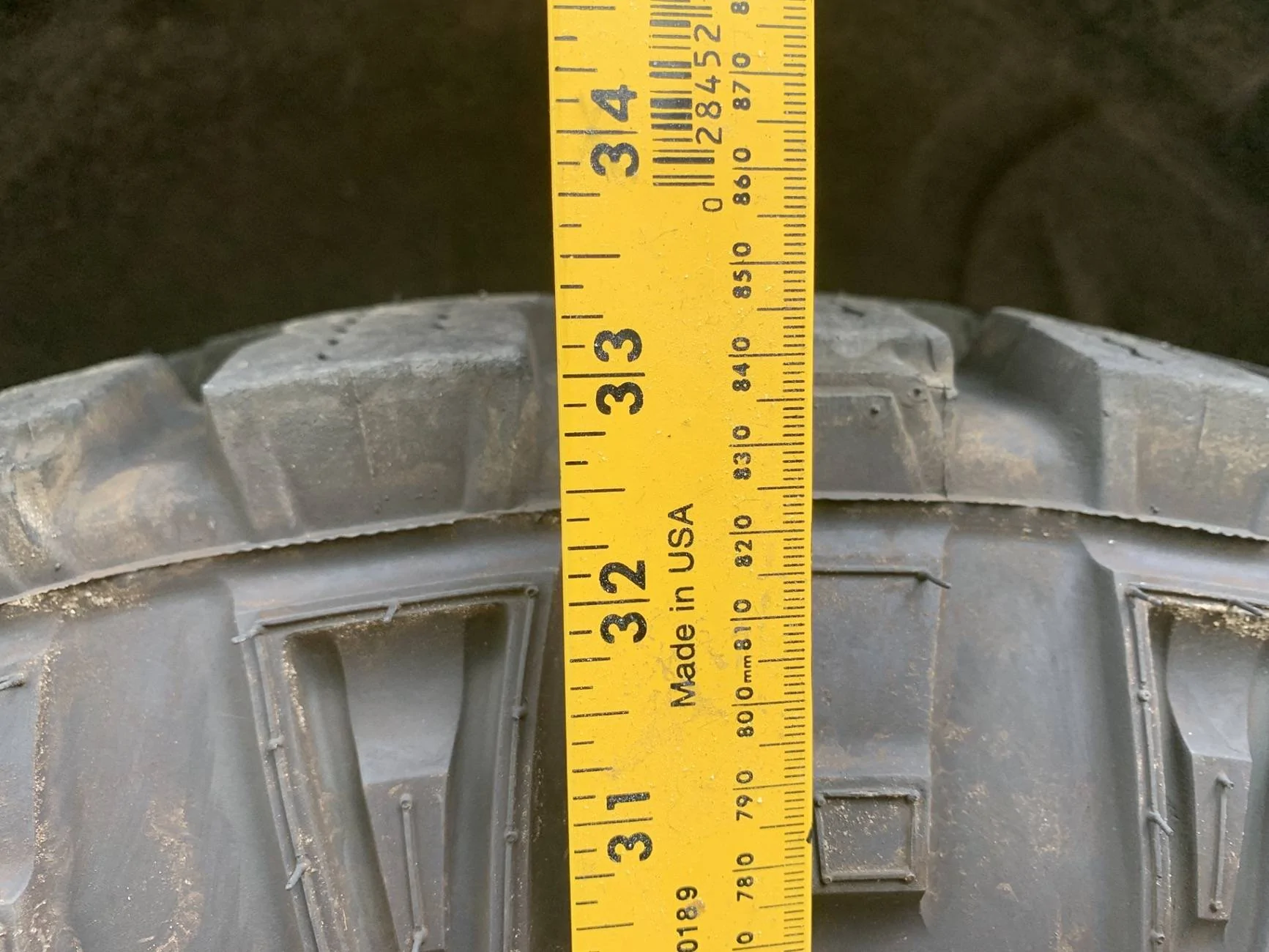

Don't get me started on 315/70R17 not being 35's... :crackup:
Manufacturer specs are never anywhere even close to advertised when the tries are mounted and under load.
After the tires are mounted and under load a 315/70R17 will be about 33 1/4" and 35x11.5R17 comes in at about 34 1/4". Yes there will be minor differences across brands but a 315 is nowhere near even close to a 35" IMO..
Photos:
315/70R17
35x11.5R17

Manufacture specs are mealiness.. I posted actual photos with a tape measure..
Just because a manufacturer tells you that a 315 is a 35 and they list specs does not make it true..
