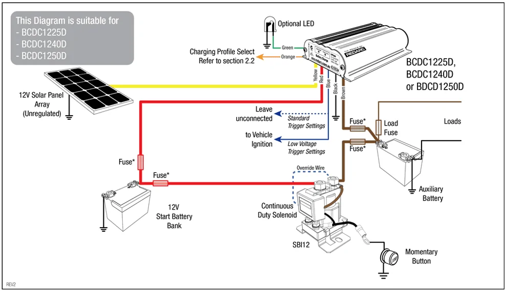

I'm running this Redarc system in my XJ (haven't hooked the solar up yet) but it works great! I plan on moving it out of the XJ and into the Bronco once I figure out a dual battery set-up. Likely with Lithium Ion this time.
I'm also fairly low tech when it comes to camping/overlanding and use a lot of my backpacking gear. Our reliance on electronics is relatively low so I'm mainly relying on it for our Engel fridge and charging phones.
