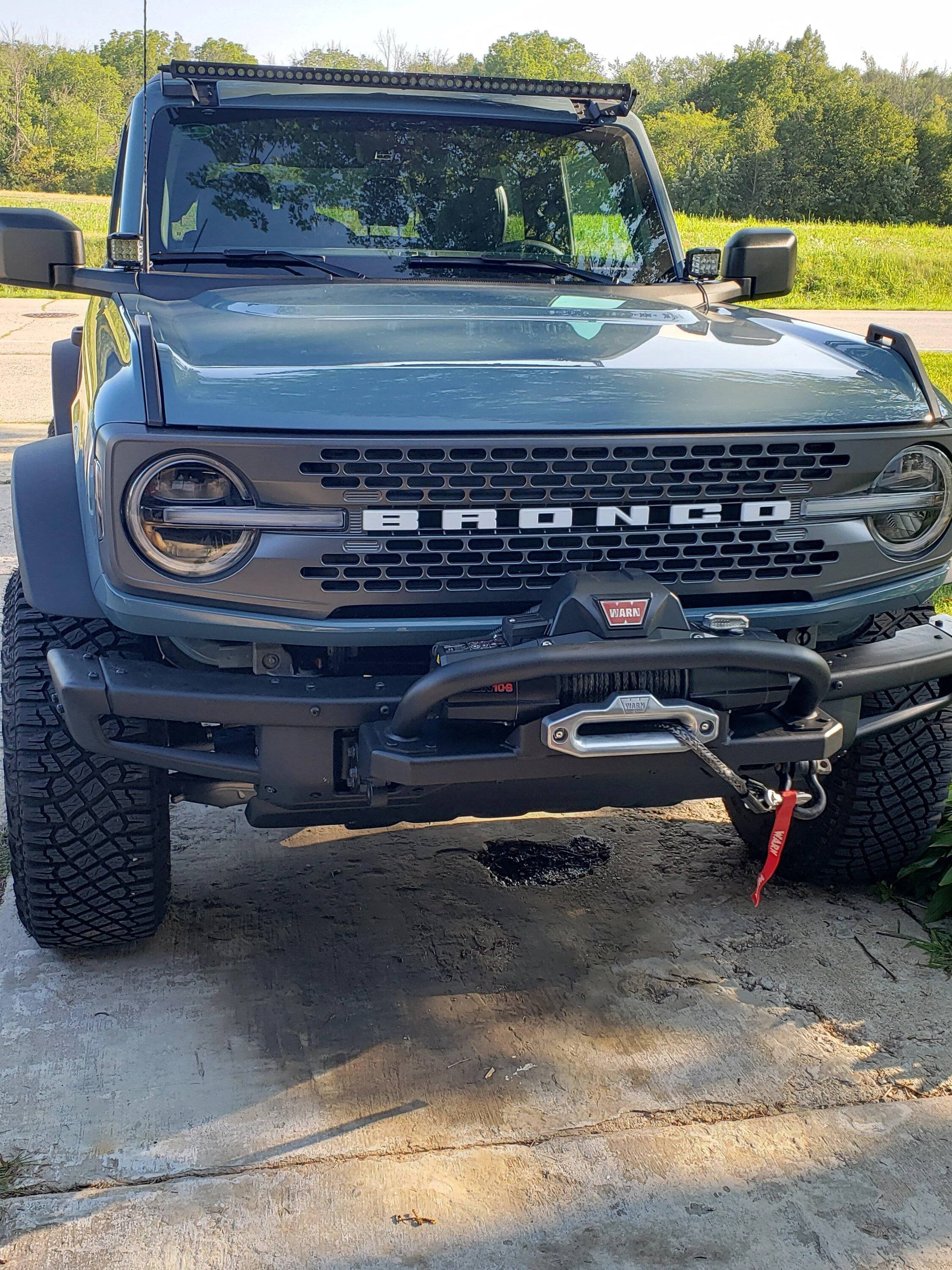

I have 1.4" borne offroad spacers on my BL sas. Very nice pieces. Tread lines up perfectly w/the flares. I plan on going to 37s as soon as they come off backorder, so I need a little spacing to maintain turning radius. W/the 35s doesn't look bad tho. I have 2.5" on my jeep xj. Have wheeled that one pretty hard over the years and had no problems.

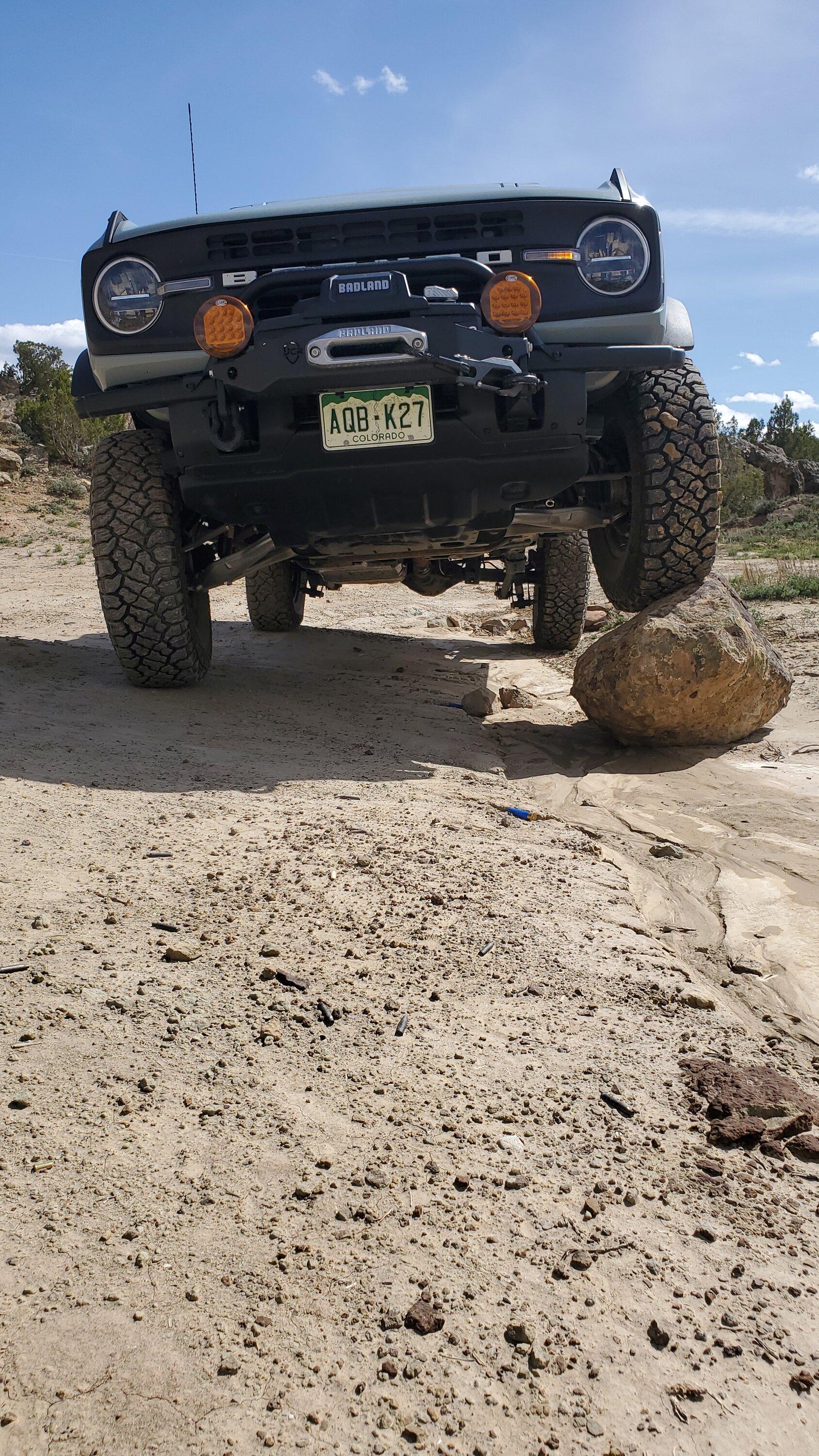

What offset are you going to go with to keep a good scrub radius?
I bought a BD and installed 35-10.50R17 tire on the stock steel wheels. I then purchased 1.25" Bora Spacers and have a positive offset of 23.25, which is a quarter inch less positive than a SAS model.
From stock, as you go bigger in tire size, you need to push the center of the contact patch out further.
Ford Bronco Wheel spacers 20220425_152020
