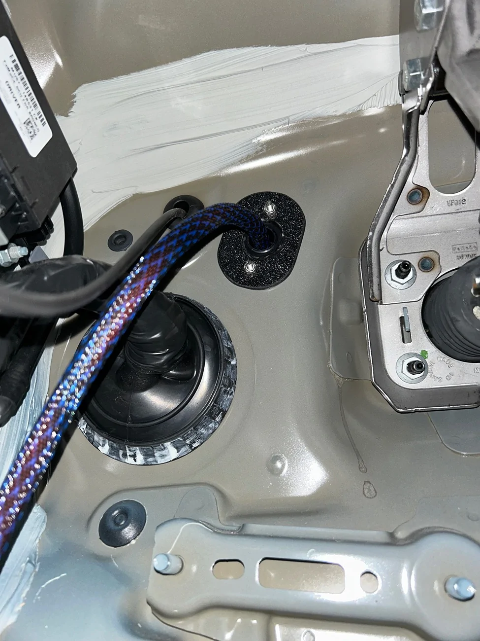

Where are you folks running wiring through the firewall?
BK1
Apr 20, 2021
108
113
SC
C8, GMC At4, BMW
It pops out very easily from inside. Spray a little windex on it from under the hood and it comes out very easily. Also much easier to put back in from inside. Windex or dawnare your friend. Also a drop of dawn on the small slit will make pulling the wire a little easier.

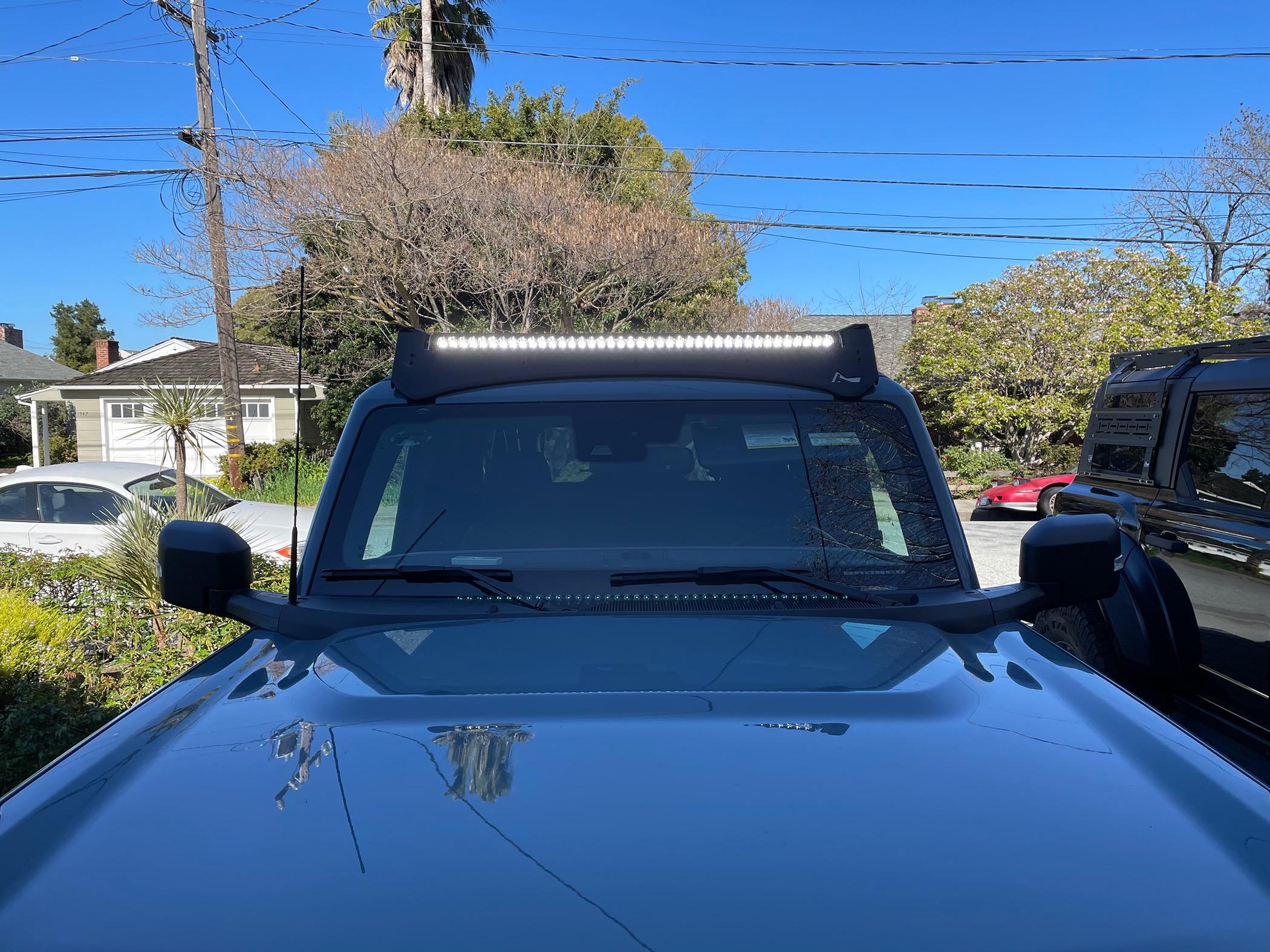

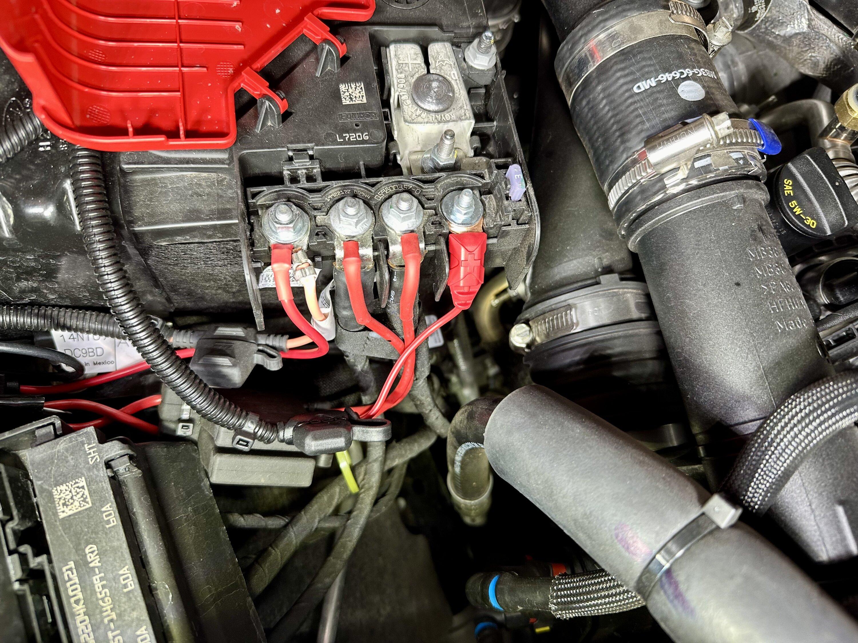

I believe the one on the far left is running to my light bar. The middle two go to the ARB compressor, and on the far right I have an on-board trickle charger.

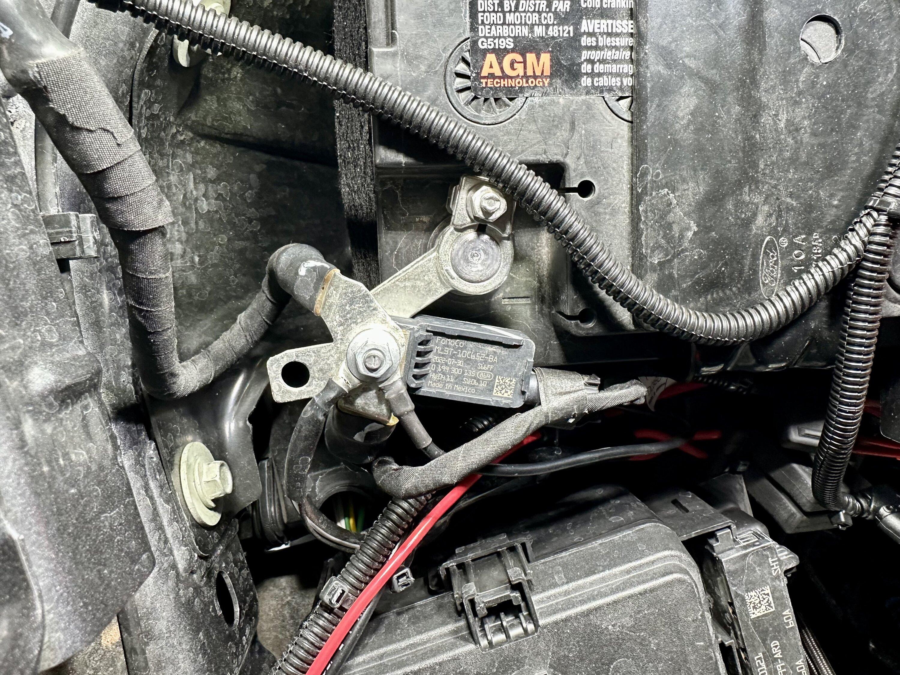

For the negative terminal, I'd connect on the bolt where the BMS is connected, like below.
Thank you!!
