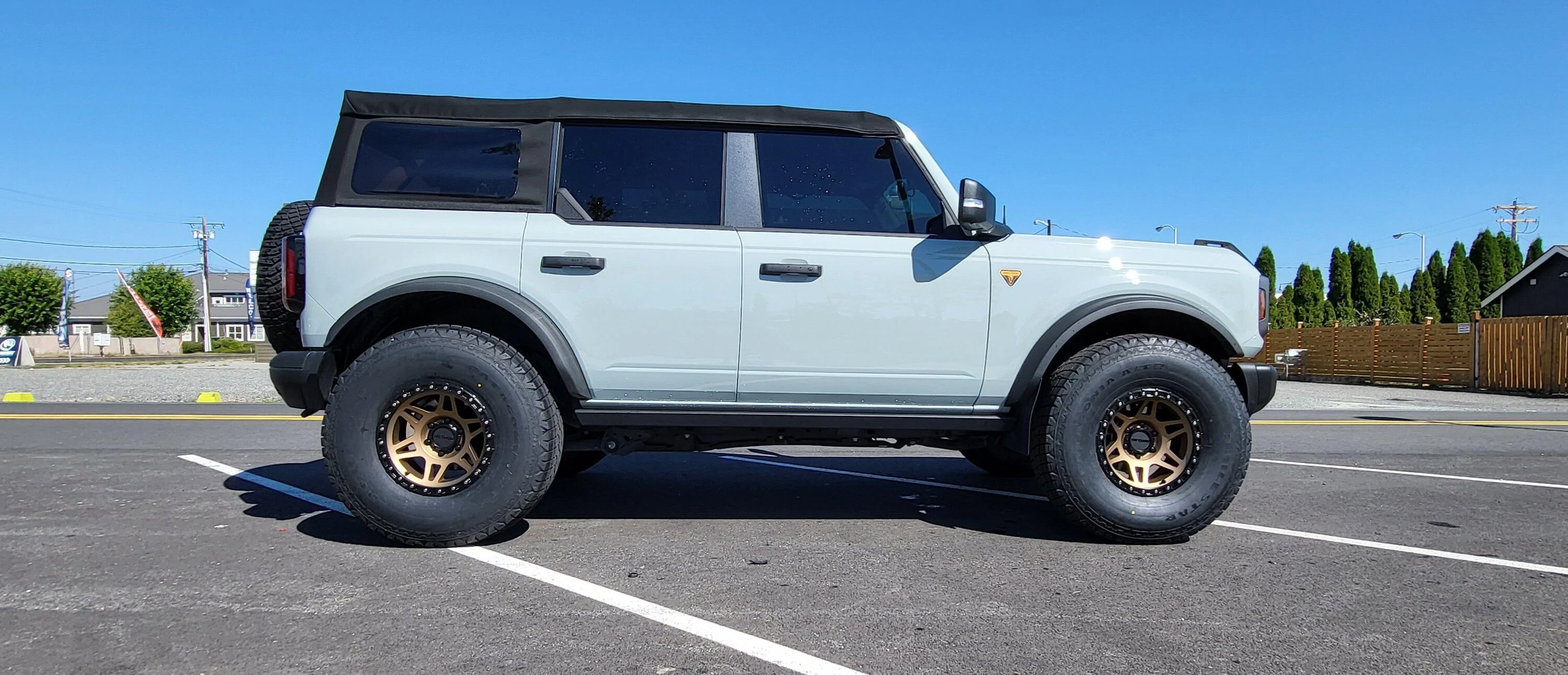

Added Sasquatch springs and shocks but the first set of pics didn’t have Sas rears on yet. This is full Sasquatch suspension with factory rake and all.
35’s or 37’s? With just the sas I’m thinking 37’s but they look ginormous (which I like lol)

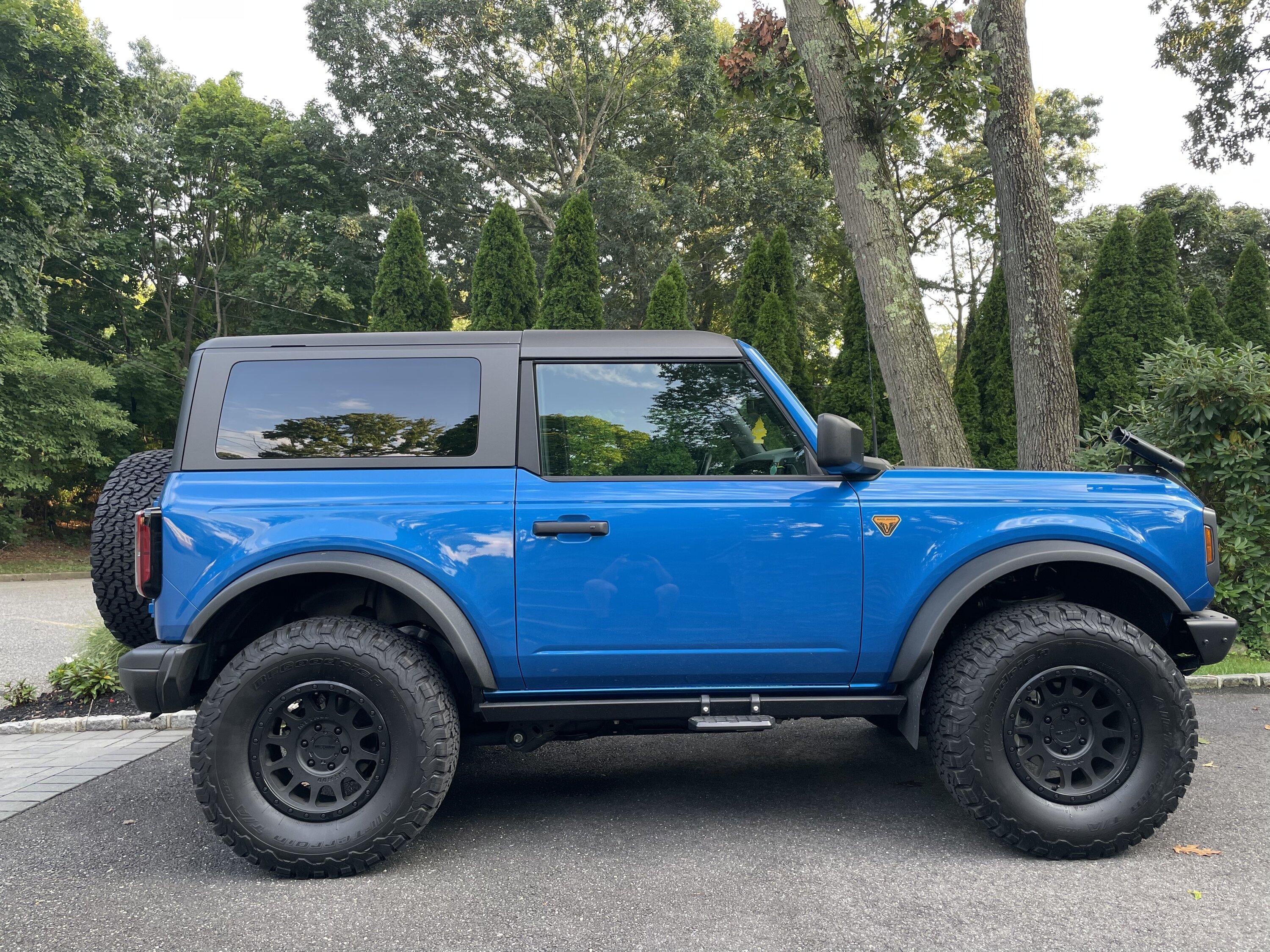

35s. It might be the angle of the shot. I’m sitting down on step pretty low to ground. its still pretty aggressive looking, especially on 2 Door….even with moderate +25 offset.

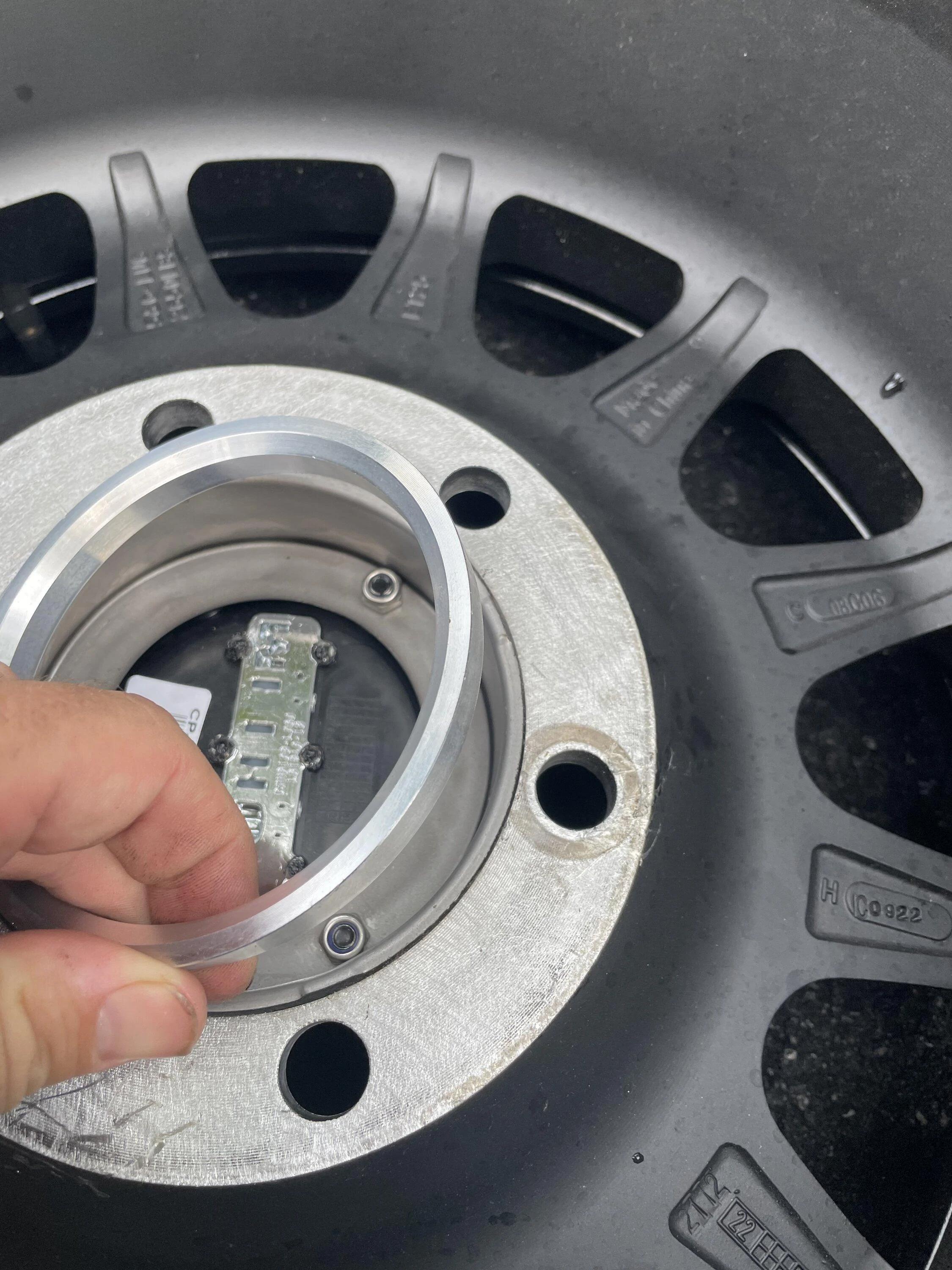

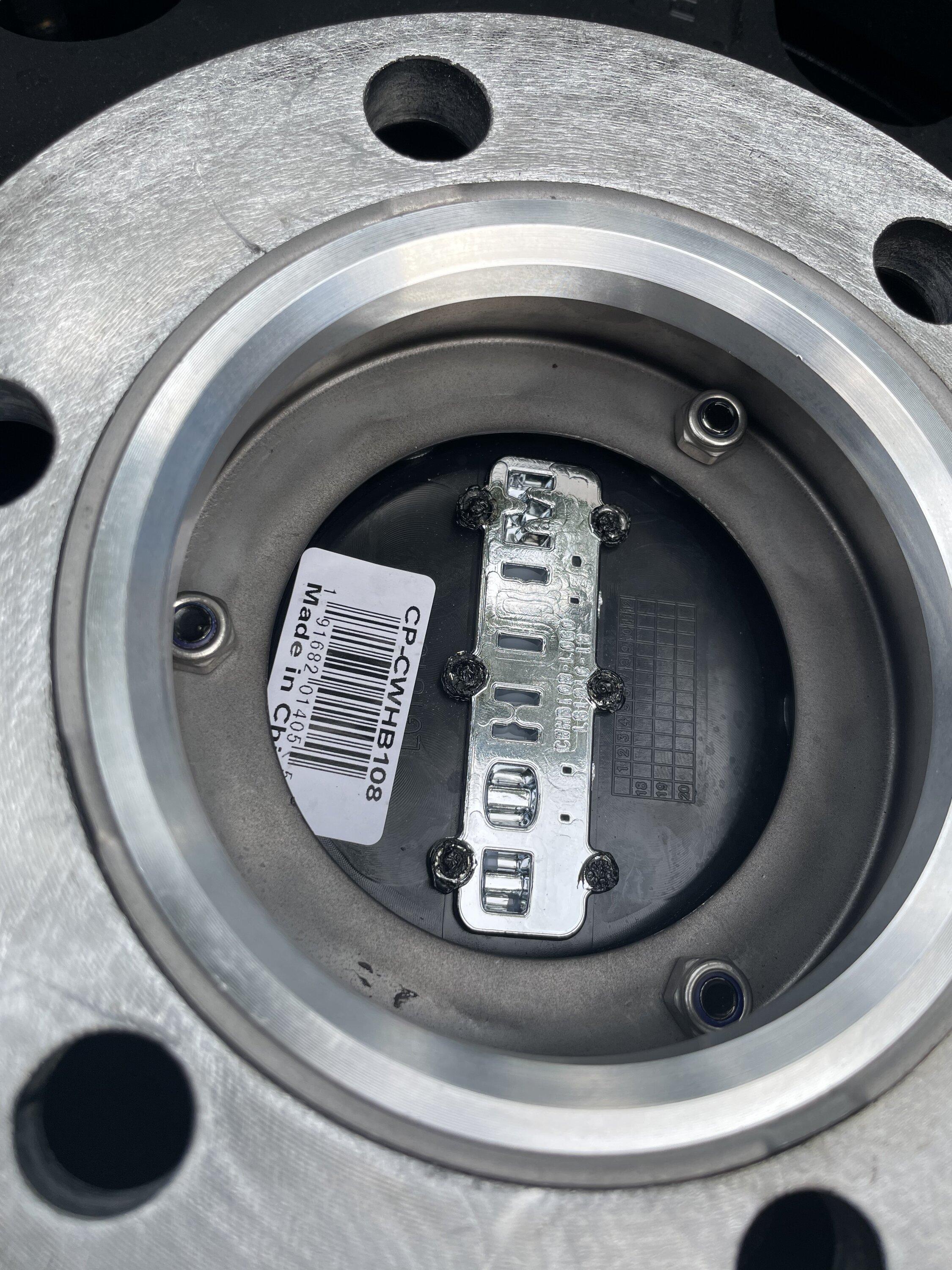

I got some aluminum ones
and the flush caps. I guess the rings sit inside the flush cap? See pic. Method said they aren’t necessary but I have some vibration over 80 mph and want to see if these help.

Hub rings fit if you have the flat center caps. Just not with the push through. I have flat caps on my 305’s

I think they fit the larger caps which are also push through, but didn’t test. The Rings I got on Amazon are OD 106.1 MM and ID 93.1mm.
