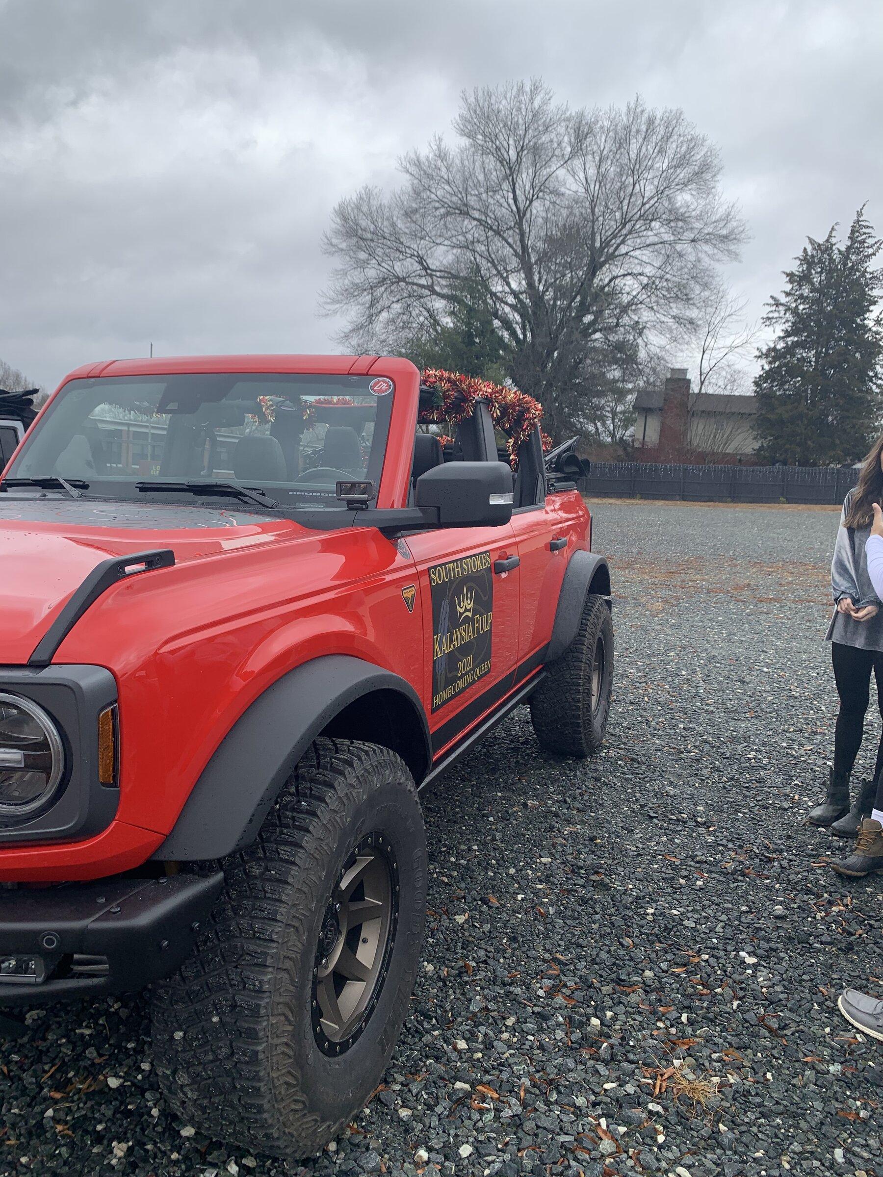

Ford Bronco Will a 0mm offset be too much poke? B9B89C92-5EE1-47F9-B1CE-C6735370AAE4
0 offset ICON’s with the stock Sasquatch tires, Sasquatch package.
Yes there are rock chips.
too much poke?
It’s a subjective question.
For me, no.
For some others, yes.
For some others, not enough.
You can gauge your desired level by this pic.
too much poke?
For me, no.
thanks for the photo, that gives me a pretty good idea in terms of poke. do you have any rubbing on sharp turns?

Keep in mind the picture above is with SAS flares. Zero offset will put the tires beyond the standard BD flares.
yes. i think i was going to order some of those from the factory and throw them on even if i don’t get different wheels. i’ve seen too many threads about rock chips for me to want to keep the non squatch fenders
Zero rubbing. With the 35's.
If I went 37's, they technically would fit. but would slightly rub at full lock, and of course, compromise articulation room.

about 1.2 inches further out than a Sasquatch wheel, With 33's that would fit on an 8.5" wheel, I don't believe you would have rubbing issues.
thanks for the measurements. i think that pretty much seals the deal on my wheel choice.

BD wheels are 7.5-inches wide with +55 offset. If you go with 17x8.5 wheels with 0 offset, the lip of the new wheels are going to sit just shy of 2-3/4 inches further outwards. As long as you do not go to a wide 33,. you should be in good shape.
