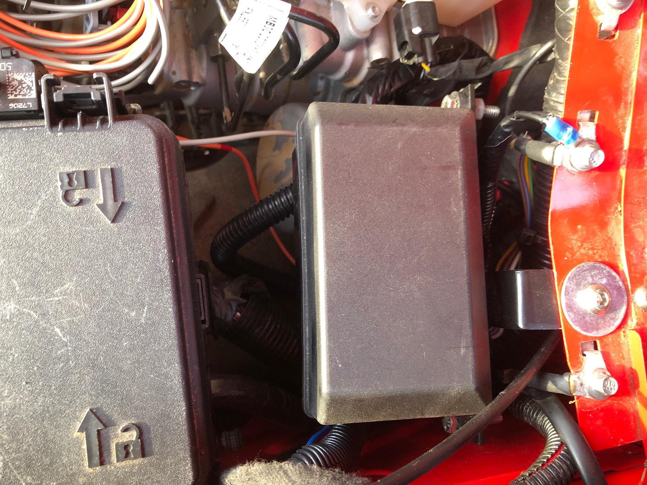

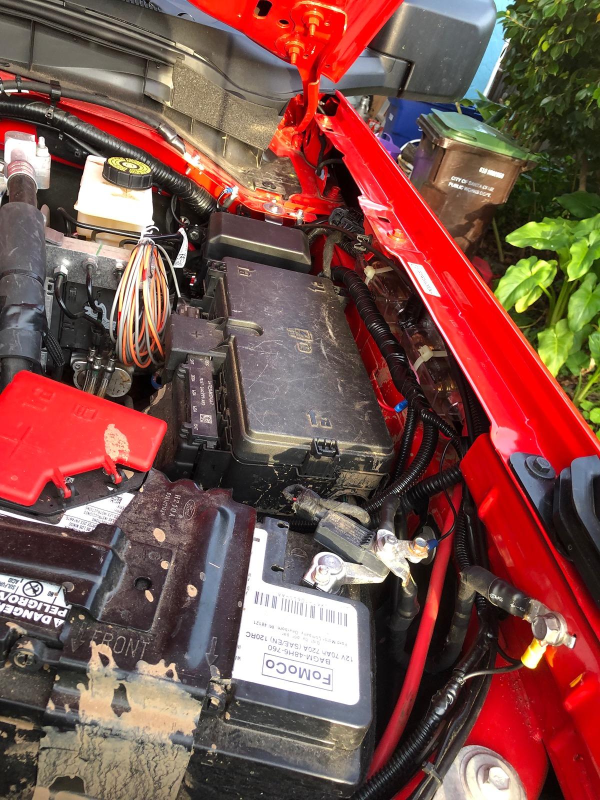

I put a 500 amp on mine…150 is way low…150 on my stereo…
Ford Bronco Winch fuse? IMG_3064
What's the black box above your fuse box? Some sort of aux fuse box perhaps??
If so... interested... been shopping for one for awhile now.
