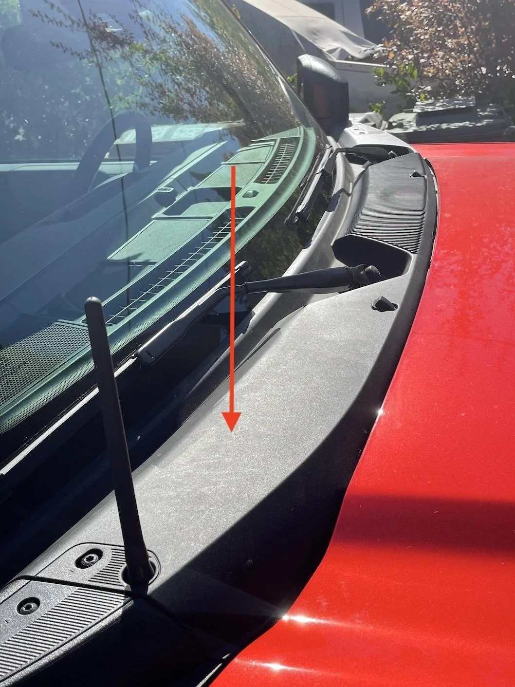

After having my Windshield replaced I noticed that the windshield wiper sprayer isn't working. I thought it may be clogged but it looks like the fluid reservoir is empty...so I added some fluid (I didn't have much, only about a quart but good enough for a test). All good until I started the ignition and tried to spray wiper fluid - it immediately all leaked out! It came out along the body, dropping on the ground. This is a view just back of the right front tire - the arrow points to where the drips came from (it was a stream while it lasted).

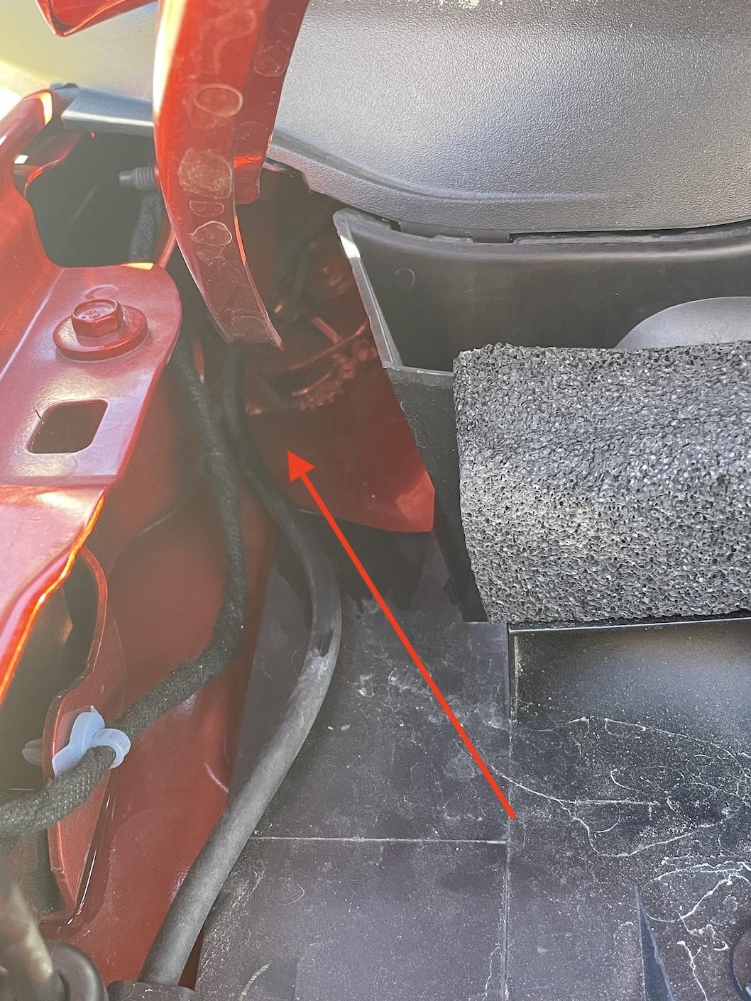

Looking under the hood, the area close to under the windshield is wet with wiper fluid:

So: I suspect that, when the windshield was replaced that the wiper fluid line like wasn't hooked up correctly. Before I go back to the dealership I'd like to see if I can find the leak and fix it myself (the first dealer appt is in two weeks). I will need to remove the plastic piece at the base of the windshield that houses the windshield wipers- the long piece:
Ford Bronco Windshield Fluid Leak - Line Not Hooked Up? IMG_0757
Does anybody know how to remove this housing? And how to remove the wiper arms? I'm not a mechanic but can follow a recipe. Anybody removed this before?

Same thing happened to me. The barb fitting is near the antenna, under the cowl. You can take the antenna off and gently pry the cowl up and reconnect it, without having to take off the wipers.

Throw a zip tie on it for good measure. In other vehicles I’ve run into the line not wanting to stay seated once it had been pulled off the barb and put back on. Would blow off first or second time I’d use it until securing it with the zip tie.

Fixed! Thanks everybody for your suggestions, in particular @Dingbat and @Razorbak86 - the solution I went with was to take the antenna off and gently pry the cowl up. The windshield hose was hanging loose when it should have been connected to a barb fitting. I pushed the hose tightly into the barb fitting - worked like a charm. No more leak. I suspect it just wasn't reconnected when the windshield was reinstalled.
