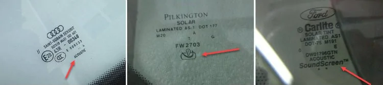

When my F150 Windshield cracked, they tried to use a factory non sound deadening replacement. So just specifying a Ford replacement may get you a cheaper version.
You can do a search to see how to determine what glass you currently have, here's one article I found.
Acoustic Glass Identification
Ford Bronco Windshield Defect are-all-windshields-acoustic-glass
Yea the sound deadening ones are Soundscreen shields and will be labeled as such. Dealt with the same problem getting one replaced in a Limited F150. Cheaper trims didn't get the Soundscreen and it's seriously impressive how much of a difference there is.
Glass company used one that said soundshield rather than Soundscreen, while assuring us they were the same. They ARE NOT.
Going from a Soundscreen to a normal windshield makes it sound like you have a window cracked at all times.
I was unaware you could get a Soundscreen in a Bronco though. That would be a welcome option.

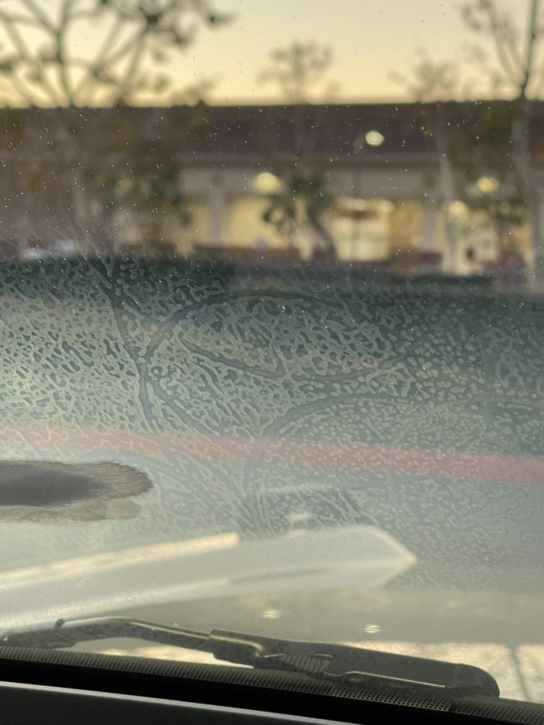

There are lots of smudges from plastic protection film I’m assuming and marks from suction cups. Does anybody else have this issue and if so how did you remove it? I tried water/vinegar and IPA/water with no results. I’ve also used multiple cleaners and can’t this to come off. I thought it was on the inside of the glass but now I feel it’s between the two pieces of glass. It really shows up if the window starts to fog up like in the photo or if the sun hits it just right. We took it to the dealer and tried buffing it out but that did nothing. They’re going to order a new one and hopefully they’re not back ordered.

We took it to the dealer and they tried to clean it with a "strong" cleaner but it did nothing. They ended up replacing it that matched the factory one about a month ago. I think all the smudges and cup marks were between the two pieces of glass. The last thing I tried was a razor blade with a lubricating cleaner and no luck there also.

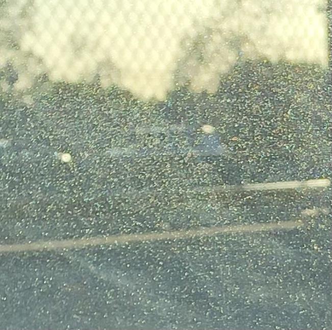

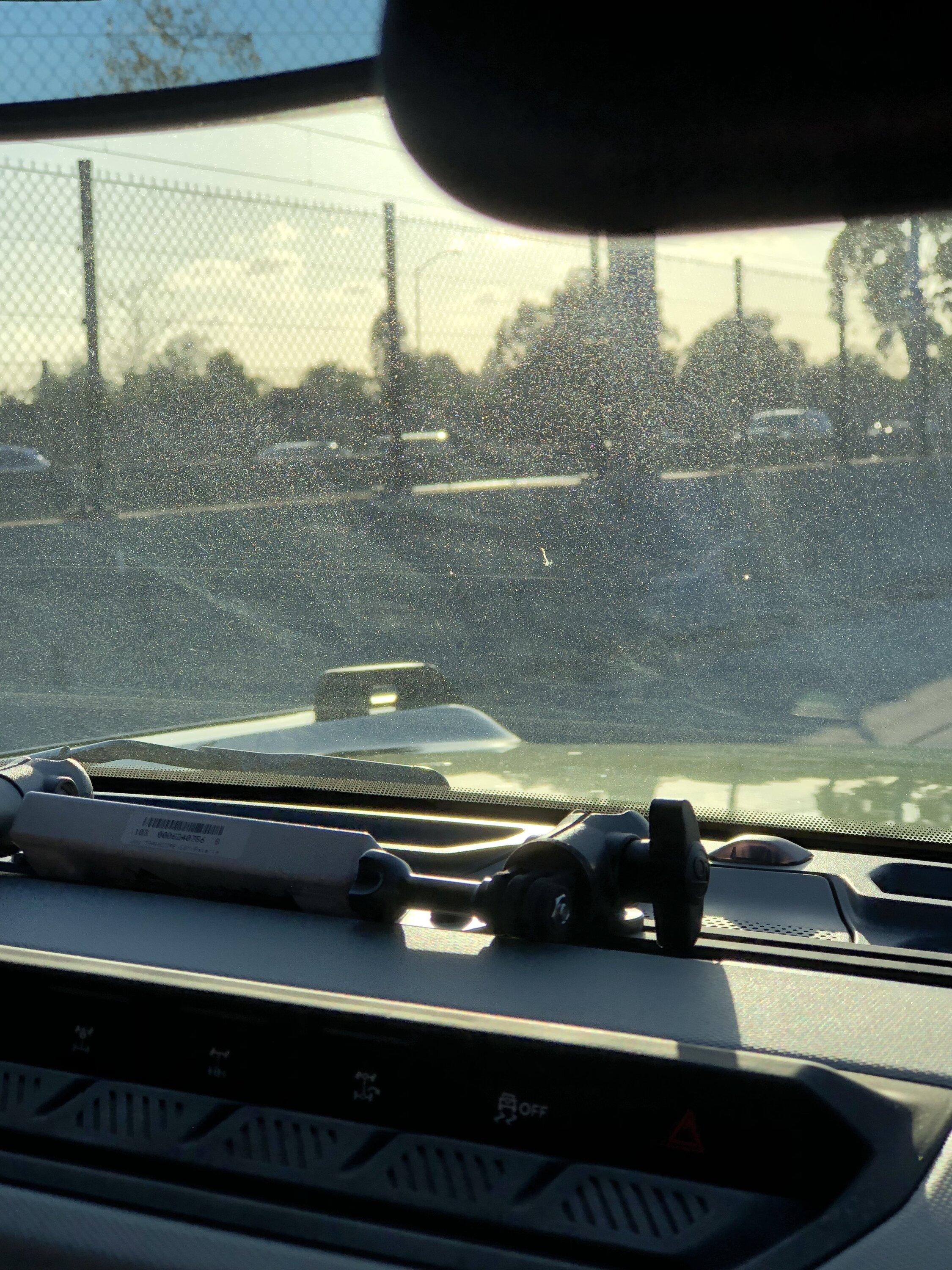

My windshield also has the same defect with weird sparkles/specks that seem to be in-between the glass like your picture on the top half. You see it when the light hits it right and it's hard to see through in some areas. I am going to take it to the dealer and see what they say. Did you get it fixed and what did they say it was?

Dealer replaced it under warranty with a factory one. And I don't know if it's the replacement one or all Broncos but it's very pitted. When the sun is on it, it looks like the Milky Way. We only have 14,000 miles on it.

That is wild, it would drive me crazy. Definitely looks like something wrong with the laminated plastic between the layers.
