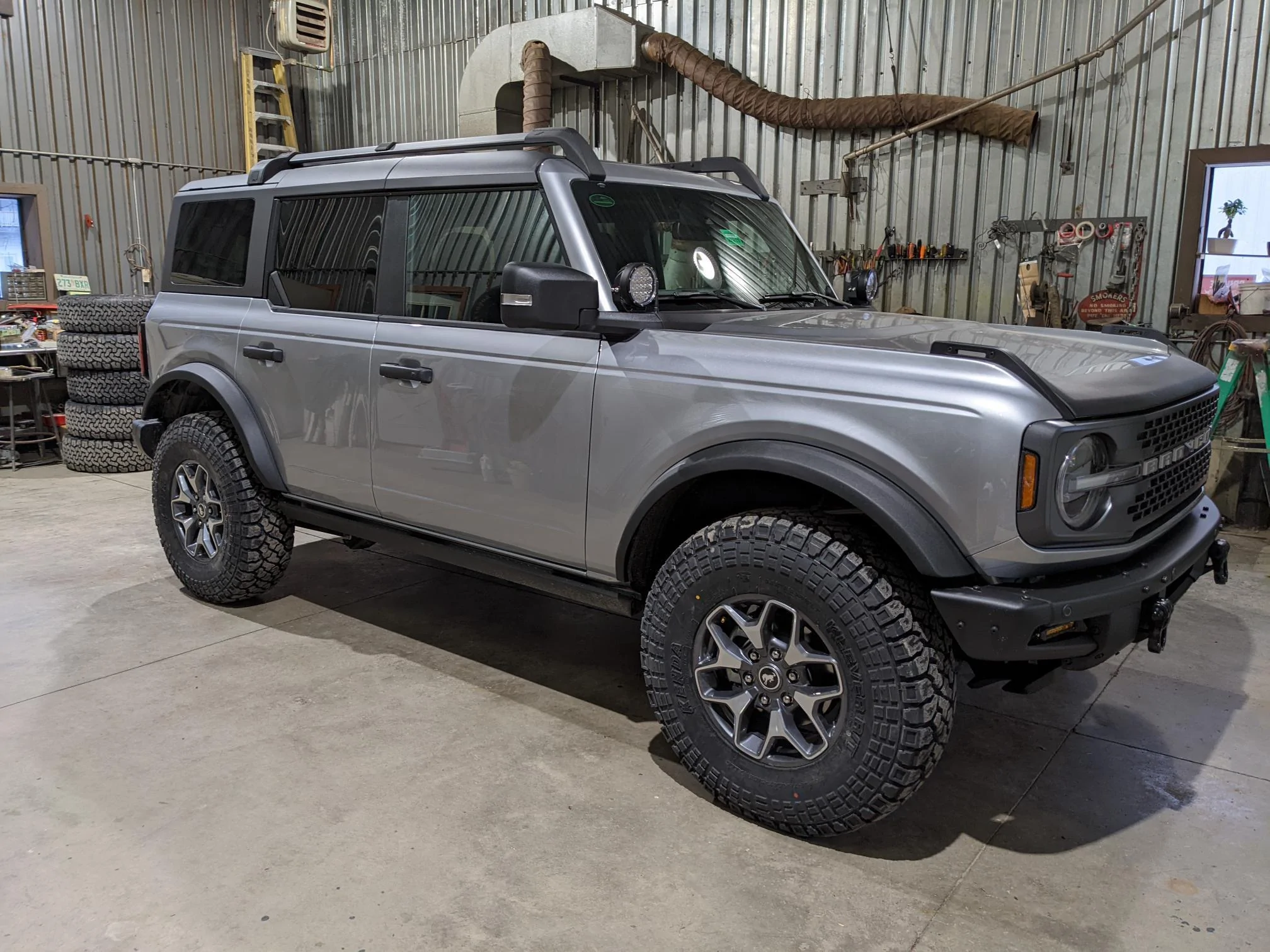

Ford Bronco “Stock” Non-SAS Badlands with 35’s IMG_7211
Black Diamond no lift with 35s. Had to remove front and rear crash bars in the front wheel wells.
runs fine but tanked the gas mileage and acceleration/handling a bit.

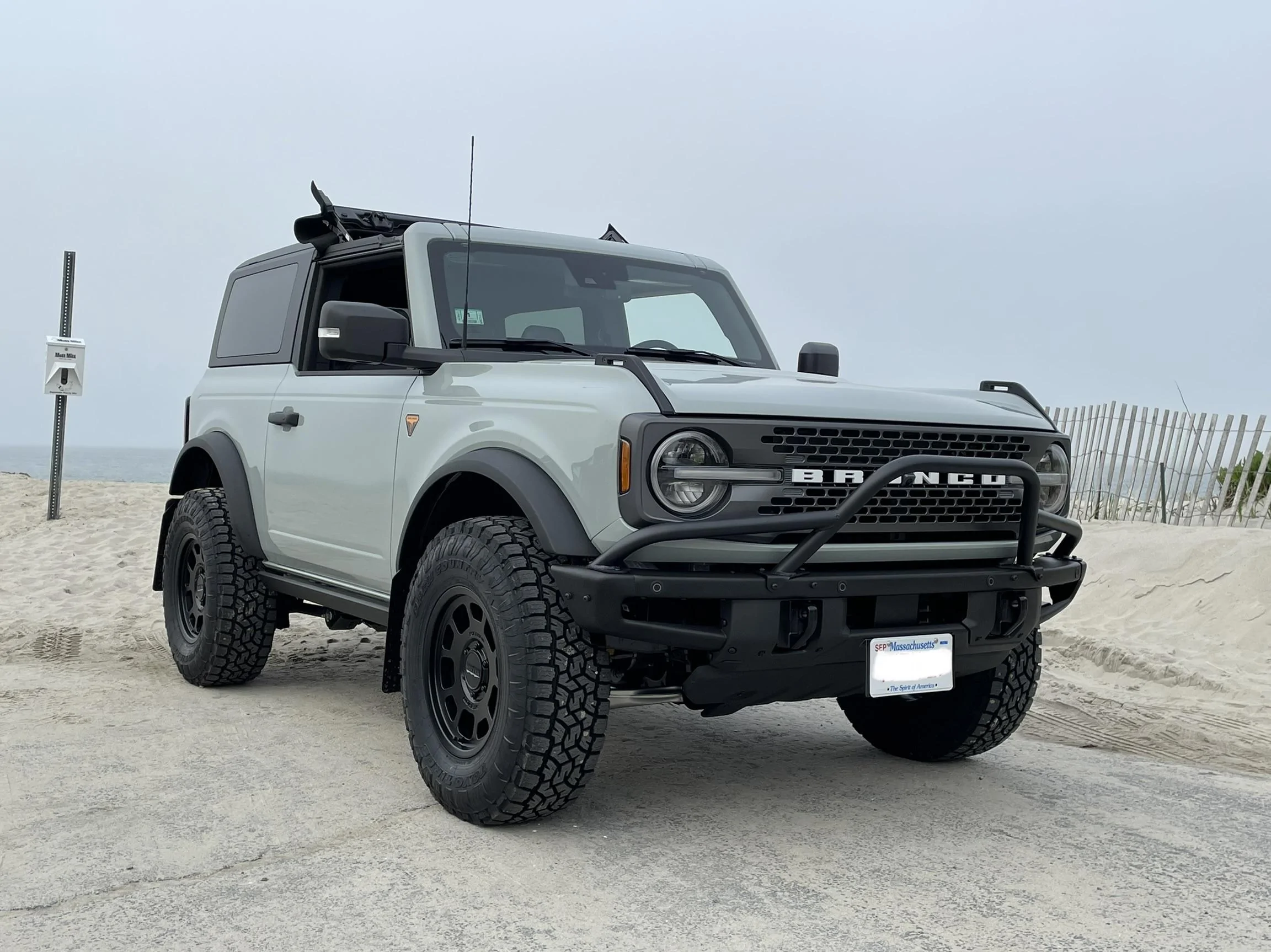

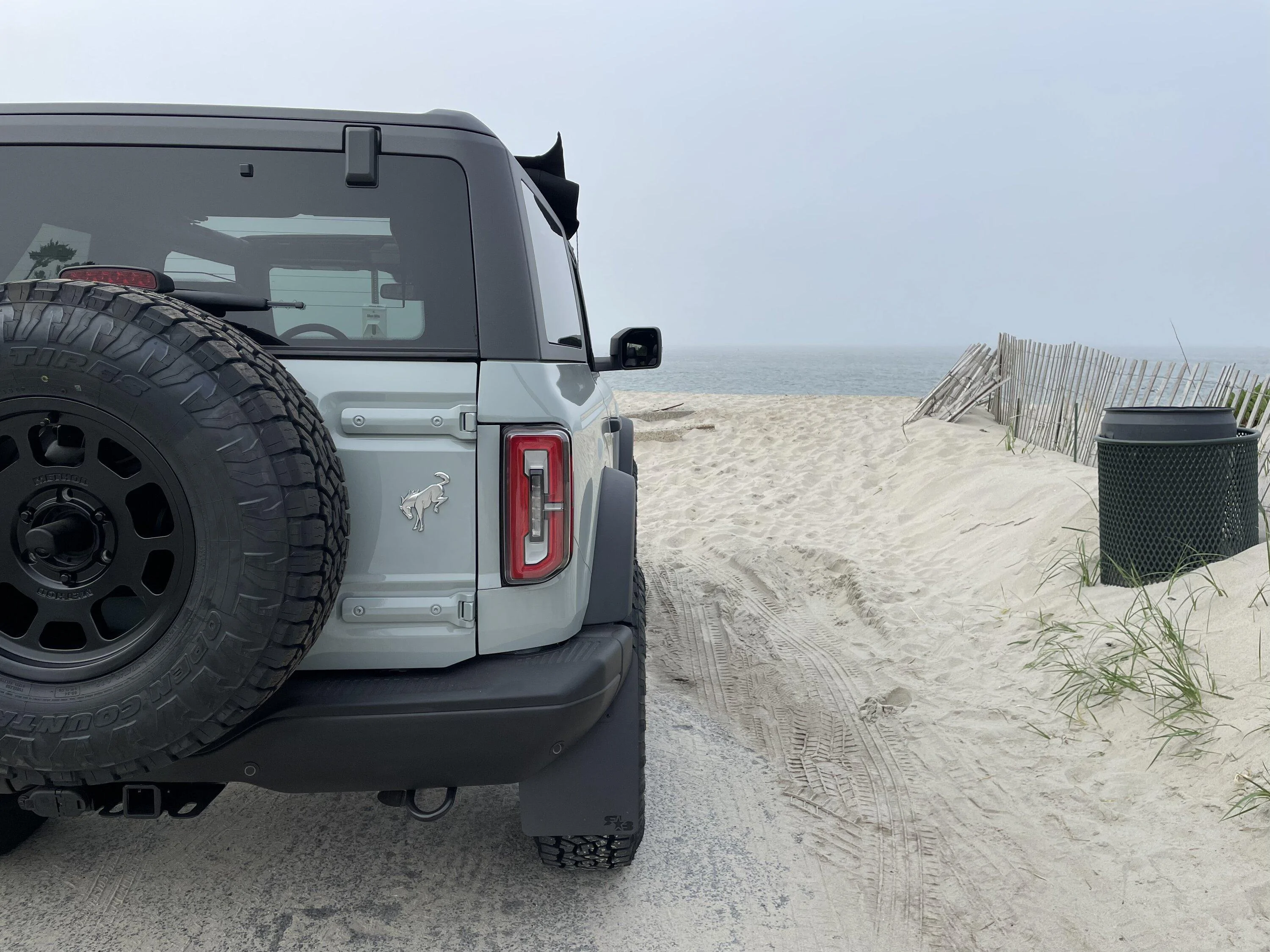

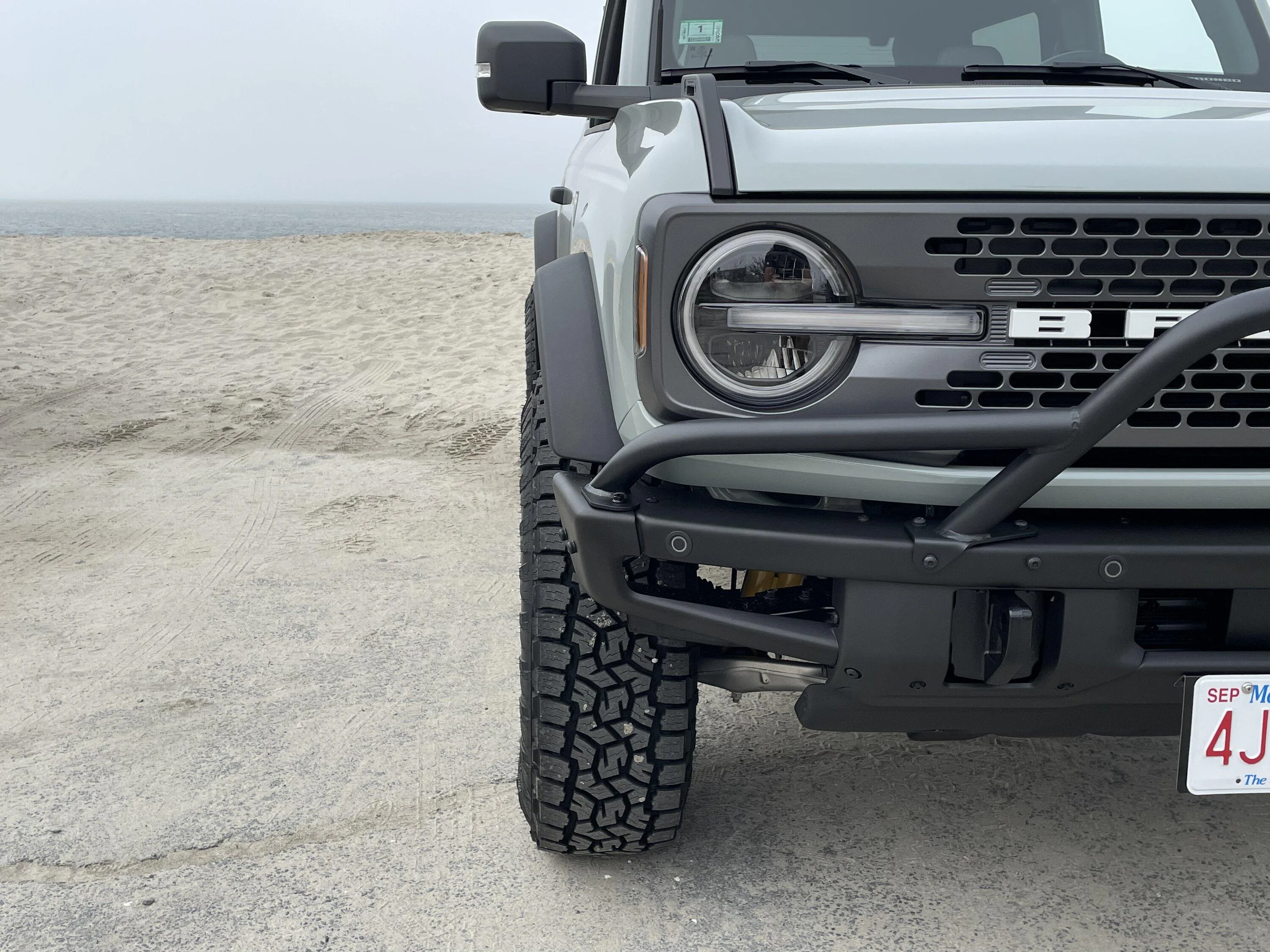

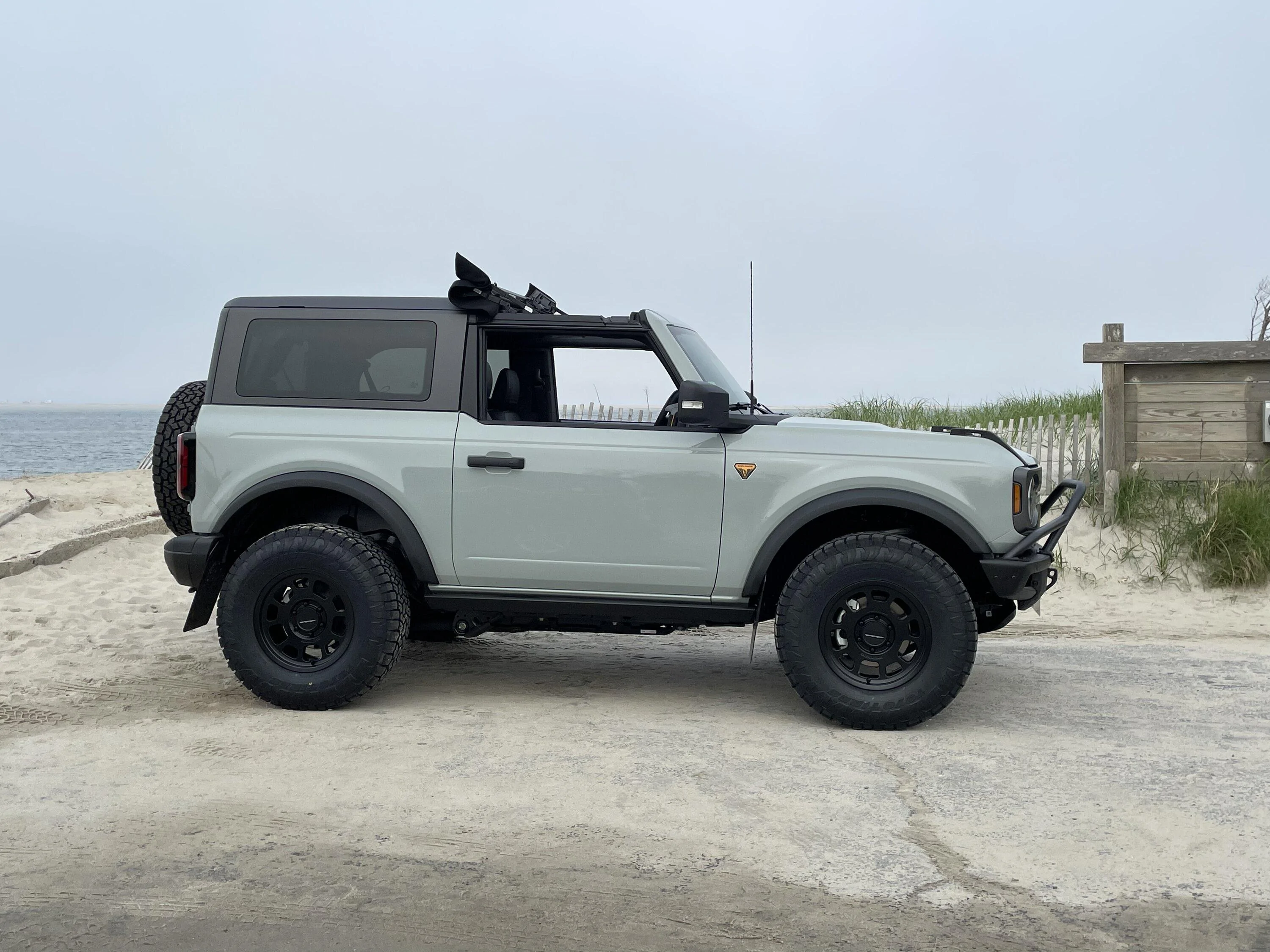

Mind posting a pic of your setup along with the wheel specs as well?

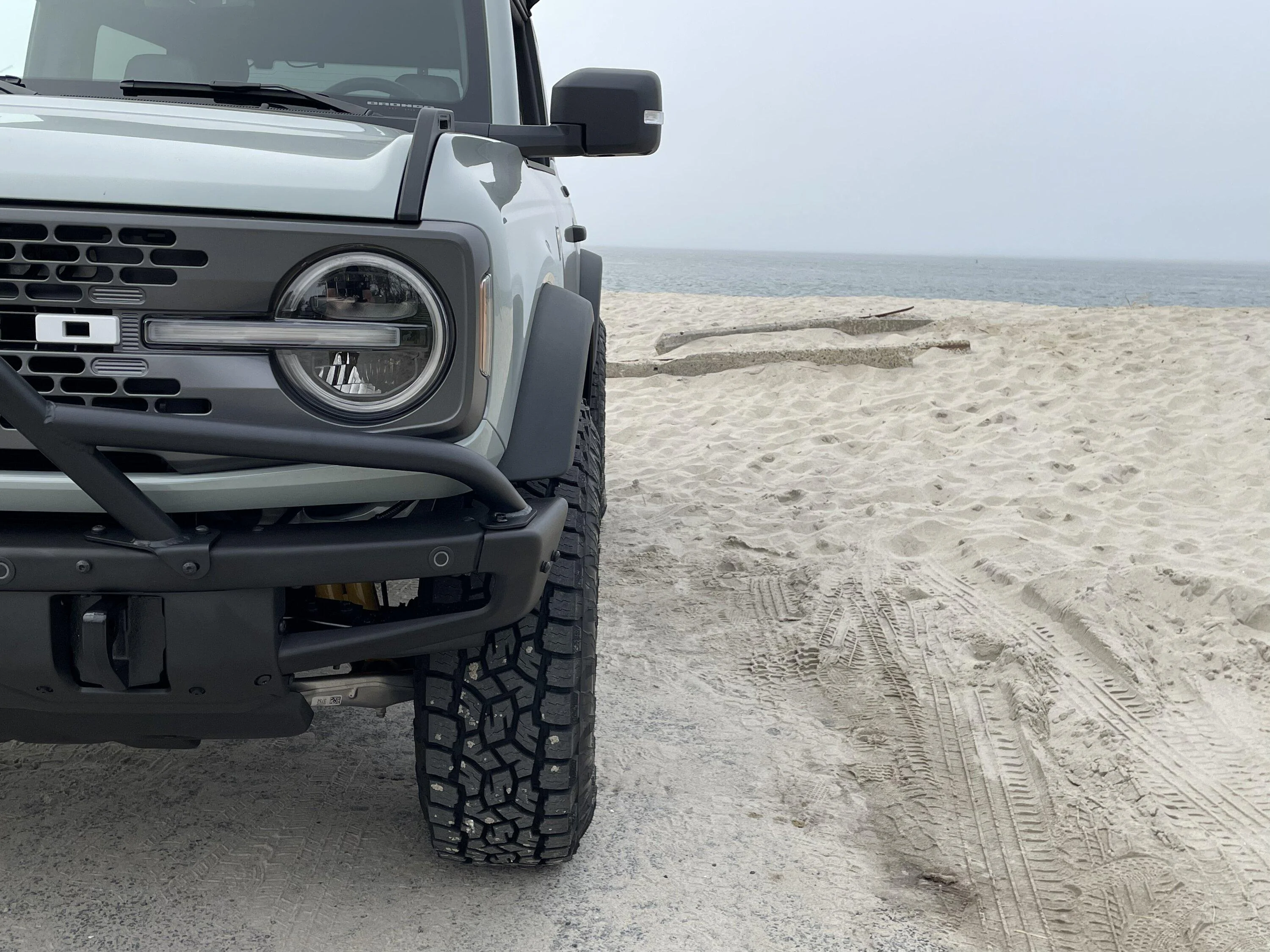

Non SAS, no lift, all crash bars still in place, no rubbing issues flexed out. Wheels are Method 17x8.5 +35mm, same size as the new Ford Performance Methods. I am planning on adding a 1.25” front leveling kit in the front when I get time to install.
I was very deliberate when choosing my wheel and tire upgrade, I wanted to keep the tires narrow and within the stock flares. I’ve gone too big in the past and ended up with rubbing, undergeared, submarining the MPG, or slinging mud and rocks up the side of the body. I didn‘t even have 50 miles on the Bronco when I purchased wheels and tires. With the 2.3L I was skeptical that it would turn 35“ or 37” tires well even with the 4.70 gears on the 7MT. I’m very pleased with the results. It drives the same as stock, but first gear is slightly more usable. The handling is still great and the truck is very stable. I still average 17 mpg city and 20+ highway. I’m giving up maybe .35” of clearance under the axles compared to 315/70R17.

Do you have details on which wheels/tires you got? I'm curious about the offset you had to get to achieve the correct geometry.
Wheel details are in the post you quoted, Method 17x8.5” with +35mm offset. I measured the outer edge of the tire sidewall (yardstick across the vertical plane) and the outer edge of the tread front and rear (small metal ruler from the yard stick) to calculate how much offset would work. I was sticking with 285mm wide tires, same as the stock BFG’s. Wider tires would’ve required more positive offset to keep the tread under the flares. I found a place I could articulate the suspension and took measurements with the front tires at their max steering angle to look for issues, there was plenty of clearance even at the crash bars. I was only pushing the tires out 20mm and adding 1/2” of radius, so if I could fit a finger between the edge of the tread and the crash bar it was enough space. I was also considering the 35x10.5R17 Kenda tires, they would’ve fit fine. I was concerned about the extra weight of the Kenda, 9# more per tire than the Toyo OC3. Hopefully that helps.

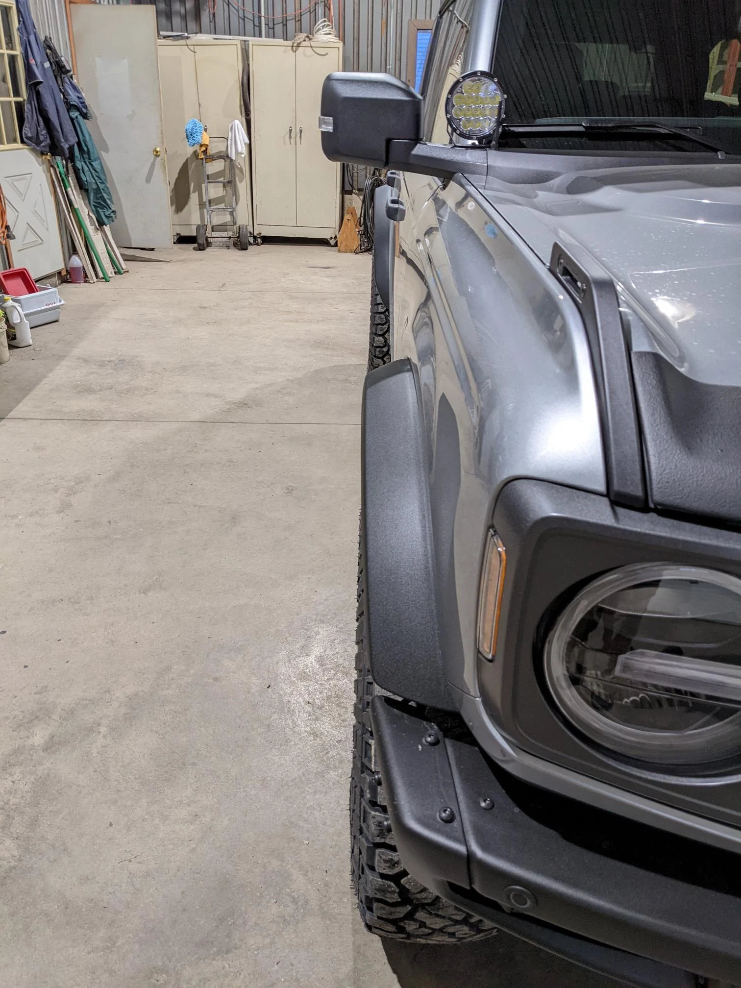

Here's my non-Sas BL when I was running the Kenda 35" x 10.5"s w/o spacers, cash bars removed
