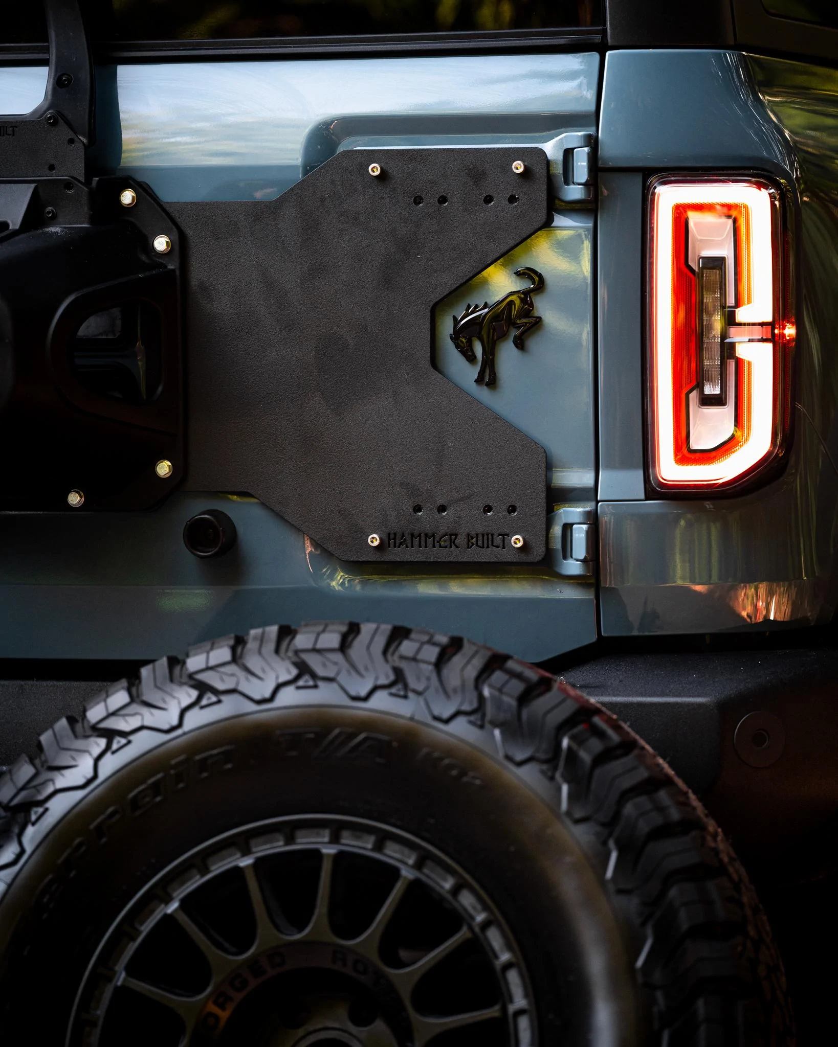

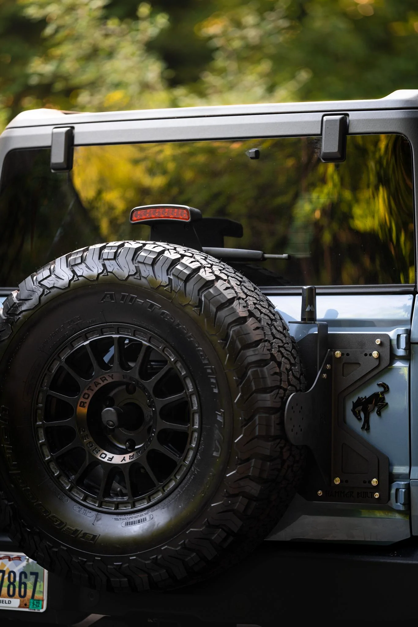

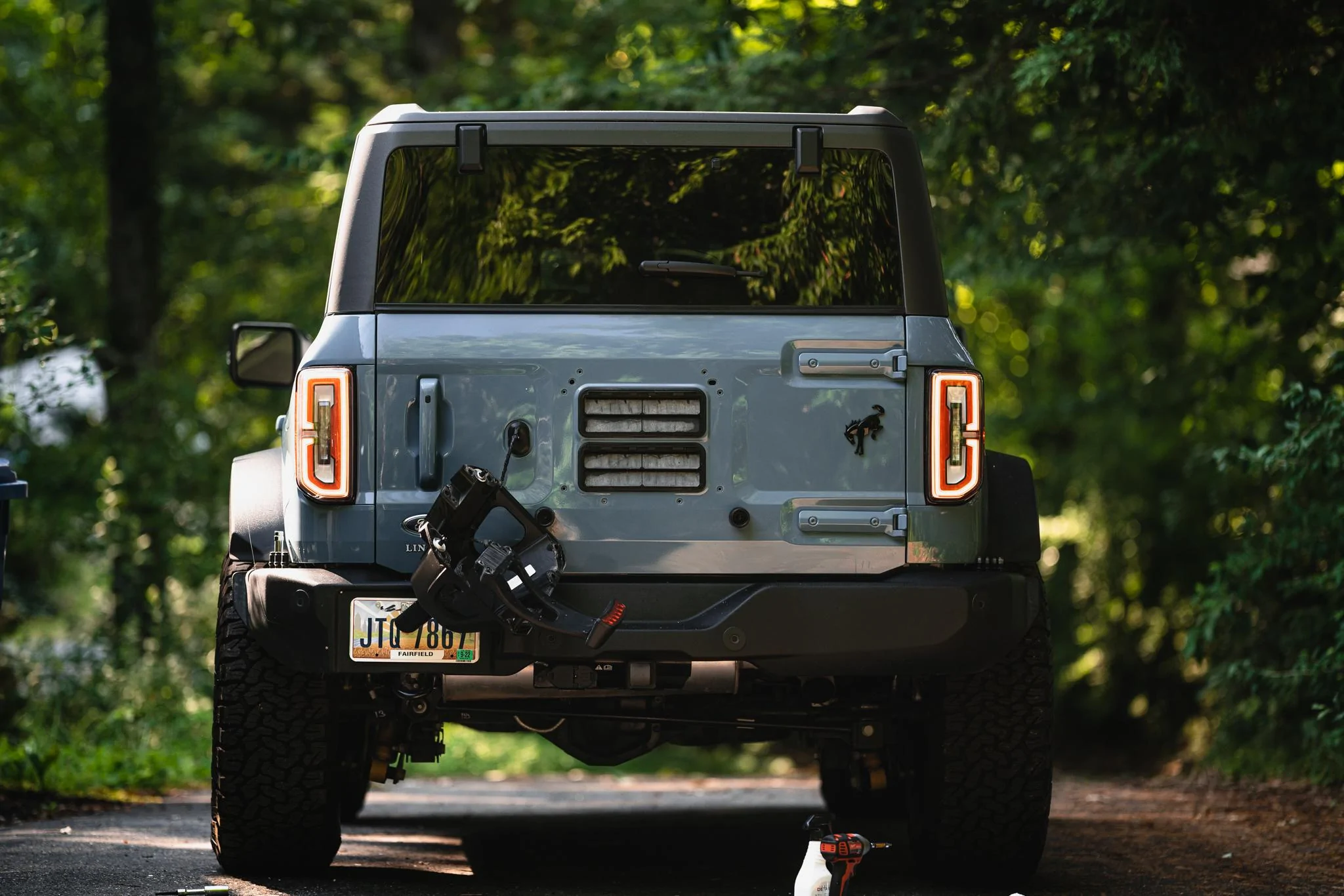

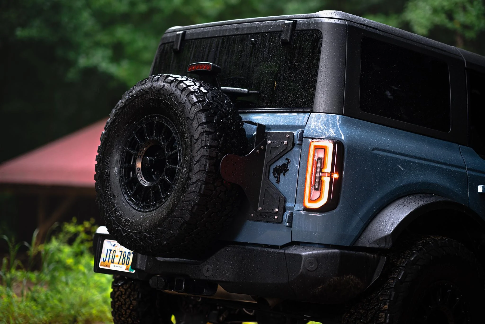

Now just the MaxTraxx mount to go boys! Tried to take pics of the install bit by bit for anyone looking to go with this system. Great quality especially in the powder coat department zero noise or wiggles

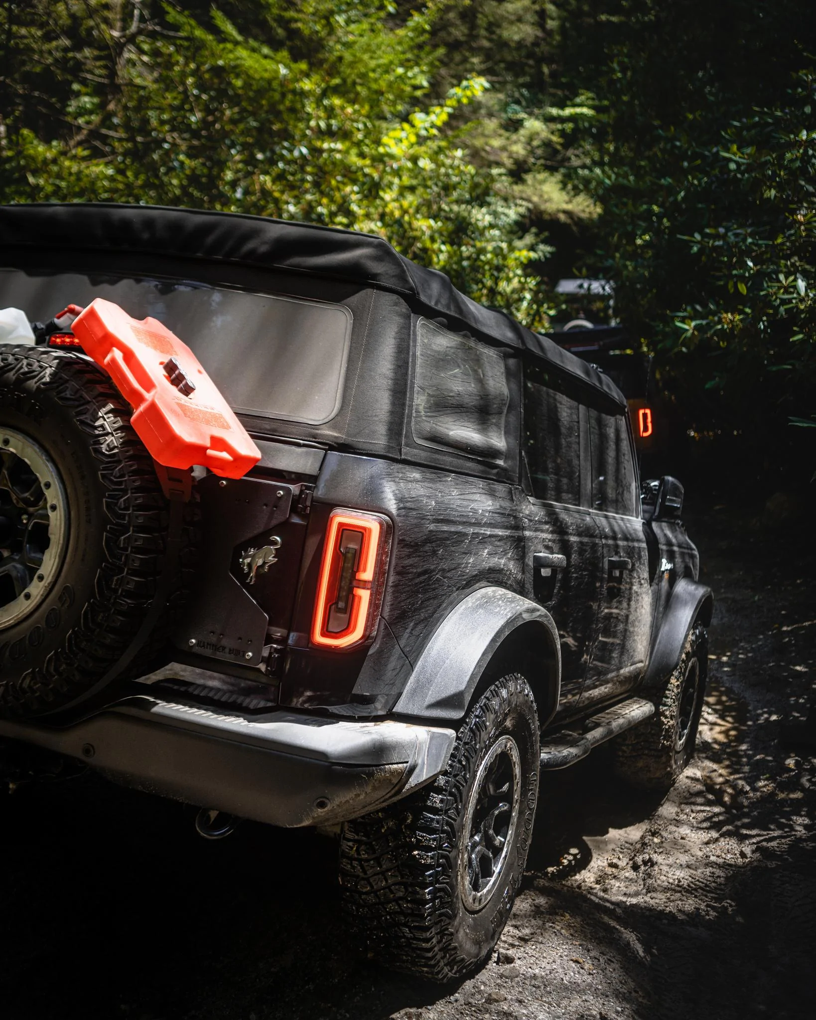

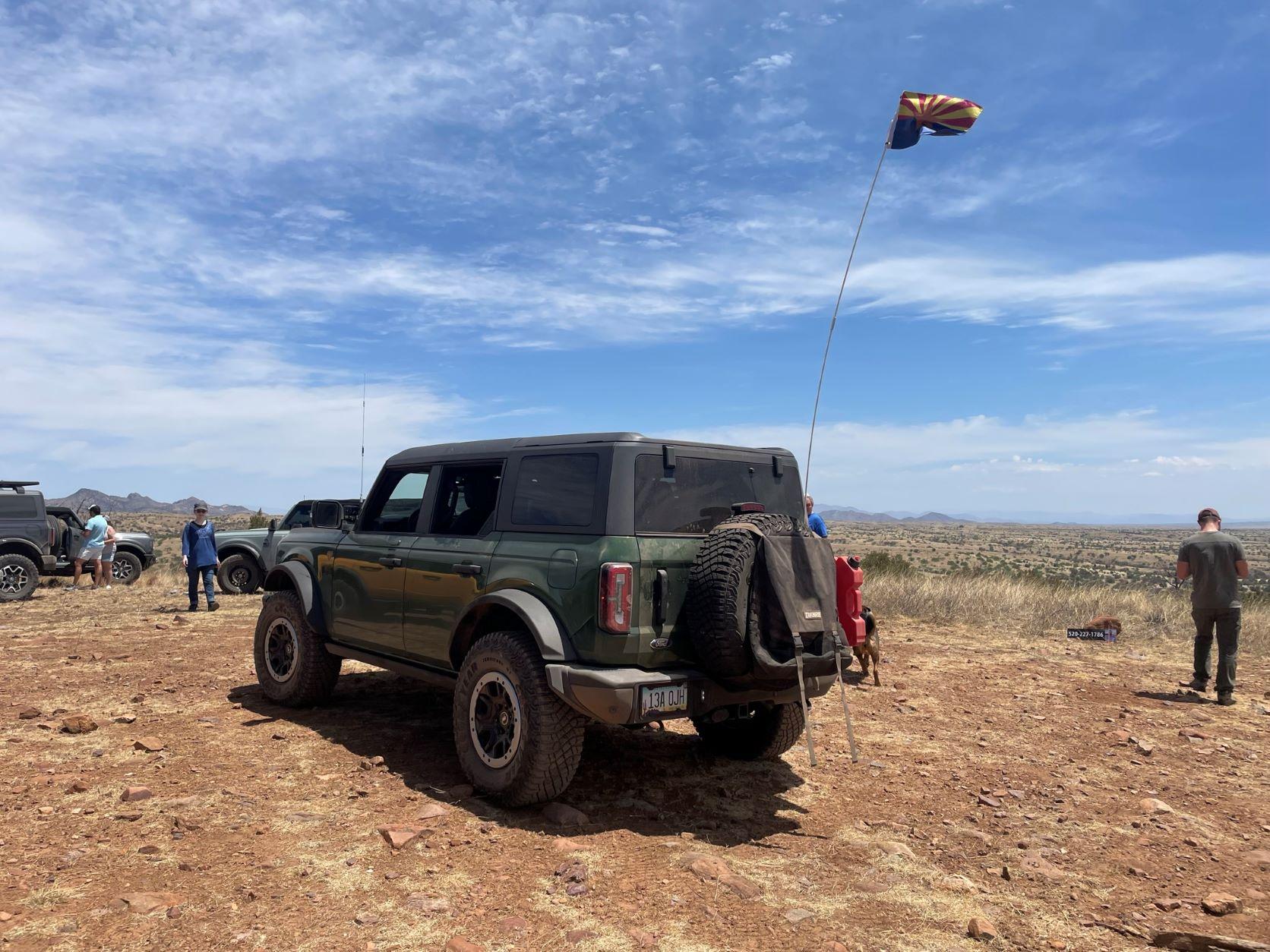

I love my hammer built reinforcement plate. I also have the rotopax and flag/antenna mount. Only one request is a limit strap so I don't destroy the tail lights with the rotopax lock bracket. I understand that a shorter gas spring could help but that seems like a lot of stress on the little ball joints at the end of the spring.
You can't see the mount in the picture but the flag and the rotopax make it clear something is there.

we're testing out the final gas strut that limits the tailgate opening to save the taillight!
Lots coming up in the next few weeks!!!!

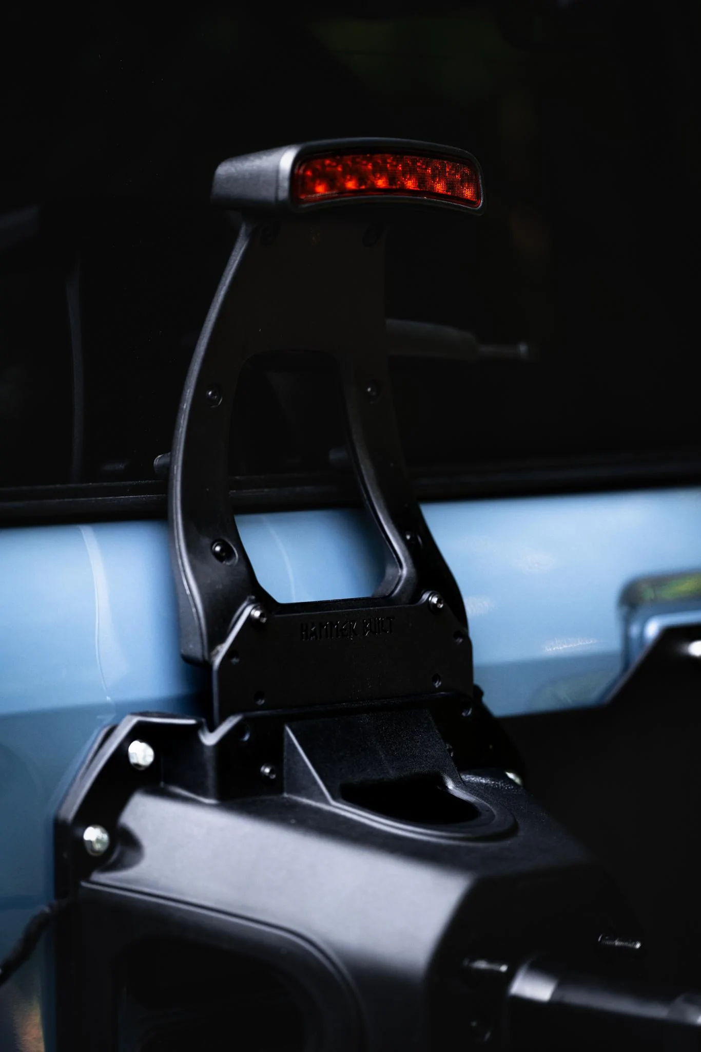

When I installed the tailgate support system, I did not install the third brake light extension. You don't need it unless you are going with 37" tires. By not installing the brake light extension, I have better visibility out the rear view mirror.

Correct, the Sasquatch equipped broncos do not need a extension...
Pointing out a non Sasquatch bronco that upgrades to 35" tires will need the third brake light extension. ( in most cases)
