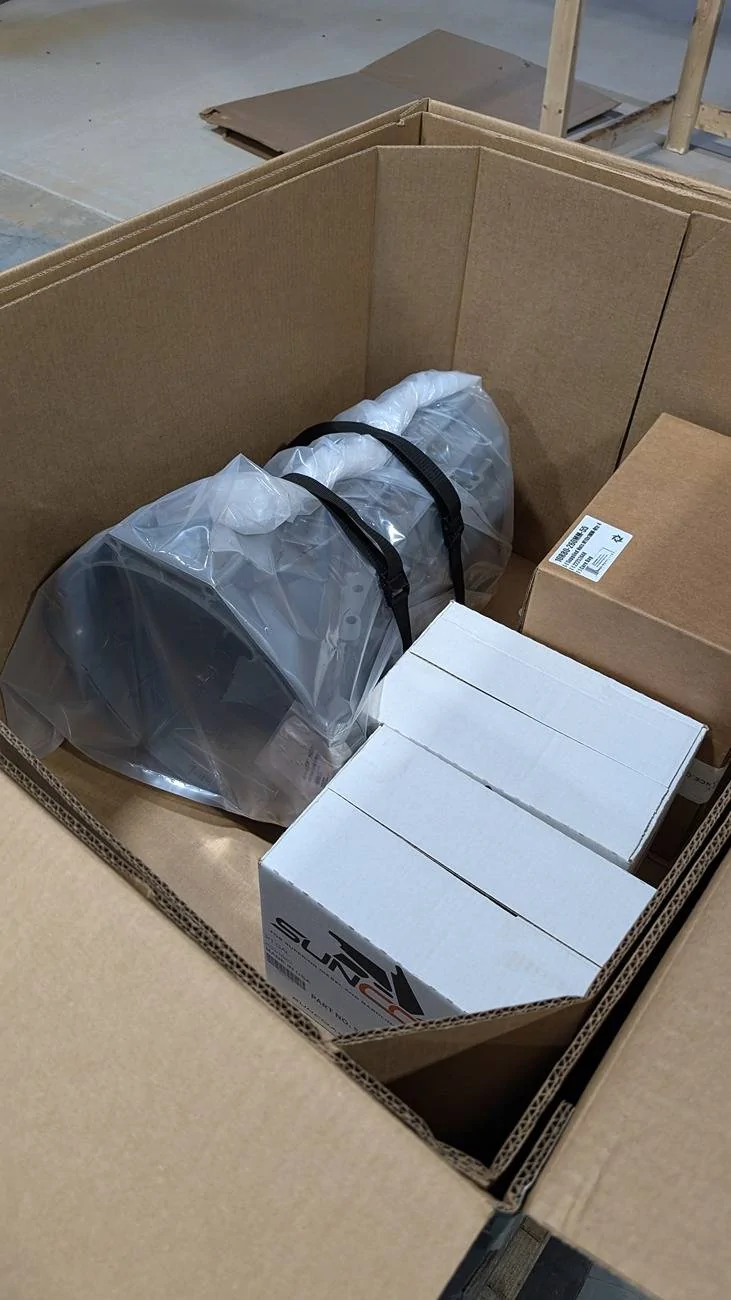

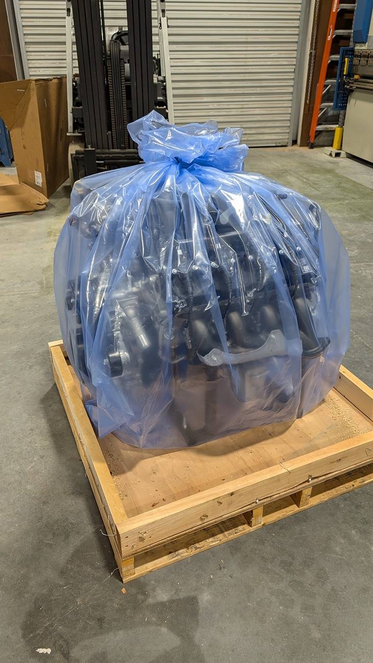

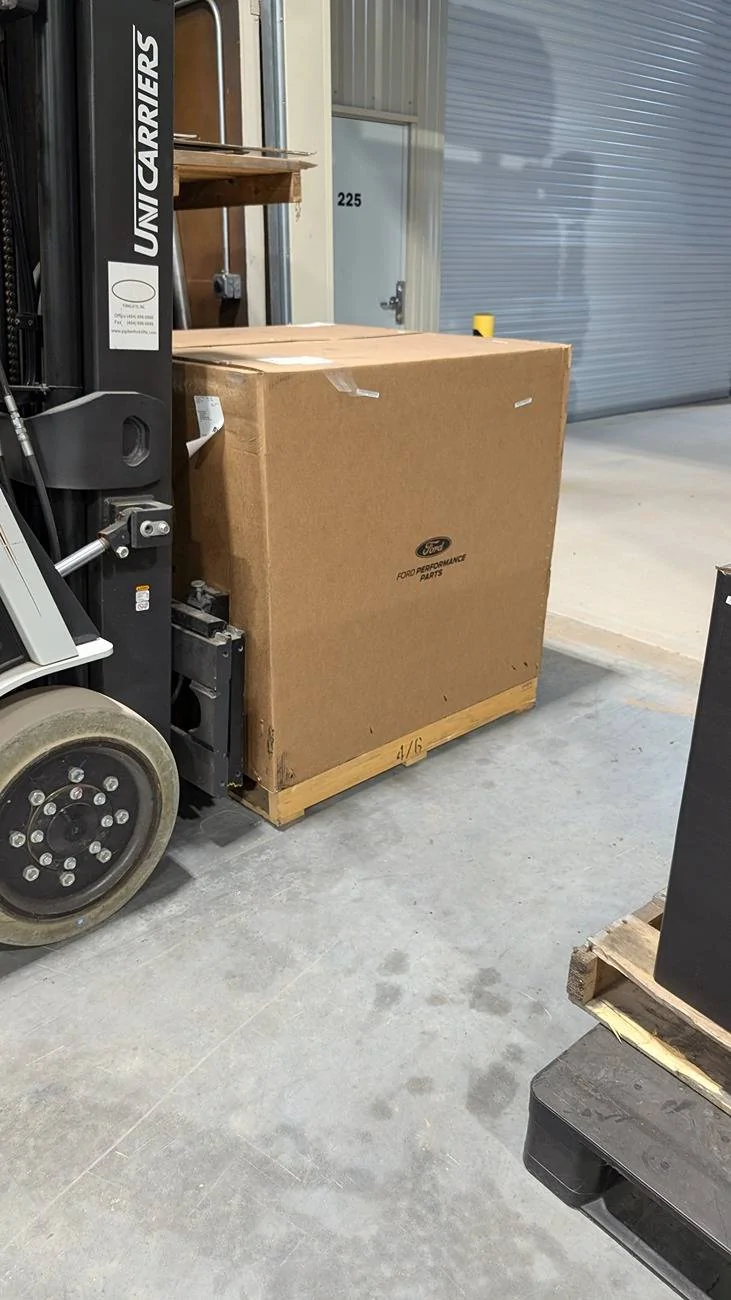

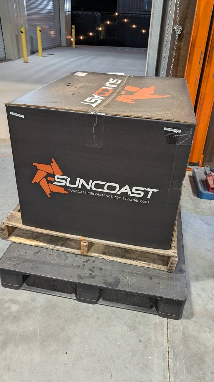

Pictures below are of the Ford Performance Godzilla crate engine and Suncoast 10R80 transmission that will be going into my Braptor.
