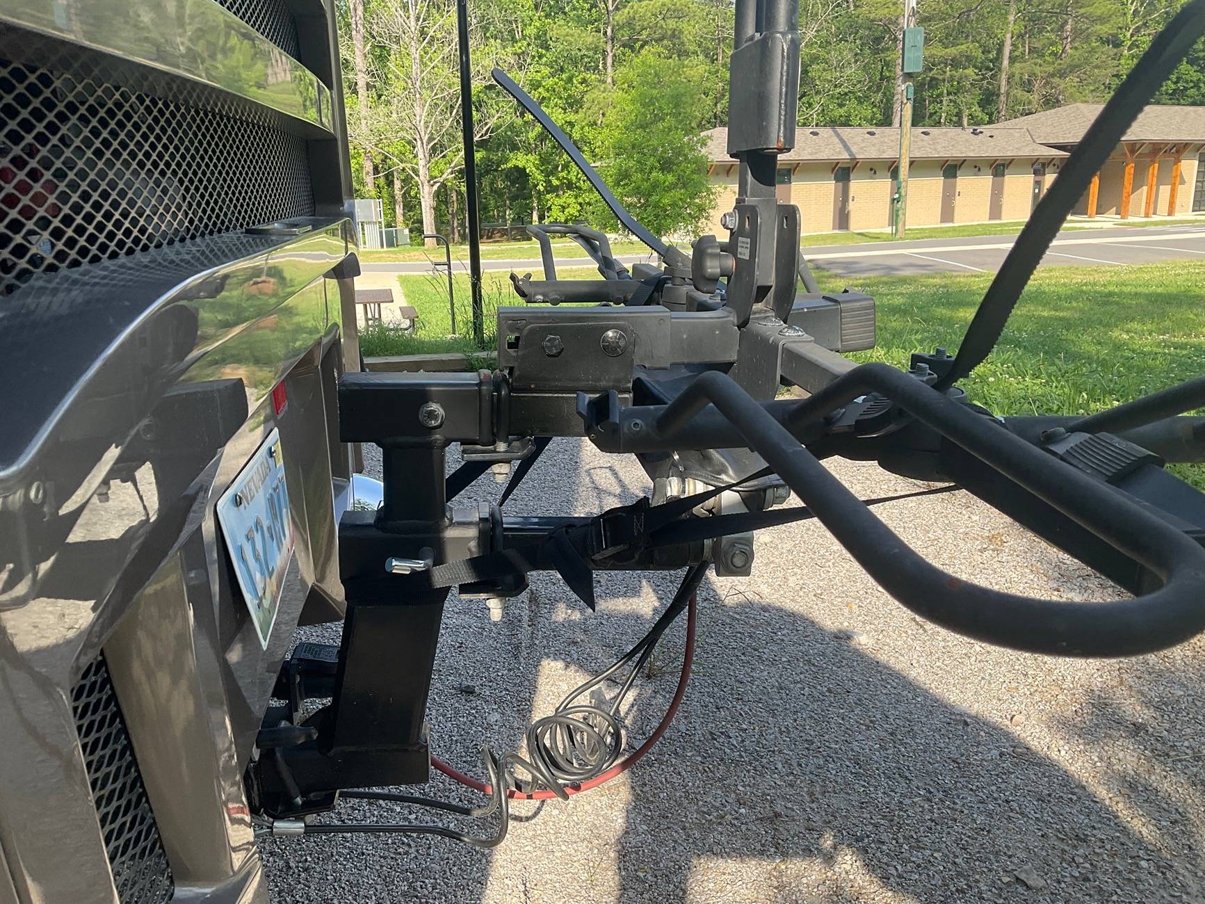

Here’s another one after seeing my old picture the admin added:
Get a stacker hitch receptacle and move the bike rack to the motorhome above the tow bar. It makes is so much easier because you don’t have to take the bike rack off the Bronco (I prefer not having to deal with bikes when parking, backing up or accessing the rear of the Bronco). This works great if you’re like us and almost always use the bikes from the campsite vs driving the Bronco to a bike trail. On the rare occasion I need to drive the Bronco to a biking area, I’ll move the rack to the Bronco.
I’ll add a picture in a while.
Here’s the picture of the stacker hitch. Because my Bronco’s bumper connection points are 29” off the ground I needed a 10” riser hitch for the tow bars. I had a welding shop that specializes in hitches weld a second receptacle 6” (center to center) above the 10” high one. I probably should’ve gone 7” so the tow bars are a little easier to stow. I really like this setup and haven’t had any issues with the bikes coming close to the Bronco even while making sharp turns.
Ford Bronco Flat Tow Tips (from 16K miles of towing behind RV) IMG_3442
