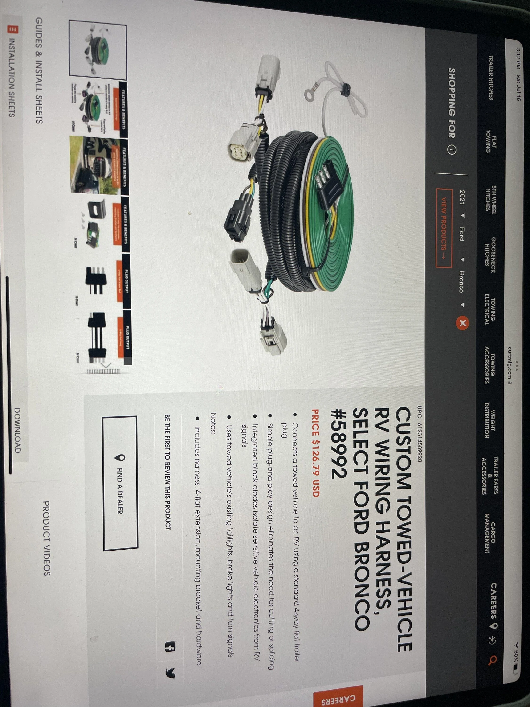

This was easy to install great instructions plus a video. If you cut the 4way plug off and run a hot and ground to a 7way plug it will charge your battery as you tow your bronco.
Ford Bronco Flat tow wiring diagram behind RV 8A0865E2-4700-476D-8EFA-C9693665F21F
Isn’t this for the non-led lights though? The led lights have a different wiring system.

I am not trying to wire up a trailer I am trying to set up the lights to work off of our super C RV. Most of these kits are for setting up trailer lights.
Yes, I think Lifeliberty is giving you the ones for trailer towing. For flat tow the numbers Curt nos are 58992 and 58996 w and w/o LED respectively.
Here's Curts site All Products for 2021 Ford Bronco (curtmfg.com)
I found 58996 at Carid for $65
I haven't bought one yet, I used the Curt kit for the trailer tow hitch and wiring but am using stand alone lights for towed for now.

This is for a 2021. Doesn’t say it’s compatible with the 22’ w/led lights.
has anyone wired in the diodes for the led lights?
